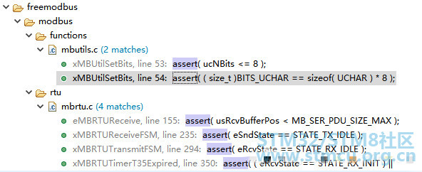

) W# e9 i  L7 V, U) B5 rRewrite assert function.
2 W- O! E7 B: R3 h- vFreemodbus use assert function to report errors in the process of communication, which was declared in assert.h:
% {- ^+ o/ D0 ?, D1 I$ q) `8 r" D! B9 f: O5 ^3 q' G4 n
( G1 B$ R1 }1 D
  1. # define assert(__e) ((__e) ? (void)0 : __assert_func (__FILE__, __LINE__, __ASSERT_FUNC, #__e))
; ?& M1 y8 l$ M
This function is may not be suitable for our own project. As a result, it is better to re-implement the error reporting function. There are 6 places that need to be modified:
% x. o. h: K1 W7 k9 x
+ q) F5 l  S. I4 q% M+ O1 h7 E$ x0 y" l; s/ r- m% H3 }
( ~" }8 |- s; ~" o
  • Change macro assertto assert_mb, such as:
    ' v. S3 v; `& w" A2 f4 d
    - V8 D2 V% y8 a. `$ B
  1. assert_mb( usRcvBufferPos < MB_SER_PDU_SIZE_MAX );
1 T! ]( c  K$ L! L
5 _: E+ k( l8 B" L& Q, `
" Y4 r9 ~. I& h5 U6 _
  • Define macro assert_mband declare function User_MbAssertFuncin mbplatform.h:% B7 [' b/ s% G: |8 k. r
  1. # define assert_mb(__e) ((__e) ? (void)0 : User_MbAssertFunc(__FILE__, __LINE__, __ASSERT_FUNC, #__e))) m+ e1 G% g1 P
  2. 6 m# X" Z1 @3 C1 C+ V
  3. extern void User_MbAssertFunc(const char *file, int line, const char *function, const char *error);
) |4 I1 F3 Q* `: d3 E  l
