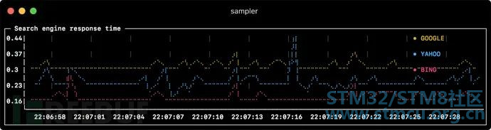

Runchart
runcharts:. u# w2 h5 R% V5 p; s0 @, u' Q' @
  - title: Search engine response time
/ E1 W1 N6 q6 `. X7 E7 G( W    rate-ms: 500        # sampling rate, default = 1000( j, |& R2 b. {* A9 g
    scale: 2            # number of digits after sample decimal point, default = 1, y. _# D4 B  O2 ?  Z$ u
    legend:
* v3 @% n" V1 G* j( R' p! j      enabled: true     # enables item labels, default = true
. I- D$ A9 q0 k( Z  `      details: false    # enables item statistics: cur/min/max/dlt values, default = true
' K# i. @3 \# o) v    items:
  x3 m( G$ D1 n7 S; w( d      - label: GOOGLE3 x* ^) w  p9 I6 e
        sample: curl -o /dev/null -s -w '%{time_total}'  https://www.google.com1 g' A3 b2 w: U+ w# X
        color: 178      # 8-bit color number, default one is chosen from a pre-defined palette
1 }+ N" x2 X' m: B      - label: YAHOO8 R3 Y) B: p* |; h( {" a
        sample: curl -o /dev/null -s -w '%{time_total}'  https://search.yahoo.com  ^! o9 q2 F% m% R* `# \
      - label: BING
8 C/ |8 T4 {4 P1 E  m1 c6 [8 q1 i        sample: curl -o /dev/null -s -w '%{time_total}'  https://www.bing.com
/ I$ {3 L/ Q4 w5 c, f

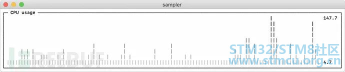

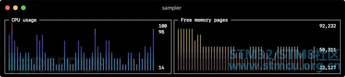

9 n4 `' [8 @" ^Sparkline
sparklines:. i3 V2 u. i0 z, N& Z* \+ M2 u9 \
  - title: CPU usage
8 @) y' w( _0 a& c! e    rate-ms: 200
, e" H6 D+ l6 Q: F    scale: 05 I" p1 P2 V1 ?
    sample: ps -A -o %cpu | awk '{s+=$1} END {print s}'4 y& K& w3 p" P9 X
  - title: Free memory pages* q6 i2 S" e% X; r* n  c2 s5 p
    rate-ms: 200. i0 A" U3 U: k* y& K
    scale: 0) B: x5 H% `9 z7 P6 M
    sample: memory_pressure | grep 'Pages free' | awk '{print $3}'

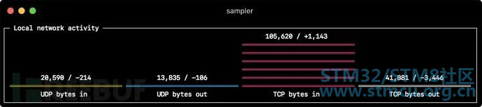

. Z1 n+ m4 a8 h4 R9 Y3 gBarchart
barcharts:
. `7 A+ _  q, i3 e0 w* Y  - title: Local network activity
5 r& Z# k+ Q0 o/ Y" t    rate-ms: 500        # sampling rate, default = 1000/ L5 I1 w1 ?3 z- K8 O5 ~3 ]" p2 D8 m
    scale: 0            # number of digits after sample decimal point, default = 1( x5 y$ m1 p* p$ f1 |' ~; K) J5 P# G
    items:$ u! ]8 ?2 ^$ Q+ g) w
      - label: UDP bytes in
# U5 Z5 ?- U) ]" \5 ^9 J1 b        sample: nettop -J bytes_in -l 1 -m udp | awk '{sum += $4} END {print sum}'3 K6 o2 \* T/ [& ~" e( L1 `
      - label: UDP bytes out
# q& r* B1 |* H0 A! P# y( R        sample: nettop -J bytes_out -l 1 -m udp | awk '{sum += $4} END {print sum}'6 v, @& T% _( ^
      - label: TCP bytes in4 R: p; ~2 u- C2 C
        sample: nettop -J bytes_in -l 1 -m tcp | awk '{sum += $4} END {print sum}'
/ `* \6 e! }* J      - label: TCP bytes out
6 A4 I! E" C0 c2 {4 C. R        sample: nettop -J bytes_out -l 1 -m tcp | awk '{sum += $4} END {print sum}'

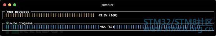

- U& p  t* d4 ?8 d3 WGauge
gauges:3 R2 ?' ^8 o; D% D
  - title: Minute progress6 z! }$ O4 v1 Y4 a2 c1 M& L
- j% }" d! Z6 [+ M/ j  a    scale: 2            # number of digits after sample decimal point, default = 10 C* C& I* |6 b, U3 m. S5 n3 g
    percent-only: false # toggle display of the current value, default = false8 g1 Q: I% r# `- T* }3 d! W" x
    color: 178          # 8-bit color number, default one is chosen from a pre-defined palette# n, p+ P6 H: H" J( @
    cur:1 R" }1 K3 c; V2 Y
      sample: date +%S  # sample script for current value0 h  q' a! j5 _4 e4 M
    max:
( n3 k* u! P  [7 o* Q      sample: echo 60   # sample script for max value) v4 h+ [# T2 M" q4 N6 _! _, _6 o
    min:
! F: S/ f- O* t2 n1 Q. W0 w7 l' J* v      sample: echo 0    # sample script for min value# n% w& j& \& \5 J; `. A
  - title: Year progress) ~  D4 F- x8 I' V. b% V' d$ o, o
    cur:3 I) O2 z) i# o  Z2 ^
      sample: date +%j, c, x/ `9 i- x/ `3 @
    max:
; ^. e, z  K+ x( W3 ]      sample: echo 365# Z3 k6 a/ j+ e7 _2 o' v) ~. N
    min:
+ z% f" r' S8 g' w( v      sample: echo 0

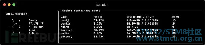

Textbox
textboxes:
: |/ |6 H* |* s  - title: Local weather
' W# ]3 x. p' P% q& Y6 I6 I, r    rate-ms: 10000      # sampling rate, default = 10008 ^0 `5 y, _/ {2 }& _- n) A
    sample: curl wttr.in?0ATQF# A# D$ G7 [' l3 J
    border: false       # border around the item, default = true
6 w3 T1 n' a+ H- F& `0 ]    color: 178          # 8-bit color number, default is white0 t1 s) t+ H6 T
  - title: Docker containers stats
9 [( Z3 T7 G; \* g! [    rate-ms: 500
* p, y' U( A7 e& L    sample: docker stats --no-stream --format "table {{.Name}}\t{{.CPUPerc}}\t{{.MemUsage}}\t{{.PIDs}}"
4 o* C9 R! w5 m* O  |2 a8 ]
( L. b/ M1 g' Q! ~8 ]: @& R
6 m* F) }$ T7 u6 t6 ^

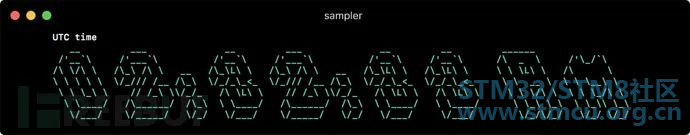

Asciibox
asciiboxes:1 l: Y# v8 Q7 m" ]; {2 y. r+ F
  - title: UTC time
5 k$ @8 i2 q# p) v' r$ ?    rate-ms: 500        # sampling rate, default = 1000
  u9 _* Z/ a8 b0 Q3 F" K3 q    font: 3d            # font type, default = 2d
  ~8 C. |( b' S    border: false       # border around the item, default = true
+ E3 U- `! j  }- H1 d/ j    color: 43           # 8-bit color number, default is white% ^# Q1 ~  `. P( u5 T
    sample: env TZ=UTC date +%r
0 m/ G, y- x) m) A# v

5 E( {. U  T$ P" n) U) ^9 ysparklines:
& W$ k2 y' l. z! e  - title: CPU usage
3 R0 }* K0 S* z. b( E+ |2 ^1 P0 ^$ u    sample: ps -A -o %cpu | awk '{s+=$1} END {print s}'

2 P$ N2 \5 [! g. y& ^; xruncharts:" N# m1 b3 T" e8 h/ g8 ?+ u
  - title: Kafka lag per consumer group
/ J: z5 u; _2 E+ f8 l    rate-ms: 50008 [) e( T/ a8 U
    scale: 0
6 k" B7 c1 M5 f; ]: k) o    items:) r, K% k# c  U2 x. P0 n
      - label: A->B
" \# F3 y; `% H1 P        sample: $kafka_connection --group group_a --describe | awk 'NR>1 {sum += $5} END {print sum}'
0 e& j1 y( [' n0 S+ D1 H      - label: B->C; k2 r1 N& Z. h/ S
        sample: $kafka_connection --group group_b --describe | awk 'NR>1 {sum += $5} END {print sum}'9 |0 f3 K) J: M. {0 `% t
      - label: C->D$ `6 J3 m4 E$ t" U3 j
        sample: $kafka_connection --group group_c --describe | awk 'NR>1 {sum += $5} END {print sum}'

Docker
Docker容器统计信息(CPU,MEM,O/I)
textboxes:
- N% s( z: @8 k7 w9 \. f2 A7 l  - title: Docker containers stats
& J/ {. |. [5 r% f9 H' o    sample: docker stats --no-stream --format "table {{.Name}}\t{{.CPUPerc}}\t{{.MemPerc}}\t{{.MemUsage}}\t{{.NetIO}}\t{{.BlockIO}}\t{{.PIDs}}"
