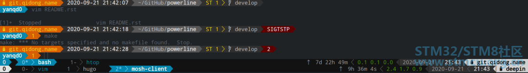

微信图片_20201127191319.png Powerline in Bash (and tmux)
