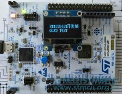

实现下图显示效果的主程序为:
  1. int main(void)
    ) ]- k3 l! p, z* p
  2. {
    5 X8 e: c- x5 z
  3. HAL_Init();
    7 a5 {# T# \' l/ V: s, A! M  Z
  4. SystemClock_Config();( c, p1 g7 h# y( {+ s. M& }9 }
  5. GPIO_OLED_INIT();) Y" D) c/ M* s
  6. OLED_Init();
    ) e- c% B: B; A+ ^/ X7 e
  7. OLED_Clear();
    - @7 g# ~; c8 [9 c! r0 b- M. m
  8. OLED_ShowString(10,2,"STM32G431",16);" |5 p, p7 {7 n+ s5 K* X
  9. OLED_ShowString(10,4,"OLED TEST",16);
    3 j/ l$ G7 Q9 n% ]2 B
  10. OLED_ShowCHinese(79,2,9);, E+ G, y2 p& k
  11. OLED_ShowCHinese(95,2,10);
    ! g8 j+ f; B8 ~6 |9 X% T# i
  12. OLED_ShowCHinese(111,2,11);1 V3 A9 @; x" o' y6 J" v
  13. while (1);# W7 d9 q6 F0 D/ b" s3 M* @3 ]
  14. }
# N2 E# v, E. X  Y) b( `$ P; M, J& U, @
) i1 D: v6 T" S# v7 A6 x
OLED屏显示效果
