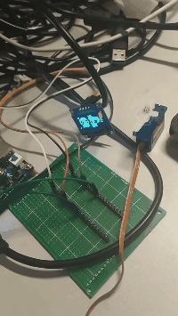

- l! Y/ Q; O0 C  V- O0 @# Q下面是自己做的一个小实训,包括oled显示,按键控制舵机等基本外设操作,逻辑层较为简单。演示如下) V  b! S, K8 W
  v9 k6 \  P5 M7 Q3 s" u2 l
8 }& |  r2 y; b$ P9 |+ w5 @. e7 r
( ^! E. H* `- c6 W, Q$ o
& |* e! X5 p5 Y5 B( f- G. K4 O  f- E0 ~% h. \
. ?/ l- L" I  y* d+ c5 I: B) s
& Q+ W$ W9 ?! P3 ?% ^
3 d+ O% H: K+ w7 f( h$ r3 _0 [0 y/ T2 L+ s" f1 J! n

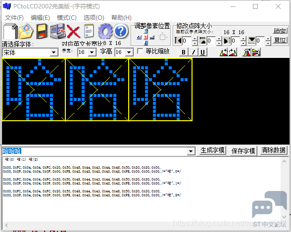

! k4 {) d! i+ l1 n9 N. lOLED
" v$ E; f2 l: r7 OOLED配置
+ J" i8 f: l0 q+ f; A/ a& \+ W可以参考STM32F103 OLED显示实验,了解具体的oled实现机理。

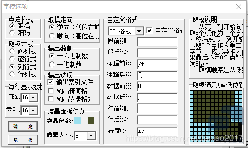

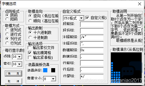

4 G& x- U# Z+ g$ G$ t由于所写驱动不同,扫描方式不同!!!所以在用PCtoLCD2002bmp转数组的配置也不一样。$ H' d% T0 `6 n2 _3 o
# O2 y( s  M7 B  ~; A汉字配置/ P8 y9 [8 u( A
PCtoLCD2002软件配置如下:
9 v2 S; o# L. \: g# x3 P- ~建议将输出选项勾上' h3 q2 v; c! u& Q( m
, X3 l, C- `6 C/ `8 i
( u5 p* d2 _2 H9 l8 `7 p2 a& f6 V0 N4 ?& H
1 T( h5 i( ~3 r; Z6 y. x
, a: @5 C* C( o8 {
5 c2 z; }1 \/ z; x8 h
关键代码
7 G" t. P* |) G. d
  1. OLED_ShowPicture(0,0,16,48,BMP5,1);! u! O* \) a; x0 v* @- B
  2. unsigned char BMP5[] =  R6 F0 G. A* S0 [9 i: E
  3. {0x00,0xFC,0x04,0x04,0xFC,0x20,0x50,0x48,0x44,0x43,0x44,0x48,0x50,0x20,0x20,0x00,
    & J' X! x1 y, v* e; A; W
  4. 0x00,0x0F,0x04,0x04,0x0F,0x00,0xFE,0x42,0x42,0x42,0x42,0x42,0xFE,0x00,0x00,0x00,/*"哈",0*/$ g  a1 J( t8 B# ?
  5. 6 C; M  R1 h% ^4 E3 h' _  S1 ^
  6. 0x00,0xFC,0x04,0x04,0xFC,0x20,0x50,0x48,0x44,0x43,0x44,0x48,0x50,0x20,0x20,0x00,! w- v, w& ~# _; E8 z3 E
  7. 0x00,0x0F,0x04,0x04,0x0F,0x00,0xFE,0x42,0x42,0x42,0x42,0x42,0xFE,0x00,0x00,0x00,/*"哈",1*/  S2 K% H7 J& t9 B* _2 L0 K
  8. ! h/ c( X) L" _  S% _8 d
  9. 0x00,0xFC,0x04,0x04,0xFC,0x20,0x50,0x48,0x44,0x43,0x44,0x48,0x50,0x20,0x20,0x00," s: i) }' s& _; J* G1 d
  10. 0x00,0x0F,0x04,0x04,0x0F,0x00,0xFE,0x42,0x42,0x42,0x42,0x42,0xFE,0x00,0x00,0x00,};/*"哈",2*/
$ h; t& y9 p) ~

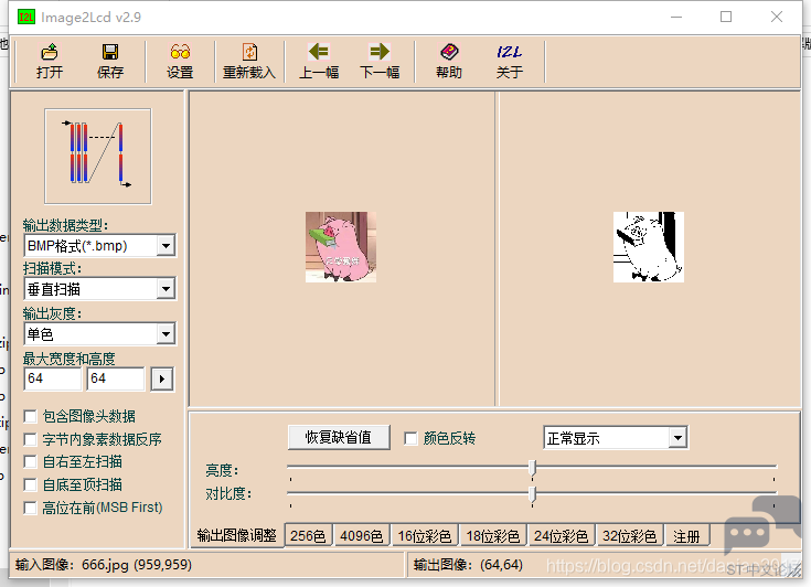

图片配置  A# d( P: i3 ]8 R
使用Image2Lcd 2.9将图片转为BMP格式
' @$ f& u3 U  B% H
# c7 Q8 [% {5 ~, G( `# q& R% f% U
$ y9 D& V1 e& V" \6 m* [
" n; F1 c! Y* M% u) E+ o: M' F7 Y
5 i. ^( |, H! I6 X8 }+ d% v: D$ L
3 t: a( ^! e! j$ }" O
关键代码
2 I0 z0 h9 T; I
  1. OLED_ShowPicture(0,0,64,64,BMP5,1);* H4 p# Q7 S$ D" v" l
