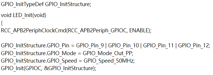

  15. & |" D* l$ b2 U" r+ {9 o% d' \/ v
  16. void LED_Init(void)% v! R- X  K9 X, V# L
  17. {+ t0 {6 m/ k" ^$ A, e7 z" Z
  18. RCC_APB2PeriphClockCmd(RCC_APB2Periph_GPIOC, ENABLE);
    % ?4 A4 S* I9 T8 M0 Z: }( G& Q
  19. 7 d3 t. C' }! a7 N1 n' F5 G& v
  20. GPIO_InitStructure.GPIO_Pin = GPIO_Pin_9 | GPIO_Pin_10 | GPIO_Pin_11 | GPIO_Pin_12;1 i' d9 i" r! x! L$ c
  21. GPIO_InitStructure.GPIO_Mode = GPIO_Mode_Out_PP;
    " ^7 B- P& k# Z4 z
  22. GPIO_InitStructure.GPIO_Speed = GPIO_Speed_50MHz;1 o8 U' {. W% A8 \9 U2 N
  23. GPIO_Init(GPIOC, &GPIO_InitStructure);
    # G: p3 j( _& y# M- C
  24. ! h8 ]/ ^1 {! ~! Q+ j$ N4 e0 d" ^9 {
