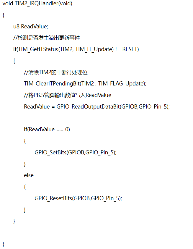

在stm32f10x_it.c中,我们找到函数TIM2_IRQHandler(),并向其中添加代码
void TIM2_IRQHandler(void)
       u8 ReadValue;
       //检测是否发生溢出更新事件
       if(TIM_GetITStatus(TIM2, TIM_IT_Update) != RESET)
              //清除TIM2的中断待处理位
              TIM_ClearITPendingBit(TIM2 , TIM_FLAG_Update);
              //将PB.5管脚输出数值写入ReadValue
              ReadValue = GPIO_ReadOutputDataBit(GPIOB,GPIO_Pin_5);
              if(ReadValue == 0)
                     GPIO_SetBits(GPIOB,GPIO_Pin_5);
              else
                     GPIO_ResetBits(GPIOB,GPIO_Pin_5);
