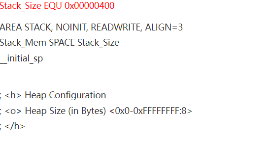

先看启动文件startup_stm32f10x_md.s的定义:
; Amount of memory (in bytes) allocated for Stack
# S& Y( T/ y1 F. H; Tailor this value to your application needs
' e: j! @9 |( [- T7 Z) |5 m7 R5 v; <h> Stack Configuration. C$ l2 s" j9 F3 N7 p
; <o> Stack Size (in Bytes) <0x0-0xFFFFFFFF:8>9 k! @) Z6 _( z' w8 a4 [' o
; </h>
Stack_Size EQU 0x00000400
AREA STACK, NOINIT, READWRITE, ALIGN=3$ |( Z9 |+ x2 M/ g: U) J
Stack_Mem SPACE Stack_Size# V: D% H7 B$ j6 {
__initial_sp
4 }5 G( g$ \/ X) D4 A9 R7 E0 y% m; <h> Heap Configuration
* H7 e& P' m, ~5 D& @! h$ K; <o> Heap Size (in Bytes) <0x0-0xFFFFFFFF:8>1 F3 o5 q* A3 ^
; </h>
Heap_Size EQU 0x00000200
AREA HEAP, NOINIT, READWRITE, ALIGN=35 u& L( U: {; Q5 o
__heap_base
, b7 m# P& [  K2 HHeap_Mem SPACE Heap_Size6 J: h9 D% Y& ^6 C( A$ k* H6 m. r
__heap_limit
PRESERVE8, O" |3 u# L4 X! d" m
THUMB
这里定义了堆栈各自大小,堆:512bytes 栈1k;
所以栈区大小有限制,我们在局部变量中不要定义大数组否则容易溢出。
