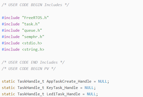

  1. /* USER CODE BEGIN Includes */5 A5 j  S! ]; D$ k$ W, W
  2. 0 [0 F8 e) G- H
  3. #include "FreeRTOS.h"+ C* P8 h$ I; a
  4. #include "task.h"
    0 f4 d- u6 V' ^' o0 O; N  J$ W9 @0 _
  5. #include "queue.h"' f7 O& {8 K' Z
  6. #include "semphr.h"
    9 z9 R% g# ]/ M, c# x6 ?
  7. #include <stdio.h>
    % z. X1 A9 X# z/ }) G$ U1 ?4 \
  8. #include <string.h>+ m% b% ]' m! z8 g, \: a3 C+ j
  9. 1 H$ |6 R( q1 }( c2 L
  10. /* USER CODE END Includes */( O( g0 H* E8 E$ \% C1 b4 b
  11. /* USER CODE BEGIN PV */
    0 {6 P" U# j6 C" \1 d( Q6 c- H) }2 C
  12. ) I, o. |# ~* T% S
  13. static TaskHandle_t AppTaskCreate_Handle = NULL;
    . ^% X" q: ]* m* e* d, K8 h
  14. static TaskHandle_t KeyTask_Handle = NULL;
    1 H; Q# n! W/ S  R- W9 ]
  15. static TaskHandle_t Led1Task_Handle = NULL;2 O) [4 }1 g' }
  16. * Y+ S. d; |. ]8 V: ~& U
  17. /*Create a binary semaphore handle*/2 K" N: a4 p& k7 z
  18. static SemaphoreHandle_t Binary_Handle = NULL;1 {" c' r' v0 M2 l
  19. " I( Q. \- g. [: h3 A+ k9 {
