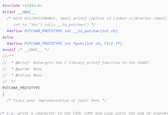

2.重定向printf到串口,在usart.c中添加代码
( g. o1 Q( d7 H: b1 O; S, g" I0 ^9 m( t/ S" L+ u( s
- /* USER CODE BEGIN 0 */% w9 W. v' M& @3 {# N+ L
- & h) l9 _7 z8 i7 q3 w8 d
- #include <stdio.h>
, [% E# H: T' x) v! q% { - #ifdef __GNUC__
& _& c' ]8 ^/ n3 N9 ?8 W - /* With GCC/RAISONANCE, small printf (option LD Linker->Libraries->Small printf
. C+ A. b7 z% I- \$ p% ~7 j* k* \ - set to 'Yes') calls __io_putchar() */& B* ~: D: P0 e
- #define PUTCHAR_PROTOTYPE int __io_putchar(int ch)2 i$ P z: N) P2 ]
- #else" M( r" _1 B G7 U$ K
- #define PUTCHAR_PROTOTYPE int fputc(int ch, FILE *f): M& l0 D1 i H
- #endif /* __GNUC__ */0 e" G9 u# B: Q, ?7 n* [
* Z' R: B7 j* E* a% a( Z$ J - // * @brief Retargets the C library printf function to the USART.
, ?4 M% _/ f6 D# M4 L - // * @param None* z/ w9 Q, P4 B! T' Y' M2 V
- // * @retval None
/ d/ I8 Z. T5 T( W - // */
/ i2 D! p7 n* y, z* i - PUTCHAR_PROTOTYPE
, n+ J2 Q, U, ^3 m - {8 c6 L: h$ A6 x
- /* Place your implementation of fputc here */
% _6 G8 I; b3 |( M, y+ s8 O - /* e.g. write a character to the EVAL_COM1 and Loop until the end of transmission */
+ q5 `: [' \1 d n& [* e* c- U% A - HAL_UART_Transmit(&huart1, (uint8_t *)&ch, 1, 0xFFFF);' A( N$ U Z x) Y* _3 Q0 B3 K
- 6 ]9 [$ m% V2 r) \7 s& b
- return ch;7 q G4 M# K& l" d0 m, s% ^
7 A, I- z! i+ u+ j/ h
7 i% p$ B: Z. m6 L% ]6 T- /* USER CODE END 0 */
