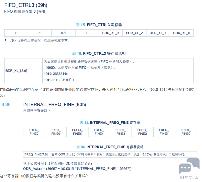

然后另外一个问题,再iis3dwb的驱动中:
int32_t iis3dwb_xl_data_rate_set(const stmdev_ctx_t *ctx,
                         iis3dwb_odr_xl_t val)
iis3dwb_ctrl1_xl_t ctrl1_xl;
int32_t ret = iis3dwb_read_reg(ctx, IIS3DWB_CTRL1_XL, (uint8_t *)&ctrl1_xl, 1);
if (ret == 0)
ctrl1_xl.xl_en = (uint8_t)val;
ret = iis3dwb_write_reg(ctx, IIS3DWB_CTRL1_XL,
return ret;
