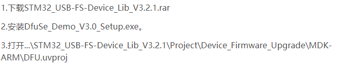

1.下载STM32_USB-FS-Device_Lib_V3.2.1.rar
2.安装DfuSe_Demo_V3.0_Setup.exe。
3.打开...\STM32_USB-FS-Device_Lib_V3.2.1\Project\Device_Firmware_Upgrade\MDK-ARM\DFU.uvproj
