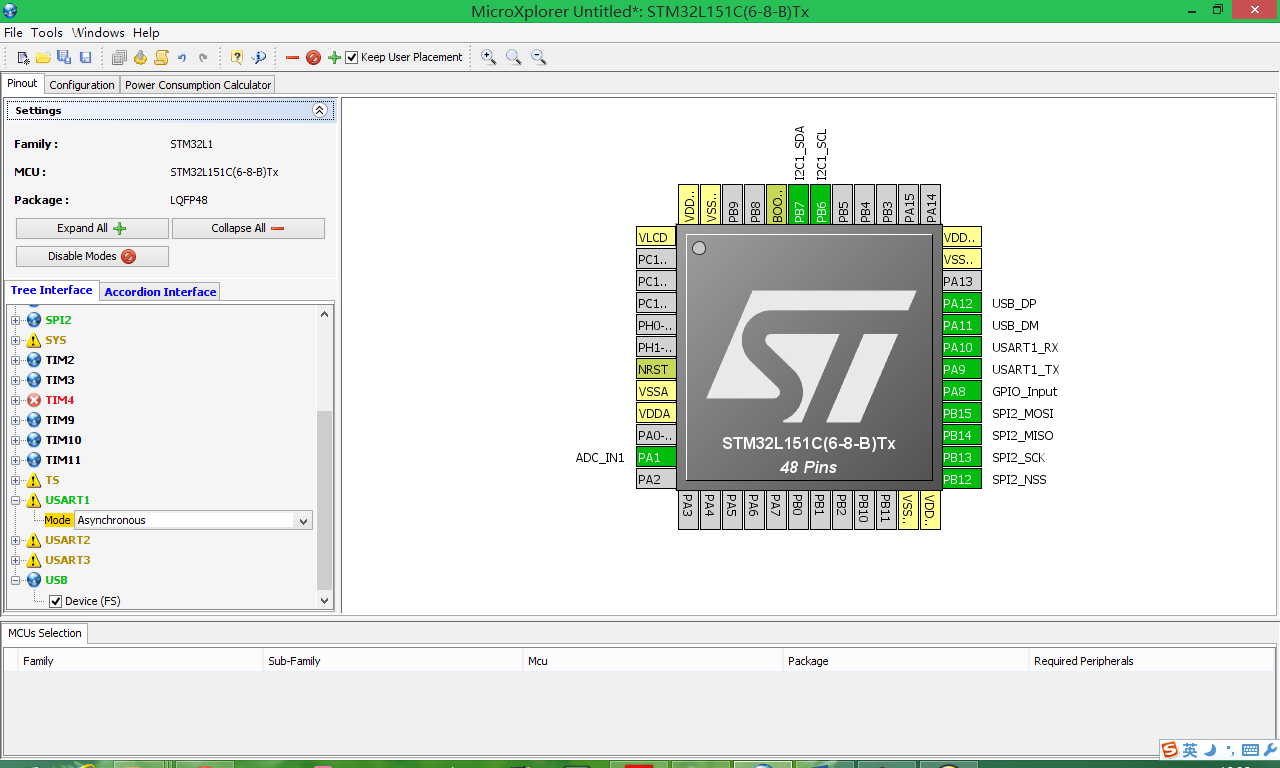

感谢楼主,下载成功,安装提示缺少,Java Runtime Environment,然后我安装了Java,然后进入安装,自动选择安装目录,安装一阵,最后提醒, javaw.exe not found ,reinstall java jre;实际上,我的电脑里搜索,有javaw.exe 。因此,MicroXplorer无法安装,困惑。

这样就可以了,在安装目录了里会有一个.jar文件,双击打开即可
RE:ST公司出品【图形化配置工具】

#include "mx_gpio.h"
/* USER CODE BEGIN 0 */
/* USER CODE END 0 */
3 h7 J0 h" A" E6 c9 {; `. t
/* Configure GPIO */
/*----------------------------------------------------------------------------*/ u8 X% r- A2 w0 e. G2 f
/* USER CODE BEGIN 1 */ ^% w. n6 P+ i- \- Q5 u# ~* L
/* USER CODE END 1 */
, @" G2 C* V5 F k, U
void mx_pinout_config(void) {
/* Private typedef ---------------------------------------------------------*// \$ o R4 d; D& _1 l# d$ z
GPIO_InitTypeDef GPIO_InitStruct;
0 c G+ e2 |" P- \
* ^* g) ^- J2 ^2 P8 Q0 n+ \
/** ADC GPIO Configuration % p) r& L5 ~6 T2 _
PA1 ------> ADC_IN1
( y' d3 R8 K* t( T& k0 k* o
/*Enable or disable the AHB peripheral clock */, f: e6 `: U' R) Z e; f! V
RCC_AHBPeriphClockCmd(RCC_AHBPeriph_GPIOA, ENABLE);
/*Configure GPIO pin */
GPIO_InitStruct.GPIO_Pin = GPIO_Pin_1;5 a0 V8 b; N$ b# x9 I2 w# y# c @
GPIO_InitStruct.GPIO_Mode = GPIO_Mode_AN;
GPIO_InitStruct.GPIO_PuPd = GPIO_PuPd_NOPULL;
GPIO_Init(GPIOA, &GPIO_InitStruct);$ t% h' ?# s% A' m7 I& b
" P0 ~, C6 E9 [4 Y& v3 W/ M
/** I2C1 GPIO Configuration
PB6 ------> I2C1_SCL1 d. |' J- d! O r4 _! v
PB7 ------> I2C1_SDA1 X8 C4 w* V: Y8 q! q
*/8 c, w* g8 L& c: v5 y/ a
! f' m) J1 A* P, |7 i& \) I
% t% k) D$ @9 v: e o& Y6 F1 j
/*Enable or disable the AHB peripheral clock */4 v- k4 G" u& L0 `! } [
RCC_AHBPeriphClockCmd(RCC_AHBPeriph_GPIOB, ENABLE);
- A8 @7 _- i t
//!!! GPIO_Init is commented because some parameters are missing1 x; E( u! ~# a6 o9 L
GPIO_InitStruct.GPIO_Pin = GPIO_Pin_6;! D5 ]) I( X- {2 s1 V* M o
GPIO_InitStruct.GPIO_Mode = ;
GPIO_InitStruct.GPIO_OType = GPIO_OType_PP;0 {8 d2 L5 G D, q/ O0 C
GPIO_InitStruct.GPIO_PuPd = GPIO_PuPd_NOPULL;1 L( X* v. {* q3 \( T9 E2 [; Z8 M
GPIO_InitStruct.GPIO_Speed = GPIO_Speed_400KHz;
GPIO_Init(GPIOB, &GPIO_InitStruct);
+ U2 |+ m* t- I1 g; D3 d! n. P
1 v& Y0 u) N( r: f+ ]
//!!! GPIO_Init is commented because some parameters are missing. t* [1 d4 P* ` w% P( n
GPIO_InitStruct.GPIO_Pin = GPIO_Pin_7;* L, F' c( ?5 s$ |' k3 \0 j
GPIO_InitStruct.GPIO_Mode = ;0 V) A# `/ n$ ]# o# s) ?0 E9 k0 H7 ]
GPIO_InitStruct.GPIO_PuPd = GPIO_PuPd_NOPULL;2 Y2 z$ ~; `$ d: @8 k% {
/*Configure GPIO pin alternate function */2 @/ S. ~' \' ~+ h w
GPIO_PinAFConfig(GPIOB, GPIO_PinSource6, GPIO_AF_I2C1);% H) k7 ]8 H8 W. F) M/ k
GPIO_PinAFConfig(GPIOB, GPIO_PinSource7, GPIO_AF_I2C1);8 K; [1 J" M2 C) f1 {
% I d& F; P" [7 q) [, P
/** SPI2 GPIO Configuration 7 F4 P/ C- W. f, q, ^
PB12 ------> SPI2_NSS
PB13 ------> SPI2_SCK. j$ V. G1 L. ^- U+ x$ a
PB14 ------> SPI2_MISO3 C0 E9 S5 r% O: b" K
PB15 ------> SPI2_MOSI+ I( P* q/ `, k* Z6 l, {9 l
*/' U+ p2 a2 \" q, G$ I' W/ Q
6 F- y6 a. d- B& K* g' \7 z
. \, D" T7 A/ n" l1 Z/ A( k" B G& t
/*Enable or disable the AHB peripheral clock *// n% A$ O- k: X2 M/ U* }) C8 q
RCC_AHBPeriphClockCmd(RCC_AHBPeriph_GPIOB, ENABLE);0 ]9 Z) I8 R1 x1 I4 S# Y
* ~) m% Y% Z# E& y# |; [. F
//!!! GPIO_Init is commented because some parameters are missing" B7 S& G! r% h( T. G3 b
GPIO_InitStruct.GPIO_Pin = GPIO_Pin_12;
GPIO_InitStruct.GPIO_Mode = ;3 F4 ^9 q8 J: B) b% c
GPIO_InitStruct.GPIO_OType = GPIO_OType_PP;3 Z2 ~1 e! ~3 d4 @2 v
GPIO_InitStruct.GPIO_PuPd = GPIO_PuPd_NOPULL;1 E A$ h& s% N9 ?" J0 s2 D
GPIO_Init(GPIOB, &GPIO_InitStruct);% [% `. [5 r8 T# X
; W5 [" j& w5 B7 O. s" n. z
//!!! GPIO_Init is commented because some parameters are missing. t y/ _" \; B# D1 C6 [$ j
GPIO_InitStruct.GPIO_Pin = GPIO_Pin_13;
GPIO_InitStruct.GPIO_Mode = ;) _6 u' j7 r a. Y7 q2 @
GPIO_InitStruct.GPIO_PuPd = GPIO_PuPd_NOPULL;9 P' p, y" _4 T
GPIO_InitStruct.GPIO_Speed = GPIO_Speed_400KHz;* V, n8 G/ Q2 p
5 R5 X2 A+ A* ^/ O; r- I' T
GPIO_InitStruct.GPIO_Pin = GPIO_Pin_14;/ ^& `6 d; b. y$ P k( A
GPIO_InitStruct.GPIO_Mode = ;' @/ M- y; q8 V: I! j
GPIO_InitStruct.GPIO_OType = GPIO_OType_PP;/ W7 F9 T, b1 `& ~
GPIO_Init(GPIOB, &GPIO_InitStruct);* v, b' B0 X$ j( W
GPIO_InitStruct.GPIO_Pin = GPIO_Pin_15;
GPIO_InitStruct.GPIO_Mode = ;) i- g, d! F1 c( o ~
GPIO_InitStruct.GPIO_PuPd = GPIO_PuPd_NOPULL;; e7 Y8 J, w& e% W- f0 J0 k
/*Configure GPIO pin alternate function */' i/ V$ ?& M% T# D$ w
GPIO_PinAFConfig(GPIOB, GPIO_PinSource12, GPIO_AF_SPI2);
GPIO_PinAFConfig(GPIOB, GPIO_PinSource13, GPIO_AF_SPI2);9 L3 B" d- Z x2 b L
p1 S! N' F) D
/*Configure GPIO pin alternate function */% o' f; c4 i+ {$ @
GPIO_PinAFConfig(GPIOB, GPIO_PinSource14, GPIO_AF_SPI2);# G/ F( B d6 K
/*Configure GPIO pin alternate function */0 D: a4 w4 v7 w/ _9 g; J, E+ u
GPIO_PinAFConfig(GPIOB, GPIO_PinSource15, GPIO_AF_SPI2);, y& O/ p/ s k1 k6 }. W: Z
1 g/ W: X% O9 \! p
/** USART1 GPIO Configuration
PA9 ------> USART1_TX2 w% l% b8 y( Y- D% `/ i, z
PA10 ------> USART1_RX- K+ l7 N1 R# R) T( _
+ I# y- J/ ~8 |5 C; F& t6 I# Z
$ h$ T& P* j0 t; {% c7 [
//!!! GPIO_Init is commented because some parameters are missing- P6 u$ ], M* R) O% I$ p
GPIO_InitStruct.GPIO_Pin = GPIO_Pin_9;" O! h+ h* H& y5 k) R# B! M
GPIO_InitStruct.GPIO_Mode = ;8 P' E. M6 c# p
GPIO_InitStruct.GPIO_OType = GPIO_OType_PP;' S% Q$ ?+ ~, ]( z
1 c* @' A) [& p4 O3 A a7 F
//!!! GPIO_Init is commented because some parameters are missing7 q# |. x O5 A% {! k
GPIO_InitStruct.GPIO_Pin = GPIO_Pin_10;: p* k+ p4 |/ c" R; x& [2 v9 D
GPIO_InitStruct.GPIO_Mode = ;- W8 P9 o6 Z2 S5 b3 ~2 ~7 Y* n
GPIO_InitStruct.GPIO_PuPd = GPIO_PuPd_NOPULL;' ]! {9 M. z: I) \# |
/*Configure GPIO pin alternate function */6 f. C: @$ J5 R% Y ?
GPIO_PinAFConfig(GPIOA, GPIO_PinSource9, GPIO_AF_USART1);8 ]% L9 [% k9 _; W2 [3 q
" l' ^6 q- Y6 L4 B, ^
GPIO_PinAFConfig(GPIOA, GPIO_PinSource10, GPIO_AF_USART1);" b) E& w+ U; H& \1 m
: {, Z7 `- r. J/ ^9 V4 b
% k$ {, q- i6 E! a" [9 u" b" v
/** USB GPIO Configuration - h0 Q! _( t. _
PA11 ------> USB_DM
PA12 ------> USB_DP
*/$ G5 j$ [7 l* i) P# O- `- Y
: ]- z: u5 n1 K' k2 d3 v
/*Enable or disable the AHB peripheral clock */2 z! }' d7 r+ ?0 _. x) g
RCC_AHBPeriphClockCmd(RCC_AHBPeriph_GPIOA, ENABLE);" d$ \4 ^7 Z1 f+ |: Q
GPIO_InitStruct.GPIO_Pin = GPIO_Pin_11;2 q* ]% {3 q: e p: a
GPIO_InitStruct.GPIO_Mode = ;( Z- |7 k9 }: C' L
GPIO_InitStruct.GPIO_OType = GPIO_OType_PP;* Z- x, K% p6 o& E5 K
GPIO_Init(GPIOA, &GPIO_InitStruct);" V/ e6 {* L) J, S
GPIO_InitStruct.GPIO_Pin = GPIO_Pin_12; d0 D; X3 ?% [ z8 @! w
GPIO_InitStruct.GPIO_Mode = ;7 q" M6 b7 o1 D; U
GPIO_InitStruct.GPIO_OType = GPIO_OType_PP;/ P$ y4 x+ ]4 B2 J
GPIO_InitStruct.GPIO_PuPd = GPIO_PuPd_NOPULL;* P0 c9 {, Q5 W2 c
GPIO_Init(GPIOA, &GPIO_InitStruct);5 _) o! O$ v' i5 K! b
/** Configure pins as GPIO; _+ @4 ~& z, a! g+ {
PA8 ------> GPIO_Input* L s" d/ E* k# V
*/8 o# V" E! M3 K3 C, N( j, [
) q i; w0 W( I3 }+ y
GPIO_InitStruct.GPIO_Pin = GPIO_Pin_8;
GPIO_InitStruct.GPIO_Mode = GPIO_Mode_IN;3 T. v! z5 |# w
GPIO_Init(GPIOA, &GPIO_InitStruct);( B( R: Q5 F/ w# q: B0 ?: o" b" \
}. N" ?" e* X8 f6 U0 {3 u. } N
/ r/ b6 M& h2 }8 m8 V* Z
/* USER CODE BEGIN 2 */
/* USER CODE END 2 */
