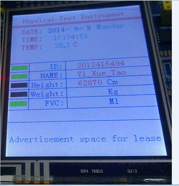

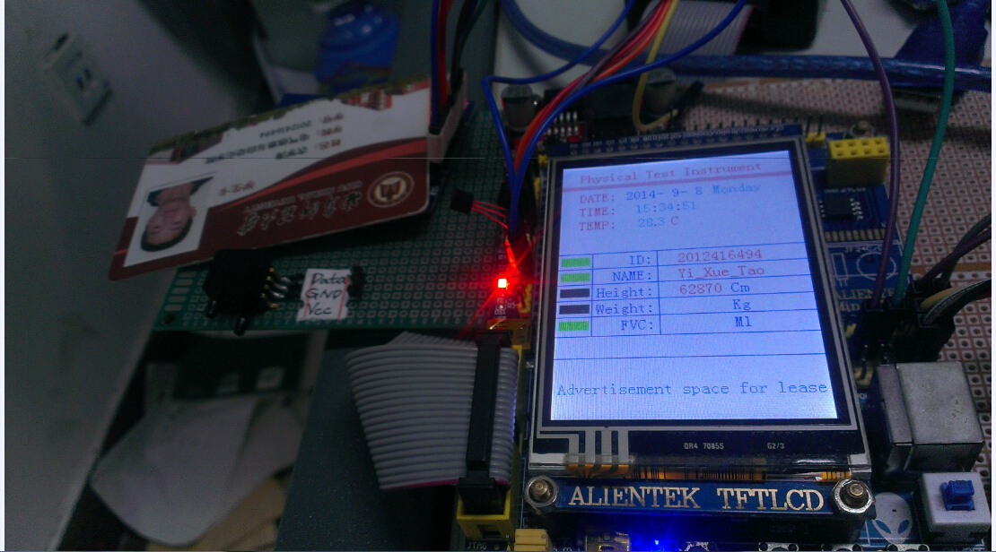

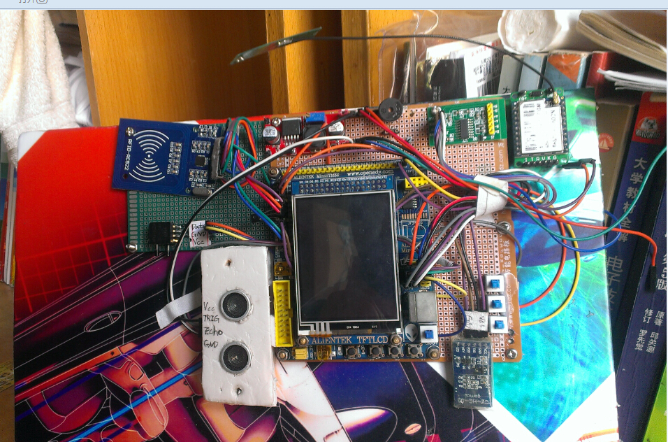

身高采用超声波,肺活量积分采用飞思卡尔的[img=0,1]file:///C:\Users\Administrator\AppData\Roaming\Tencent\Users\790209823\QQ\WinTemp\RichOle\~V6CP`8GU]FH8[(WZX7WV0U.jpg[/img]芯片,型号忘了。。体重就是普通的惠更斯电桥加HX711 AD转换,程序源码分享!  [img=0,1]file:///C:\Users\Administrator\AppData\Roaming\Tencent\Users\790209823\QQ\WinTemp\RichOle\~V6CP`8GU]FH8[(WZX7WV0U.jpg[/img]
