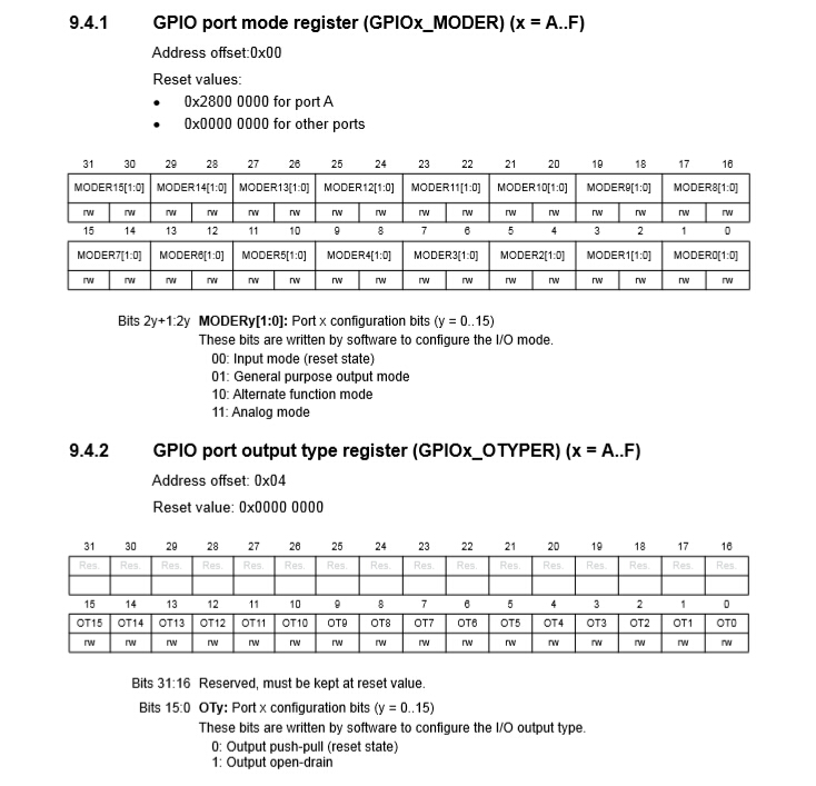

如题,我想设置PA0-3的IO口为推挽输出模式,按照参考手册设置如下
        GPIOA->MODER&=0xffffff00;
        GPIOA->MODER|=0x00000055;
        GPIOA->ODR  |=0x000f;
这样设置后,jlink无法完成下载,按照库函数方式设置后就可以,如下
        GPIO_InitStructure.GPIO_Pin = GPIO_Pin_0 | GPIO_Pin_1 | GPIO_Pin_2 | GPIO_Pin_3;
        GPIO_InitStructure.GPIO_Mode = GPIO_Mode_OUT;
        GPIO_InitStructure.GPIO_OType = GPIO_OType_PP;
        GPIO_InitStructure.GPIO_Speed = GPIO_Speed_Level_3;
        GPIO_InitStructure.GPIO_PuPd = GPIO_PuPd_UP;
        GPIO_Init(GPIOA, &GPIO_InitStructure);
不知道哪里出了问题,烦请各位帮忙解答一下,谢谢

提示什么错误啊? 推挽输出是另外一个寄存器 GPIOA_OTYPER GPIOA->OTYPER &= 0xFFFFFFF0; //推挽输出 GPIOA->OSPEEDR &= 0xFFFFFF00; GPIOA->OSPEEDR |= 0x000000FF; // 输出速度 HIGH

搞定了,没写全吗难道说
        GPIOA->OTYPER&=0x0000fff0;
        GPIOA->OTYPER|=0x00000000;
        GPIOA->OSPEEDR&=0xffffff00;
        GPIOA->OSPEEDR|=0x000000ff;
        GPIOA->PUPDR&=0xffffff00;
        GPIOA->PUPDR|=0x00000055;
