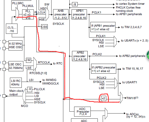

303的高性能定时器的PWM 频率是144MHz,能认为PWM的控制精度是1/144MHz吗,我在DATAsheet上没找到这部分的说明。而且144MHz也没找到,只是在网上的产品介绍中提到的。

有的,参考手册上有些,时钟树也能看到

附上原文:
The timer clock frequencies are automatically defined by hardware. There are two cases:
1. If the APB prescaler equals 1, the timer clock frequencies are set to the same
frequency as that of the APB domain.
2. Otherwise, they are set to twice (×2) the frequency of the APB domain.
Optionally the clock used by TIM1 and TIM8 can be a clock issued from the PLL running at
144 MHz when the system clock source is the PLL, and AHB and APB2 prescalers are set
to 1 i.e. AHB and APB2 clocks are not divided with respect to the system clock. QQ截图20150523002619.jpg
