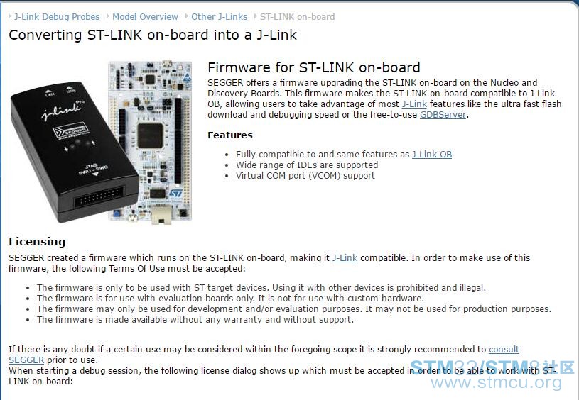

飞狼老大 发布时间:2016-6-2 11:25
本帖最后由 飞狼老大 于 2016-6-2 11:26 编辑 1 G) z" ^( }" _4 u% o/ M# O+ Q0 r" U
1 C, b" Z* N5 a4 O传说中ST-lnk可以刷成Jlink了,不过显然,只能用来调ST的mcu,只能用于开发与评估,不能用于生产,商用目的。2 a  o) M8 V, D$ K* w: N
http://www.segger.com/jlink-st-link.html, @' f) E# t# X2 B" J8 u1 j! U' w6 K
% G6 }9 W; K, T7 ~  f* bConverting ST-LINK on-board into a J-Link
2 t: N7 y! A. z* J. _
9 h' q/ ^, ^" `9 u3 \; hFirmware for ST-LINK on-board
SEGGER offers a firmware upgrading the ST-LINK on-board on the Nucleo and Discovery Boards. This firmware makes the ST-LINK on-board compatible to J-Link OB, allowing users to take advantage of most J-Link features like the ultra fast flash download and debugging speed or the free-to-use GDBServer.
Features
  • Fully compatible to and same features as J-Link OB
  • Wide range of IDEs are supported
  • Virtual COM port (VCOM) support
    % P: h4 j; e& @/ s- g- X: q: x& n8 H
: K$ X# I5 r" |0 f$ _Licensing
SEGGER created a firmware which runs on the ST-LINK on-board, making it J-Link compatible. In order to make use of this firmware, the following Terms Of Use must be accepted:
  • The firmware is only to be used with ST target devices. Using it with other devices is prohibited and illegal.
  • The firmware is for use with evaluation boards only. It is not for use with custom hardware.
  • The firmware may only be used for development and/or evaluation purposes. It may not be used for production purposes.
  • The firmware is made available without any warranty and without support.6 P, `' q, S" I" V
/ |5 Z* t3 ]! B( zIf there is any doubt if a certain use may be considered within the foregoing scope it is strongly recommended to consult SEGGER prior to use.
