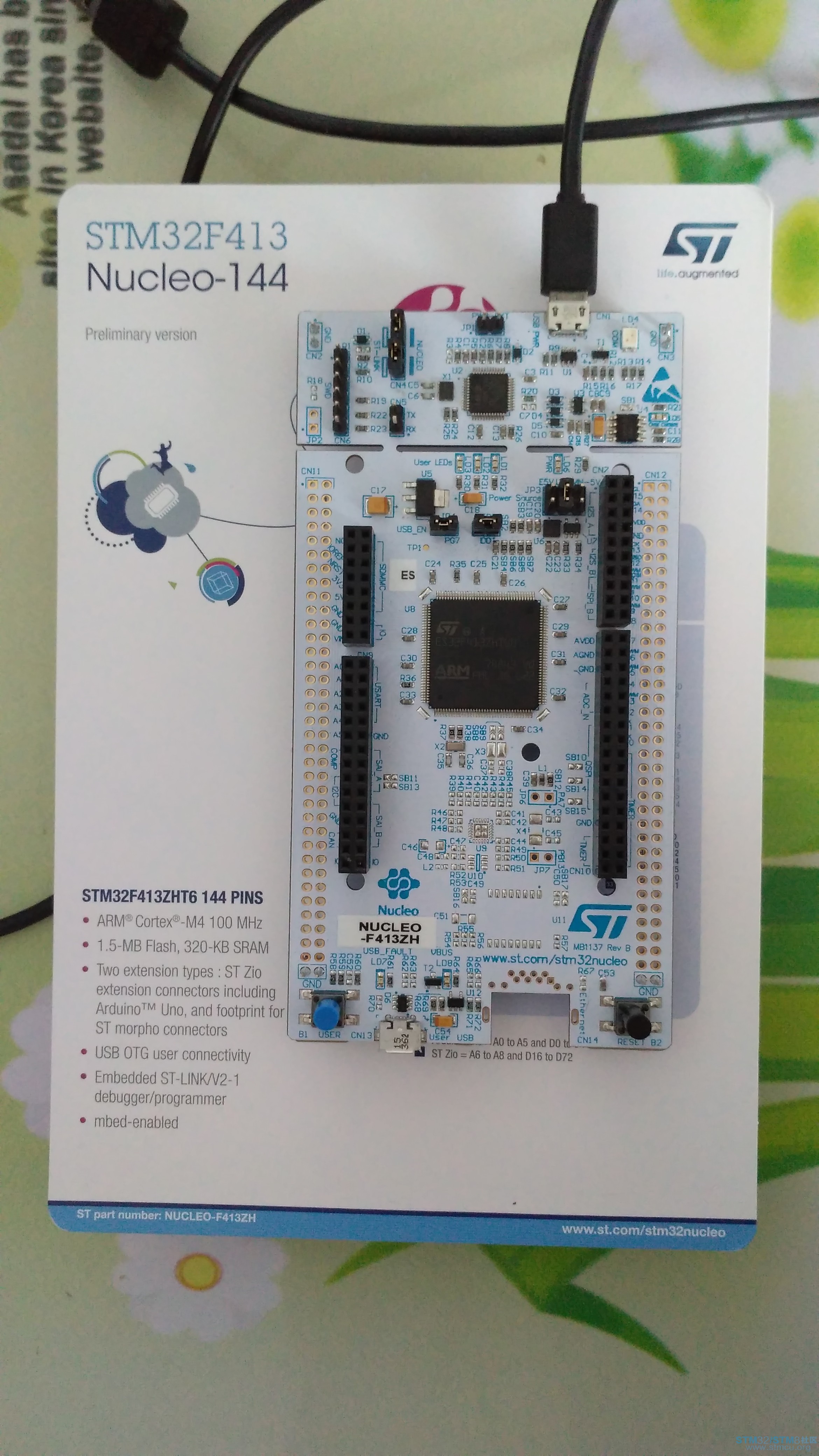

先上第一张图,开发板整体图。
开发板整体图
开发板整体图

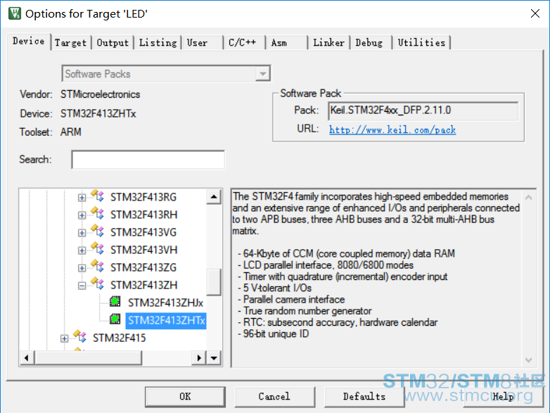

如果使用MDK-ARM 5.22 开发环境,如果找不到芯片型号,可以离线下载Keil.STM32F4xx_DFP.2.11.0.pack手工导入。
http://www.keil.com/pack/Keil.STM32F4xx_DFP.2.11.0.pack
http://keilpack.azureedge.net/p ... 4xx_DFP.2.11.0.pack

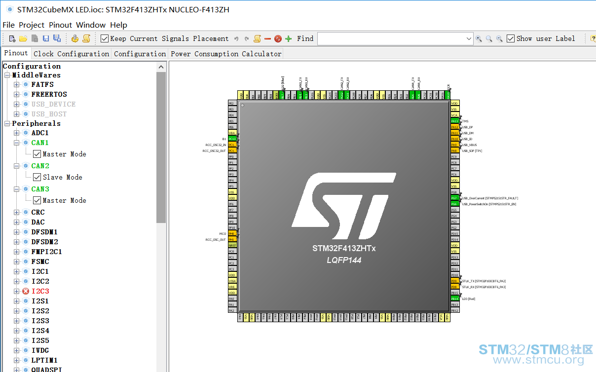

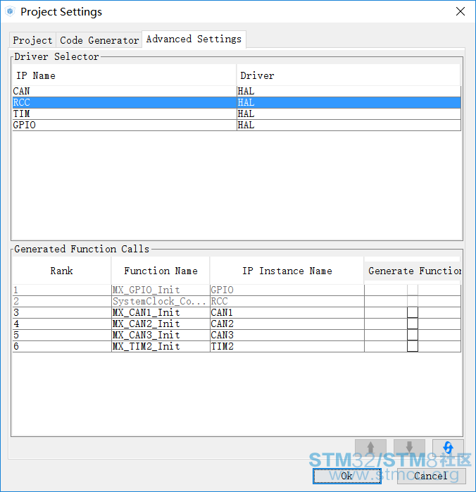

三路CAN初始化配置
三路CAN初始化配置
注意,需要把三线调试设置改为两线调试,才可以开启第三路CAN。

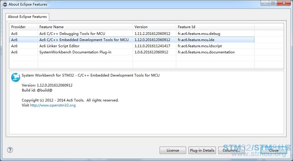

System Workbench for STM32 - C/C++ Embedded Development Tools for MCU
(STM32官网)
Installation
Installation of System Workbench for STM32 - Bare edition will be done through the standard Eclipse installer.
You should Start Eclipse then open menu "Help >> Install New Software"; this will open the "Available Software" dialog:
You must then create a new update site, to be able to install System Workbench for STM32 - Bare Metal Edition:
1. You should click on "Add:"
2. Then give a name to the update site (System Workbench for STM32 - Bare Machine edition) and set the location to http://www.openstm32.org/Eclipse ... stem-workbench.site
3. Then click "OK" to create the update site
Then you should select all of the OpenSTM32 tools and click "Next>"
You will then just have to accept the license and System Workbench for STM32 - Bare Metal edition will install itself in your Eclipse setup.
Note that you will probably have to restart Eclipse for the tools to be available; Eclipse will automatically suggest the restart.

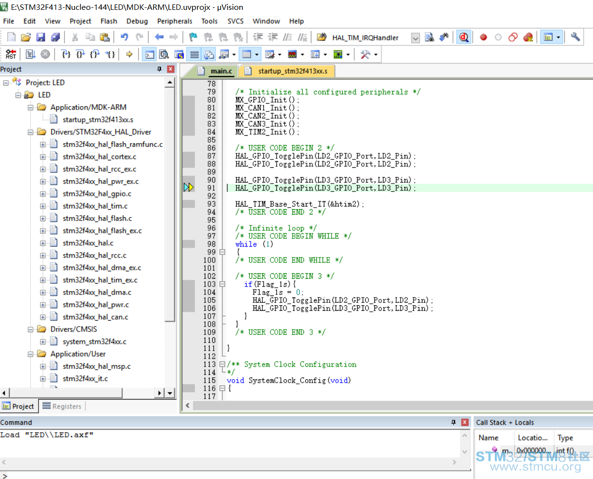

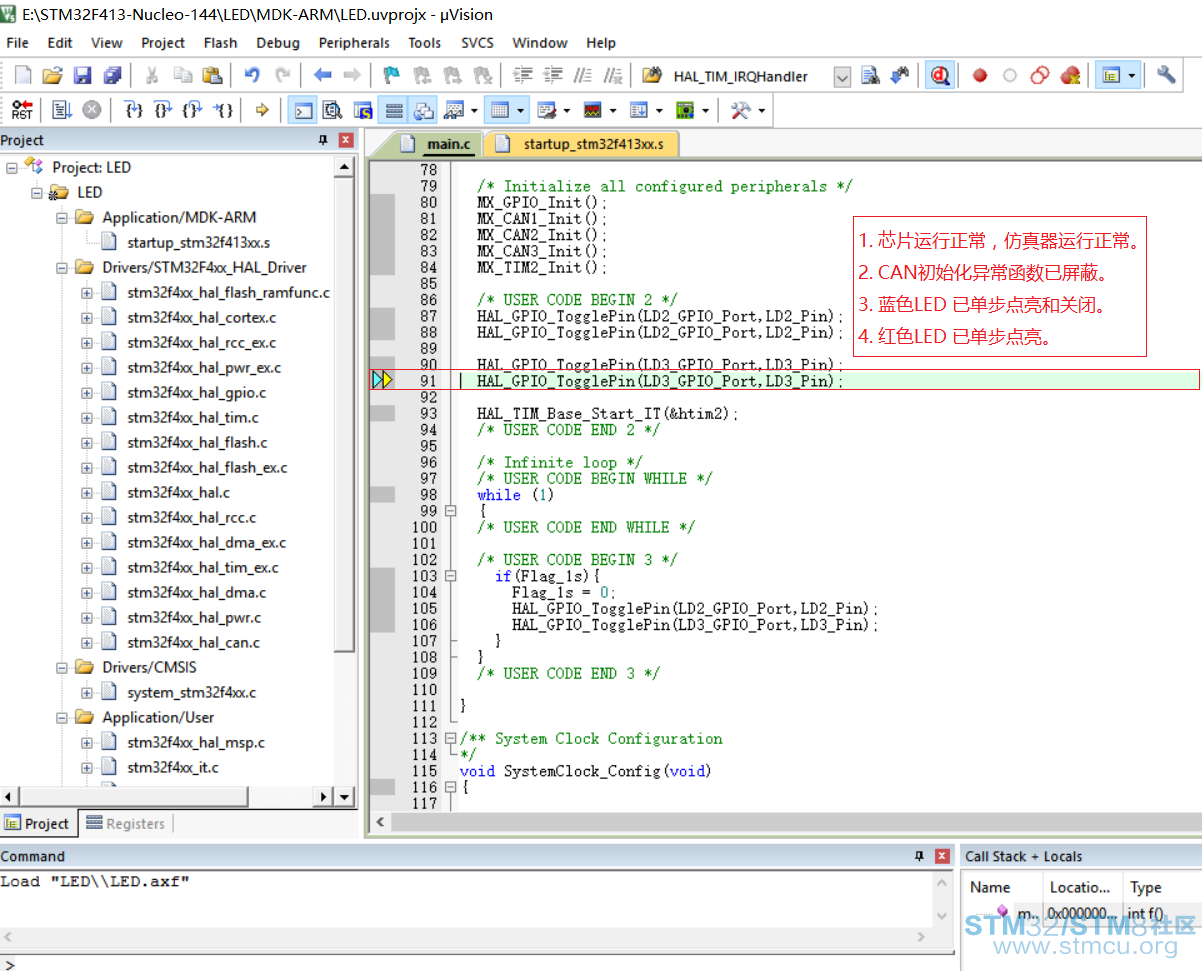

在NUCLEO-F413ZH开发板上运行的例程,红色蓝色LED一起闪灯。
备注:只有正常运行了,才可以发评测,否则就是作假。

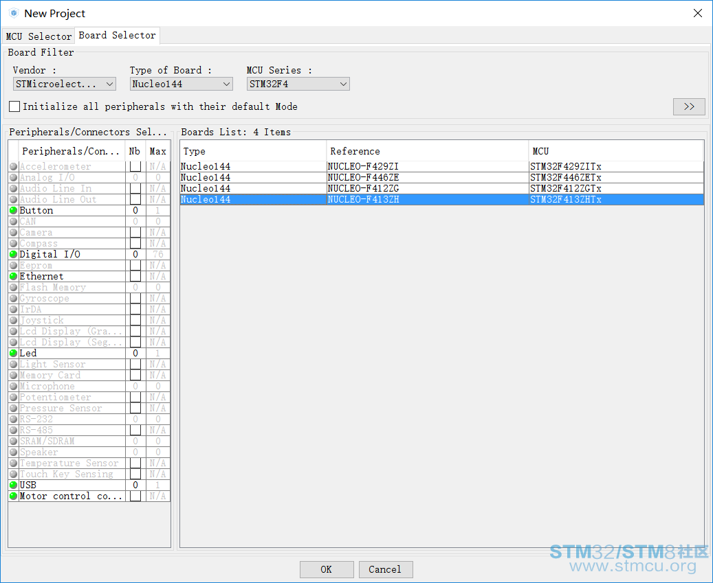

001选择开发板
001选择开发板
001选择开发板

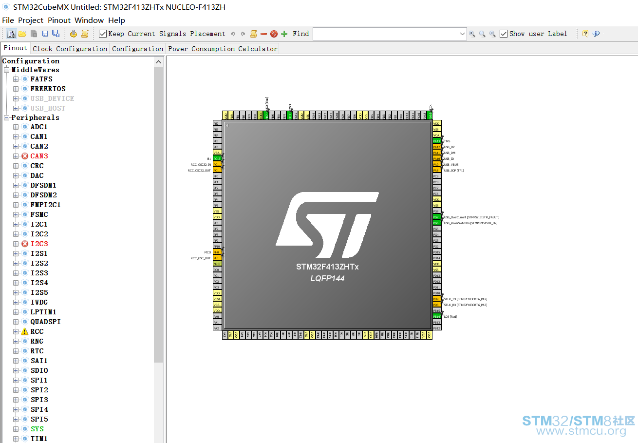

003三路CAN初始化设置
003三路CAN初始化设置
003三路CAN初始化设置
005设置定时器

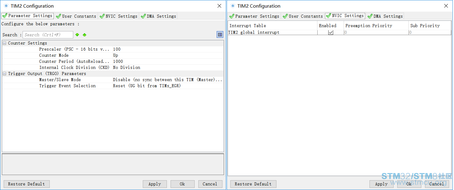

006初始化代码顺序调整

007 芯片选择和资源信息
备注:在MDK-ARM中更新为新版本的pack文件,才可以找到最新芯片的型号

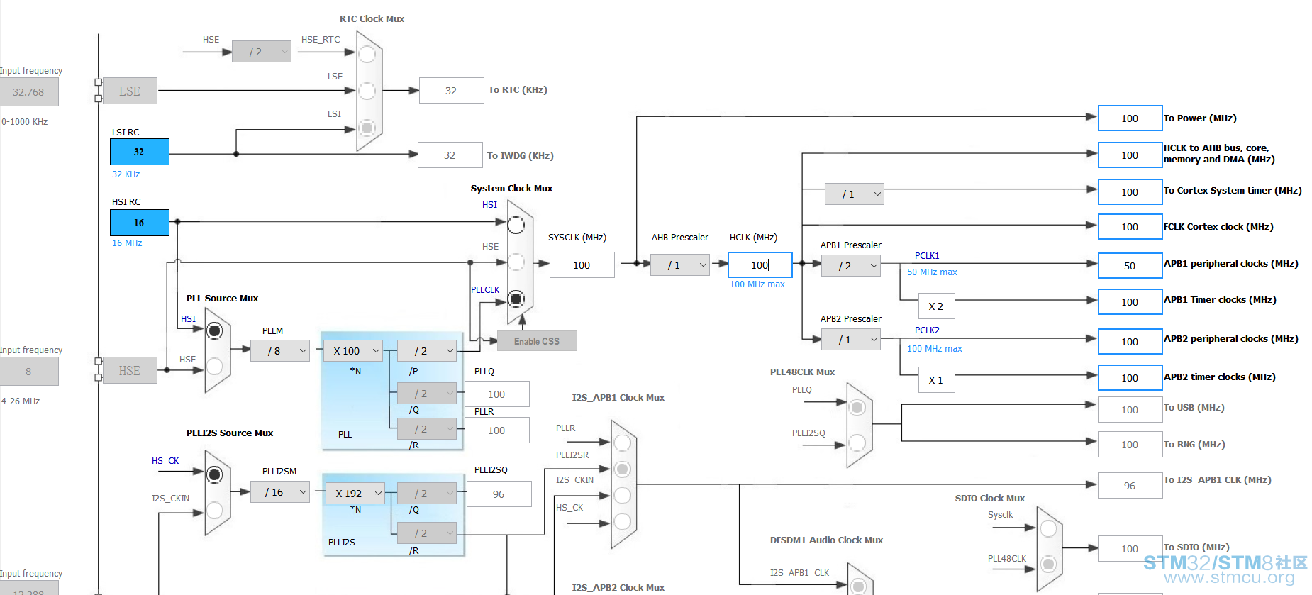

008调试界面包含的信息
008调试界面包含的信息
008调试界面包含的信息
