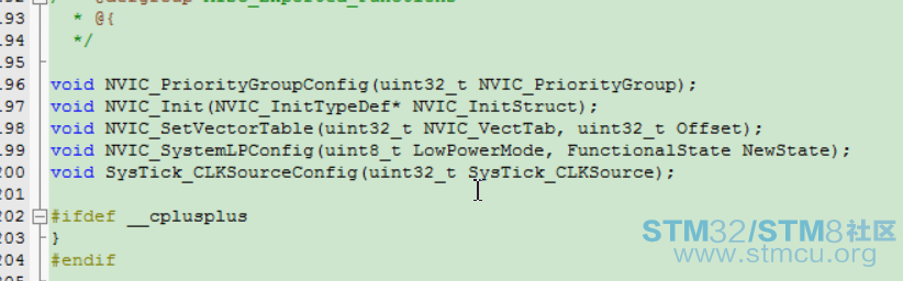

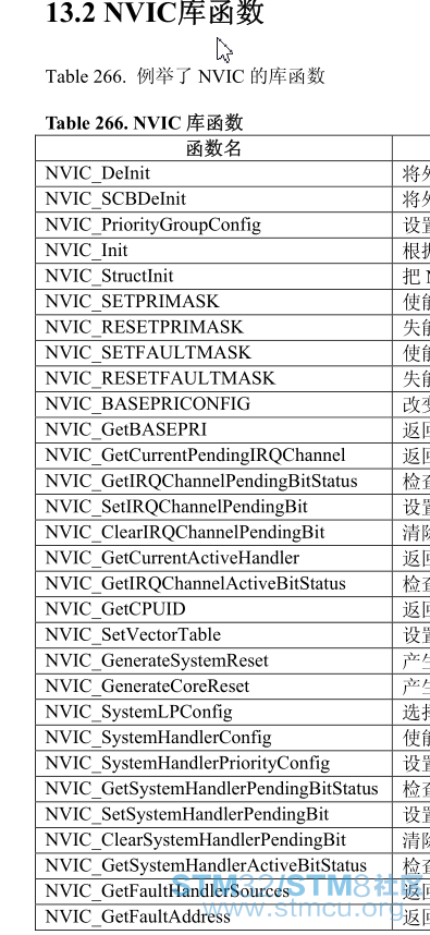

我之前一直用老版本的固件库使用手册,来学习固件库3.5的使用。之前一些外设感觉还好,虽然有些小不同但还是稍微改改就行了。现在学中断,发现变化好多,之前那么多功能函数只剩下5个了,而且我也不知道他们有什么用,请问这个该怎么搞?? 搜狗截图20161228203910.png 搜狗截图20161228203941.png

any012 回答时间:2016-12-29 10:04:38
我是这么弄得,参考正点原子和野火的例程:
  1. void NVIC_Configuration(void)
  2. {
  3.         NVIC_InitTypeDef NVIC_InitStructure;
  4.         NVIC_PriorityGroupConfig(NVIC_PriorityGroup_2);
  5.
  6.         NVIC_InitStructure.NVIC_IRQChannel = USART1_IRQn;
  7.         NVIC_InitStructure.NVIC_IRQChannelPreemptionPriority = 3;
  8.         NVIC_InitStructure.NVIC_IRQChannelSubPriority = 1;
  9.         NVIC_InitStructure.NVIC_IRQChannelCmd = ENABLE;
  10.         NVIC_Init(&NVIC_InitStructure);
  11.
  12.         NVIC_InitStructure.NVIC_IRQChannel = USART3_IRQn;
  13.         NVIC_InitStructure.NVIC_IRQChannelPreemptionPriority = 3;
  14.         NVIC_InitStructure.NVIC_IRQChannelSubPriority = 0;
  15.         NVIC_InitStructure.NVIC_IRQChannelCmd = ENABLE;
  16.         NVIC_Init(&NVIC_InitStructure);
  17.
  18.         NVIC_InitStructure.NVIC_IRQChannel = SPI2_IRQn;
  19.         NVIC_InitStructure.NVIC_IRQChannelPreemptionPriority = 0;
  20.         NVIC_InitStructure.NVIC_IRQChannelSubPriority = 0;
  21.         NVIC_InitStructure.NVIC_IRQChannelCmd = ENABLE;
  22.         NVIC_Init(&NVIC_InitStructure);
  23.
  24.         NVIC_InitStructure.NVIC_IRQChannel = TIM2_IRQn;
  25.         NVIC_InitStructure.NVIC_IRQChannelPreemptionPriority = 2;
  26.         NVIC_InitStructure.NVIC_IRQChannelSubPriority = 1;
  27.         NVIC_InitStructure.NVIC_IRQChannelCmd = ENABLE;
  28.         NVIC_Init(&NVIC_InitStructure);
  29.
  30.         NVIC_InitStructure.NVIC_IRQChannel = TIM3_IRQn;
  31.         NVIC_InitStructure.NVIC_IRQChannelPreemptionPriority = 2;
  32.         NVIC_InitStructure.NVIC_IRQChannelSubPriority = 2;
  33.         NVIC_InitStructure.NVIC_IRQChannelCmd = ENABLE;
  34.         NVIC_Init(&NVIC_InitStructure);
  35.
  36.         NVIC_InitStructure.NVIC_IRQChannel = TIM4_IRQn;
  37.         NVIC_InitStructure.NVIC_IRQChannelPreemptionPriority = 2;
  38.         NVIC_InitStructure.NVIC_IRQChannelSubPriority = 3;
  39.         NVIC_InitStructure.NVIC_IRQChannelCmd = ENABLE;
  40.         NVIC_Init(&NVIC_InitStructure);
  41.
  42.         NVIC_InitStructure.NVIC_IRQChannel = EXTI4_IRQn;
  43.         NVIC_InitStructure.NVIC_IRQChannelPreemptionPriority = 3;
  44.         NVIC_InitStructure.NVIC_IRQChannelSubPriority = 1;
  45.         NVIC_InitStructure.NVIC_IRQChannelCmd = ENABLE;
  46.         NVIC_Init(&NVIC_InitStructure);
  47.
  48.         NVIC_InitStructure.NVIC_IRQChannel = EXTI9_5_IRQn;
  49.         NVIC_InitStructure.NVIC_IRQChannelPreemptionPriority = 3;
  50.         NVIC_InitStructure.NVIC_IRQChannelSubPriority = 0;
  51.         NVIC_InitStructure.NVIC_IRQChannelCmd = ENABLE;
  52.         NVIC_Init(&NVIC_InitStructure);
  53. }
只用到了你贴图里的函数中的前两个。
后三个函数,暂时还未用到过。
