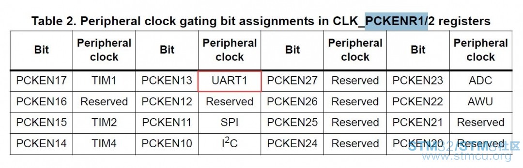

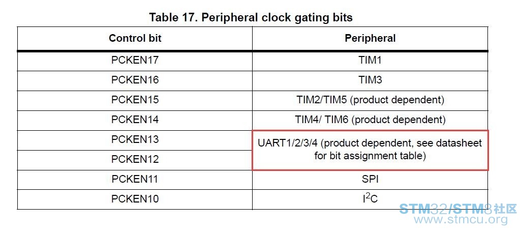

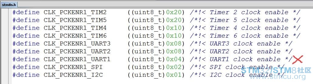

1. CLK->PCKENR1 使能 CLK_PCKENR1_UART1 无效
& D  b7 X% k; o* b" B0 h( F想降低功耗,单独打开 CLK_PCKENR1_UART1,但UART无输出。* ?  B( p1 f$ K3 S  A
核对资料发现:
3 F6 n6 ?( A. k* p7 Z1 X
. H+ p; {7 c( ?
% c+ [( l: B& b7 m* W解决方法: 不要使用 stm8s.h中的 CLK_PCKENR1_UART1: k4 R1 x- I$ l6 p* H, b
自己使能 bit3% v9 H# k+ H# Y- ^/ S

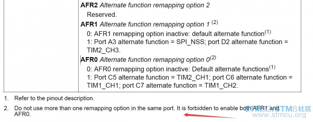

3. 数据手册中有写 AFR0和AFR1不能同时使用,但他们的IO并不冲突呀?而且我目前就这样用了,而且调试正常。
# Q/ o& n5 R" k& z0 z0 E6 H但刚才翻资料看到这句就懵了。6 b5 T- J) Y) L9 _1 g- i2 N- S5 O) j
0 m( f4 H) K# z, b8 G% }$ O
AFR1 Alternate function remapping option 1 (2). e& n- M5 U2 C# e4 H$ _  f2 E9 p
0: AFR1 remapping option inactive: default alternate function(1)6 G6 f- h2 Q% u
1: Port A3 alternate function = SPI_NSS; port D2 alternate function =TIM2_CH3./ [% `, b3 X4 X% a% P7 X" ?; ?
8 a9 H7 ~# n% p* w- y* T
AFR0 Alternate function remapping option 0(2)
: {3 d( G+ N# Q0: AFR0 remapping option inactive: Default alternate functions(1)! c# S4 ?* r0 D6 n* I
1: Port C5 alternate function = TIM2_CH1; port C6 alternate function =TIM1_CH1; port C7 alternate function = TIM1_CH2.
6 t) `5 W/ E! \1 D; s/ o$ E+ E. B; D0 w7 @, A( X: @. Y
1. Refer to the pinout description.. i6 m8 {! `$ [3 I% P
2. Do not use more than one remapping option in the same port. It is forbidden to enable both AFR1 and: u  _$ ^4 f+ K* L7 z
AFR0.
: ~- }" x5 ?" r+ _
8 l& u7 Z- R' D1 {1 @/ k  n0 } 1.jpg
  d2 F: @) A: m; \/ ?* U# I. I% G+ B; ?% ?7 e% K/ T
这个暂时还没得到答案!为保险起见,决定不使能AFR1,还是修改电路,把 PD2 [TIM2_CH3] 还是换成PA3 TIM2_CH3。* K0 b$ m7 @/ d$ ~
