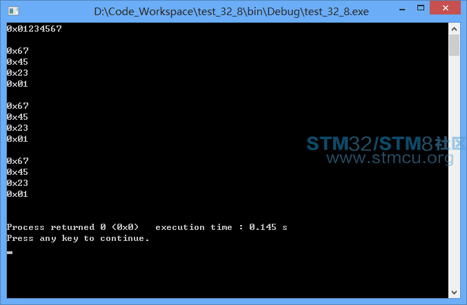

七哥 回答时间:2017-6-19 23:51:19
  1. #include <stdio.h>
  2. #include <stdlib.h>
  3. #include <stdint.h>
  4. int main()
  5. {
  6.     uint32_t a32=0x01234567;
  7.     uint32_t * p32;
  8.     uint8_t * p8;
  9.     uint8_t a8[4];
  10.     p32 = &a32;
  11.     p8 = (uint8_t *)p32;
  12.     printf("0x%08X\n",a32);
  13.     printf("\n");
  14.     printf("0x%02X\n",*((uint8_t *)p32+0));
  15.     printf("0x%02X\n",*((uint8_t *)p32+1));
  16.     printf("0x%02X\n",*((uint8_t *)p32+2));
  17.     printf("0x%02X\n",*((uint8_t *)p32+3));
  18.     printf("\n");
  19.     printf("0x%02X\n",*(p8+0));
  20.     printf("0x%02X\n",*(p8+1));
  21.     printf("0x%02X\n",*(p8+2));
  22.     printf("0x%02X\n",*(p8+3));
  23.     printf("\n");
  24.     a8[0] = *(p8+0);
  25.     a8[1] = *(p8+1);
  26.     a8[2] = *(p8+2);
  27.     a8[3] = *(p8+3);
  28.     printf("0x%02X\n",a8[0]);
  29.     printf("0x%02X\n",a8[1]);
  30.     printf("0x%02X\n",a8[2]);
  31.     printf("0x%02X\n",a8[3]);
  32.     printf("\n");
  33.     return 0;
  34. }
