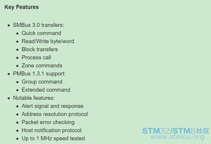

ST有现成的SMBus/PMBus协议栈:X-CUBE-SMBUS
STM32Cube SMBus/PMBus embedded software (AN4502)
目前支持F0、F3、L0、L4等系列的产品:
http://www.st.com/content/st_com ... n/x-cube-smbus.html
