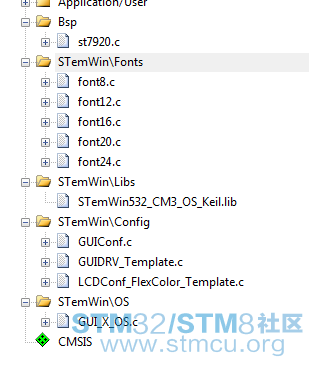

     我是用串口驱动12864点阵屏(ST7920)的,现在已经用调用字库设计了菜单。后来想把节目做的绚烂一些,所以想到在STM32F105上移植STemWin。
     参考网上的一些攻略,已经把打点、画线等底层函数写好,且修改了有关文件。但调用STemWin的函数,就是不理会呢!

modu8888 回答时间:2017-10-20 08:51:43
在GUI.c中修改
#define GUI_NUMBYTES  (10*1024)
修改GUIDRV_Template.c中 读点函数、写点函数是自己定义的:
static void _SetPixelIndex(GUI_DEVICE * pDevice, int x, int y, int PixelIndex) {
        LCM_PutPixel(x,y,PixelIndex);
static unsigned int _GetPixelIndex(GUI_DEVICE * pDevice, int x, int y) {
  unsigned int PixelIndex;
    // Convert logical into physical coordinates (Dep. on LCDConf.h)
    #if (LCD_MIRROR_X == 1) || (LCD_MIRROR_Y == 1) || (LCD_SWAP_XY == 1)
      int xPhys, yPhys;
      xPhys = LOG2PHYS_X(x, y);
      yPhys = LOG2PHYS_Y(x, y);
    #else
      #define xPhys x
      #define yPhys y
    #endif
    GUI_USE_PARA(pDevice);
    GUI_USE_PARA(x);
    GUI_USE_PARA(y);
      PixelIndex = LCM_GetPixel(x,y);
    #if (LCD_MIRROR_X == 0) && (LCD_MIRROR_Y == 0) && (LCD_SWAP_XY == 0)
      #undef xPhys
      #undef yPhys
    #endif
  return PixelIndex;
在LCDConf_FlexColor_Template.c中修改显示屏的尺寸
// Physical display size
#define XSIZE_PHYS  128 // To be adapted to x-screen size
#define YSIZE_PHYS  64 // To be adapted to y-screen size
#define VXSIZE_PHYS 128
#define VYSIZE_PHYS 64
色彩转换也改了
void LCD_X_Config(void) {
  // Set display driver and color conversion
  GUI_DEVICE_CreateAndLink(GUIDRV_FLEXCOLOR, GUICC_1, 0, 0);
  // Display driver configuration, required for Lin-driver
  LCD_SetSizeEx (0, XSIZE_PHYS , YSIZE_PHYS);
  LCD_SetVSizeEx(0, VXSIZE_PHYS, VYSIZE_PHYS);

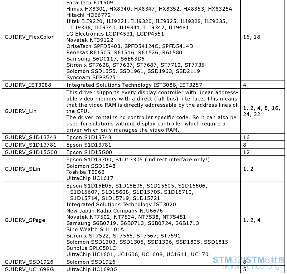

    运行STemWin要启用CRC校验:
RCC_AHBPeriphClockCmd(RCC_AHBPeriph_CRC, ENABLE);
另外ST7920驱动STemWin好像没有支持
