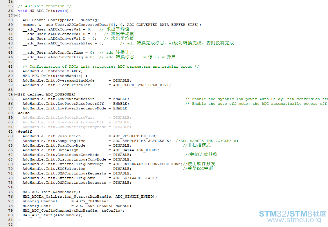

void MX_ADC_Init(void)
  ADC_ChannelConfTypeDef   sConfig;
        memset(&__adc_User.aADCxConvertedData[0], 0, ADC_CONVERTED_DATA_BUFFER_SIZE);
        __adc_User.aADCxConverVal = 0;   // 求出平均值
        __adc_User.aADCxConverVal_H = 0;   // 求出平均值
        __adc_User.aADCxConverVal_L = 0;   // 求出平均值
        __adc_User.aADC_ConvFinishFlag = 0;       // adc 转换完成标志,=1说明转换完成,否则没有完成
        __adc_User.aAdcConvCntTime = 0;  // adc 转换计时
        __adc_User.aAdcConvCntFlag = 0;  // adc 转换标志    =1停止,=0开启
  /* Configuration of ADCx init structure: ADC parameters and regular group */
  AdcHandle.Instance = ADCx;
  HAL_ADC_DeInit(&AdcHandle) ;
  AdcHandle.Init.OversamplingMode      = DISABLE;
  AdcHandle.Init.ClockPrescaler        = ADC_CLOCK_SYNC_PCLK_DIV1;
  AdcHandle.Init.LowPowerFrequencyMode = ENABLE;
#if defined(ADC_LOWPOWER)
  AdcHandle.Init.LowPowerAutoWait      = ENABLE;                        /* Enable the dynamic low power Auto Delay: new conversion start only when the previous conversion (for regular group) or previous sequence (for injected group) has been treated by user software. */
  AdcHandle.Init.LowPowerAutoPowerOff  = ENABLE;                        /* Enable the auto-off mode: the ADC automatically powers-off after a conversion and automatically wakes-up when a new conversion is triggered (with startup time between trigger and start of sampling). */
#else
  AdcHandle.Init.LowPowerAutoWait      = DISABLE;
  AdcHandle.Init.LowPowerAutoPowerOff  = DISABLE;
#endif
  AdcHandle.Init.Resolution            = ADC_RESOLUTION_12B;
  AdcHandle.Init.SamplingTime          = ADC_SAMPLETIME_7CYCLES_5;  //ADC_SAMPLETIME_7CYCLES_5;
  AdcHandle.Init.ScanConvMode          = DISABLE;                      //非扫描模式
  AdcHandle.Init.DataAlign             = ADC_DATAALIGN_RIGHT;
  AdcHandle.Init.ContinuousConvMode    = DISABLE;                                                //关闭连续转换
  AdcHandle.Init.DiscontinuousConvMode = DISABLE;
  AdcHandle.Init.ExternalTrigConvEdge  = ADC_EXTERNALTRIGCONVEDGE_NONE;//使用软件触发
  AdcHandle.Init.EOCSelection          = DISABLE;                      //关闭EOC中断
  AdcHandle.Init.DMAContinuousRequests = DISABLE;
  HAL_ADC_Init(&AdcHandle);
  HAL_ADCEx_Calibration_Start(&AdcHandle, ADC_SINGLE_ENDED);
  sConfig.Channel      = ADCx_CHANNELa;
  sConfig.Rank         = ADC_RANK_CHANNEL_NUMBER;
  HAL_ADC_ConfigChannel(&AdcHandle, &sConfig);
//        HAL_ADC_Start(&AdcHandle);

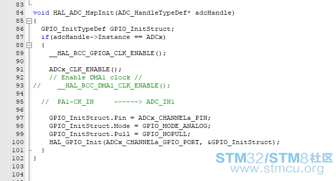

void HAL_ADC_MspInit(ADC_HandleTypeDef* adcHandle)
  GPIO_InitTypeDef GPIO_InitStruct;
//        static DMA_HandleTypeDef         DmaHandle;
  if(adcHandle->Instance == ADCx)
                __HAL_RCC_GPIOA_CLK_ENABLE();
                ADCx_CLK_ENABLE();
                // Enable DMA1 clock //
//                __HAL_RCC_DMA1_CLK_ENABLE();
  //  PA1-CK_IN     ------> ADC_IN1
    GPIO_InitStruct.Pin = ADCx_CHANNELa_PIN;
    GPIO_InitStruct.Mode = GPIO_MODE_ANALOG;
    GPIO_InitStruct.Pull = GPIO_NOPULL;
    HAL_GPIO_Init(ADCx_CHANNELa_GPIO_PORT, &GPIO_InitStruct);

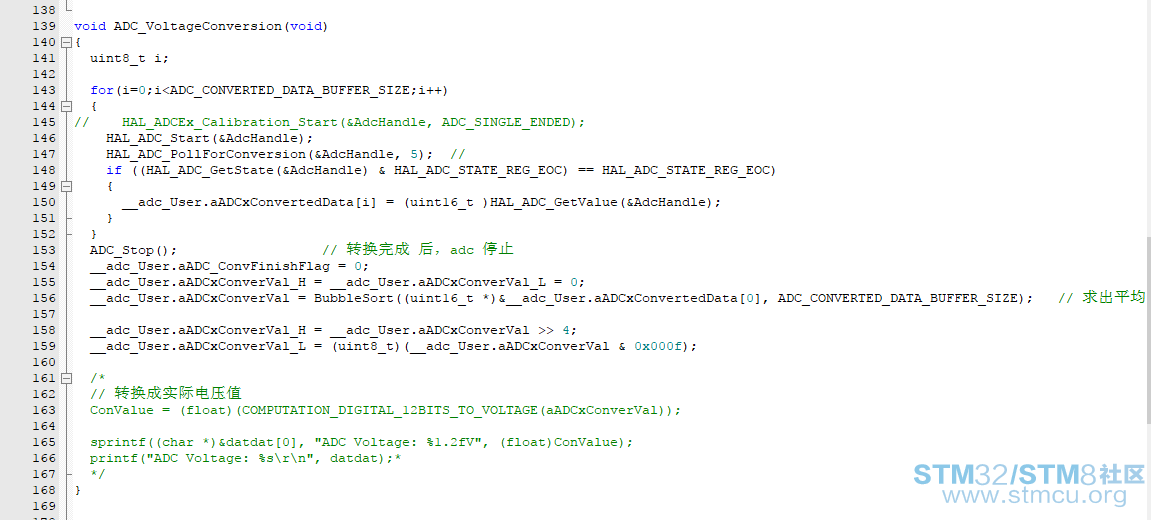

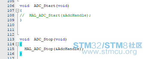

void  ADC_Stop(void)
        HAL_ADC_Stop(&AdcHandle);
void ADC_VoltageConversion(void)
  uint8_t i;
        for(i=0;i<ADC_CONVERTED_DATA_BUFFER_SIZE;i++)
                HAL_ADC_PollForConversion(&AdcHandle, 5);  //
                if ((HAL_ADC_GetState(&AdcHandle) & HAL_ADC_STATE_REG_EOC) == HAL_ADC_STATE_REG_EOC)
                        __adc_User.aADCxConvertedData = (uint16_t )HAL_ADC_GetValue(&AdcHandle);
        ADC_Stop();                  // 转换完成 后,adc 停止
        __adc_User.aADCxConverVal_H = __adc_User.aADCxConverVal_L = 0;
        __adc_User.aADCxConverVal = BubbleSort((uint16_t *)&__adc_User.aADCxConvertedData[0], ADC_CONVERTED_DATA_BUFFER_SIZE);   // 求出平均值
        __adc_User.aADCxConverVal_H = __adc_User.aADCxConverVal >> 4;
        __adc_User.aADCxConverVal_L = (uint8_t)(__adc_User.aADCxConverVal & 0x000f);
        // 转换成实际电压值
        ConValue = (float)(COMPUTATION_DIGITAL_12BITS_TO_VOLTAGE(aADCxConverVal));
        sprintf((char *)&datdat[0], "ADC Voltage: %1.2fV", (float)ConValue);
        printf("ADC Voltage: %s\r\n", datdat);*
