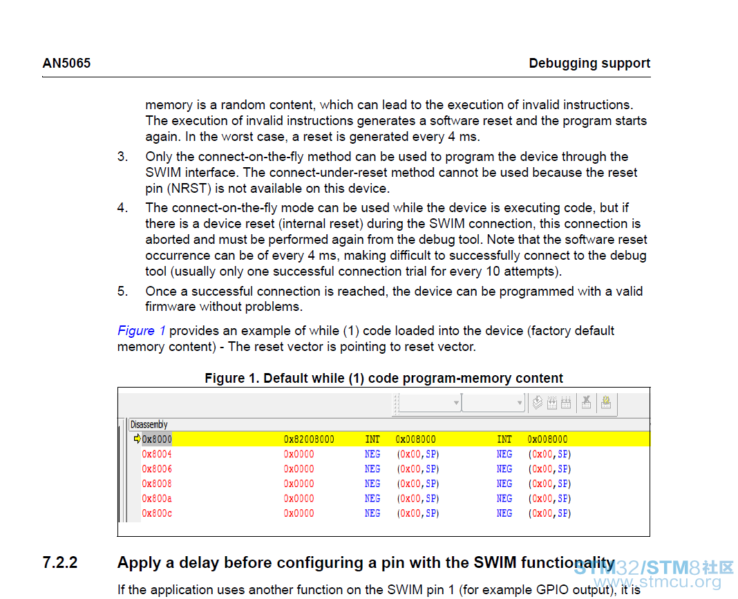

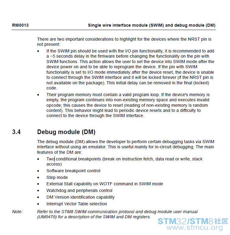

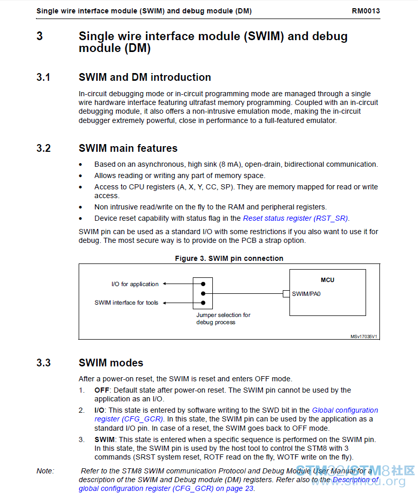

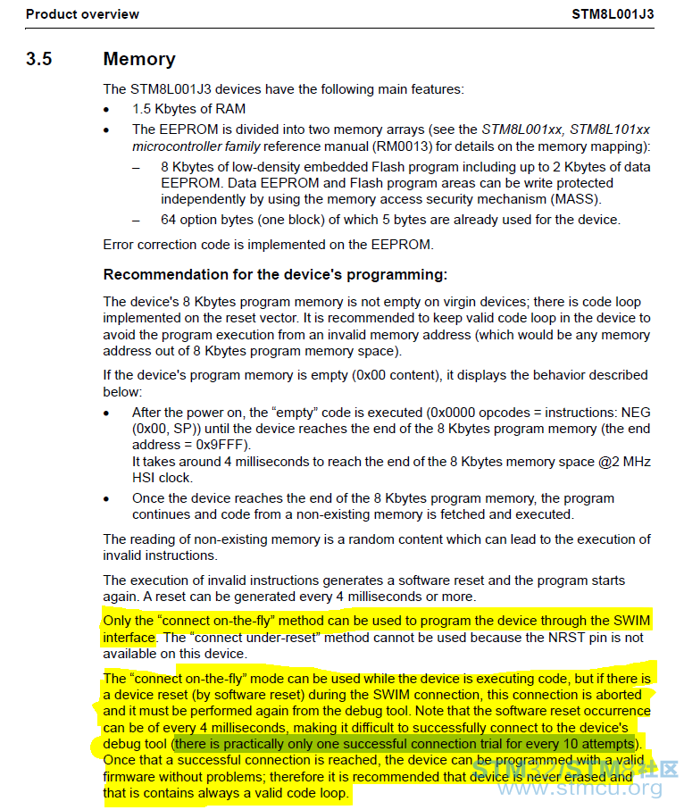

没有复位脚
1.檢查板子上的電源是否正常。
2.再確認SWIM的腳PIN有無接錯。
3.重新Power Off 再 Power On板子上的電源。
4.ST Link重PC上先拔除再連接。
以上, FYI。

/* This delay should be added just after reset to have access to SWIM pin
and to be able to reprogram the device after power on (otherwise the
device will be locked) */

/* delay for SWIM connection: ~5seconds */
STARTUP_SWIM_DELAY_5S;
