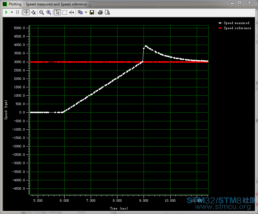

3、程序执行的结果:. G7 K* F: f# ~8 E; m7 I7 |
3.1、原始PID数据7 Z, C* H- [$ `3 P
    PID_SetKP(pMctHdl->pPIDSpeed,Speed_Kp*1);
# T! g' q. @5 _  u
    PID_SetKI(pMctHdl->pPIDSpeed,Speed_Ki*1);
; x: w& I* }: J7 S$ S5 C5 S( d" G" z) ]- D1 S
9 b& u3 E4 [* J$ V0 o2 E9 ]7 ?

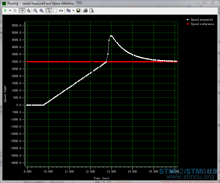

- C0 ~  z. ]9 e% d3.2、2倍PID数据- x9 s; o6 ^8 s! W. ^
    PID_SetKP(pMctHdl->pPIDSpeed,Speed_Kp*2);
2 t0 i# R8 G* x3 v2 V4 N9 u% R( g/ T
    PID_SetKI(pMctHdl->pPIDSpeed,Speed_Ki*2);: \, z+ h8 Y8 Q* Q
4 c9 F. |$ T4 i4 s5 z9 N 1.png 5 ^0 k0 h( S1 X7 K. u) S2 L

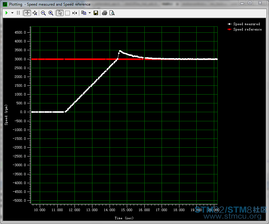

3.3、0.5倍PID数据
+ [1 f8 G' v3 k- ^: f, C5 M    PID_SetKP(pMctHdl->pPIDSpeed,Speed_Kp*0.5);6 M6 W9 }1 U1 m$ k
    PID_SetKI(pMctHdl->pPIDSpeed,Speed_Ki*0.5);: \* e/ M* x+ @. X& q- n' J8 _
305.png 8 e9 s  O2 W- h+ a& D; v/ W9 }( Q
