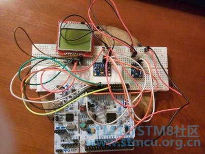

硬件组件
STM32 NucleoSTM32F072 Nucleo Board  ×        1
AdafruitHMC5883L板  ×    1
Adafruit MPU6050板  ×      1
面包板(通用)  ×     1

     我带着另一个小项目来到这里。在这篇文章中,我想强调使用处理作为传感器输出的可视界面,以及使用陀螺仪,加速度计和磁力计计算平台的偏航,俯仰和滚动的一些基础知识。
) u  N6 d- d% ?
     在这个项目中,我特别使用了STM32板,IAR工作台IDE和标准外设库,但您可以使用Arduino Uno或几乎任何Arduino用于此目的。
3 A& t! ?1 f, [" S  Z
     我做了这个项目,希望学习如何使用上面列出的所有内容并制作一个自平衡机器人,让我们看看结果如何。加工界面的目的是向通常访问机器人俱乐部和大学的年轻学生展示。

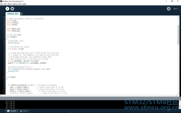

      所以有时间进行一些编程处理。代码将在下面,因为我认为,补充评论,最好显示它是如何完成的。将其复制到处理IDE +执行CTRL + T索引是一个好主意,使其更清晰。
! M- U5 G% I% C, ^( ~

import processing.serial.*;
Serial myPort;  // Create object from Serial class
PFont f;
int Yaw_H;      // Data received from the serial port
int Yaw_L = 0;
int Pitch_H;      // Data received from the serial port
int Pitch_L = 0;
int Roll_H;      // Data received from the serial port
int Roll_L = 0;
float r;
// Angle andangular velocity, accleration
float F_Yaw;
float F_Pitch;
float F_Roll;
int xi = 0, yi=0;
void setup()
//size(1300, 720);
fullScreen();
// Initialize allvalues
r = height * 0.45;
// I know that thefirst port in the serial list on my mac
// is always my  FTDI adaptor, so I open Serial.list()[0].
// On Windowsmachines, this generally opens COM1.
// Open whatever portis the one you're using.
String portName = Serial.list()[0];
myPort = new Serial(this, portName, 115200);
     Change the text font to make it bigger
     You need to go to "Tools->Createfont" to be able to use this. Just comment these 2 lines out
   if you don't feel like it.
f = createFont("SourceCodePro-Regular.vlw", 20);
textFont(f);
void draw()
   Wait for at least 4 values to be availableto receive.
   It should be in order:
   yaw least significant byte
   yaw most significant byte
   Pitch
   Roll
   Pitch and Roll can be just 1 byte since theygo in a 180º range, while yaw is 360º (360 doesn't fit in 8bit number)
if (myPort.available() >= 4) {  // If data is available,
   Yaw_L = myPort.read();        // read it and store it in val
   Yaw_H = myPort.read();        // read it and store it in val
   Pitch_L = myPort.read();        // read it and store it in val
   //Pitch_H =myPort.read();         // read it andstore it in val
   Roll_L = myPort.read();        // read it and store it in val
   //Roll_H =myPort.read();         // read it andstore it in val
   /* Just fordebug purposes, prints in text console */
   print(Yaw_L);
   print(" ");
   print(Yaw_H);
   print(" ");
   print(Pitch_L);
   print(" ");
   print(Roll_L);
   println(" ");
//Set background toblack (will erase previous drawing that was there in each cycle)
background(0);
// Translate theorigin point to the center of the screen
translate(width/2, height/2);
int Yaw;
Yaw = (Yaw_H < int Pitch = 1*(Pitch_L-90); int Roll = 1*(Roll_L-90); F_Yaw = ((Yaw+90)*PI/180.0); // Convert polar to cartesian float x = -r * cos(F_Yaw); float y = r *sin(F_Yaw); // Draw the ellipse at the cartesian coordinateellipseMode(CENTER); noStroke(); fill(0, 255, 255); ellipse(x, y, 32, 32);fill(200); ellipse(0, 0, 10, 10); float F_Roll = Roll * PI /180; y =sin(F_Roll) * 300; x = cos(F_Roll)*300; stroke(0, 255, 0); line(xi, yi, x+xi,y+yi); line(xi, yi, xi-x, yi-y); float F_Pitch = Pitch * PI /180; float  y_P= yi + sin(F_Pitch)*100; stroke(255, 0, 0); line(0, y_P, 300, y_P);line(0, y_P, -300, y_P); textAlign(RIGHT); fill(0, 255, 0);text("Roll:", 300, 200); text(Roll, 350, 200); fill(255, 0, 0);text("Pitch:", 300, 240); text(Pitch, 350, 240); fill(0, 100, 255);text("Yaw:", 300, 280); text(Yaw, 350, 280);}

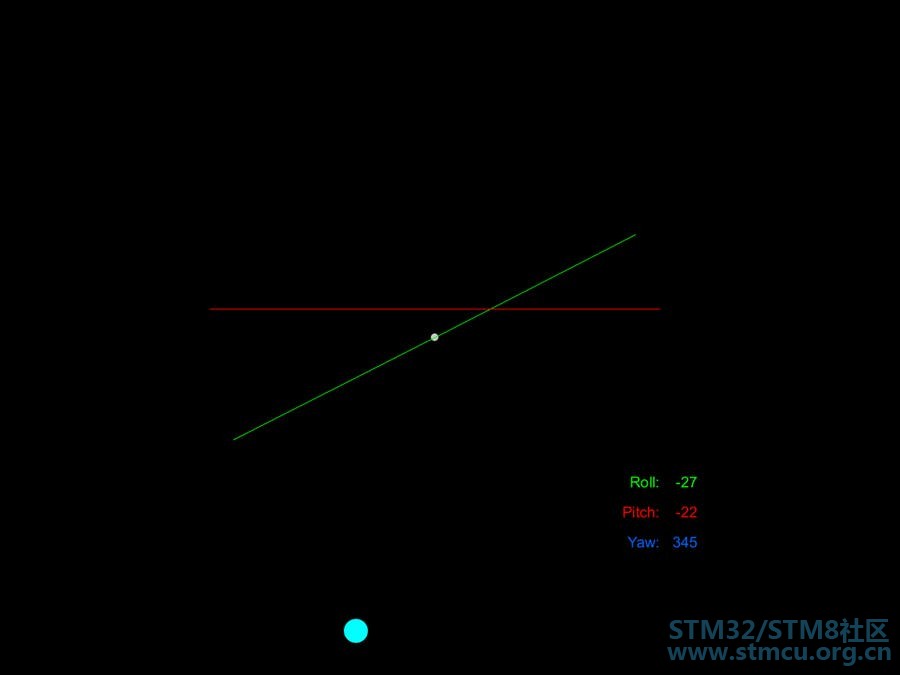

float y = r * sin(F_Yaw);
- S$ o  C6 n: N$ v
noStroke();
fill(0, 255, 255);
fill(200);
, i: D  F! Q; b4 G& W
+ d  i1 \/ o, v" s1 g4 w) a
  x =cos(F_Roll)*300;
stroke(0, 255, 0);
line(xi, yi, x+xi, y+yi);
# \( s/ @$ d2 R1 t" r- |6 l: X
stroke(255, 0, 0);
textAlign(RIGHT);
fill(0, 255, 0);
fill(255, 0, 0);
fill(0, 100, 255);
