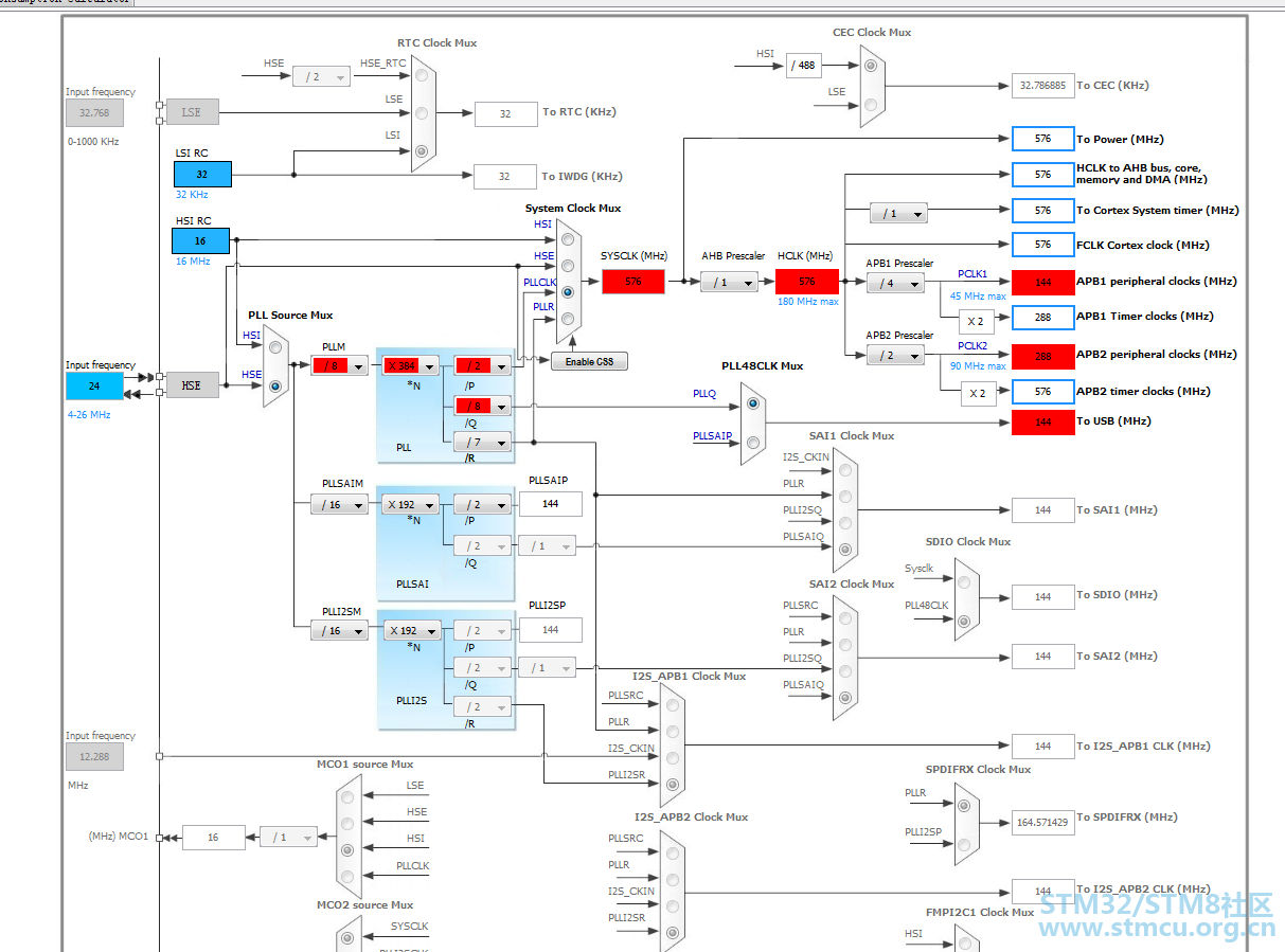

  原先原理图第一版上的晶振是8M,程序上配置的PLL_M为8。后来做第二版原理图的时候板子上的晶振选的是24M,但是!
  但是!
  程序没有改,PLL_M还是8,也就是说整个时钟树上面的时钟翻了3倍。如下图所示。
         现在出现的问题就是IAR JLINK下载程序,就会报出connecting to cpu via connect under reset failed。我们试了好几个板子,都是因为下了8M的程序,我估计是因为单片机的时钟和下载器产生矛盾了,急问现在这个问题如何去解决。。。。

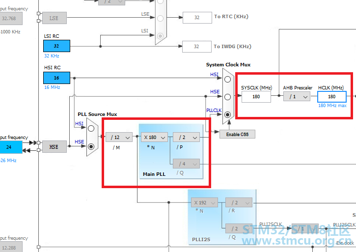

  1. void SystemClock_Config(void)
  2. {
  3.   RCC_OscInitTypeDef RCC_OscInitStruct;
  4.   RCC_ClkInitTypeDef RCC_ClkInitStruct;
  5.     /**Configure the main internal regulator output voltage
  6.     */
  7.   __HAL_RCC_PWR_CLK_ENABLE();
  8.   __HAL_PWR_VOLTAGESCALING_CONFIG(PWR_REGULATOR_VOLTAGE_SCALE1);
  9.     /**Initializes the CPU, AHB and APB busses clocks
  10.     */
  11.   RCC_OscInitStruct.OscillatorType = RCC_OSCILLATORTYPE_HSI|RCC_OSCILLATORTYPE_HSE;
  12.   RCC_OscInitStruct.HSEState = RCC_HSE_ON;
  13.   RCC_OscInitStruct.HSIState = RCC_HSI_ON;
  14.   RCC_OscInitStruct.HSICalibrationValue = 16;
  15.   RCC_OscInitStruct.PLL.PLLState = RCC_PLL_ON;
  16.   RCC_OscInitStruct.PLL.PLLSource = RCC_PLLSOURCE_HSE;
  17.   RCC_OscInitStruct.PLL.PLLM = 12;
  18.   RCC_OscInitStruct.PLL.PLLN = 180;
  19.   RCC_OscInitStruct.PLL.PLLP = RCC_PLLP_DIV2;
  20.   RCC_OscInitStruct.PLL.PLLQ = 4;
  21.   if (HAL_RCC_OscConfig(&RCC_OscInitStruct) != HAL_OK)
  22.   {
  23.     _Error_Handler(__FILE__, __LINE__);
  24.   }
  25.     /**Activate the Over-Drive mode
  26.     */
  27.   if (HAL_PWREx_EnableOverDrive() != HAL_OK)
  28.   {
  29.     _Error_Handler(__FILE__, __LINE__);
  30.   }
  31.     /**Initializes the CPU, AHB and APB busses clocks
  32.     */
  33.   RCC_ClkInitStruct.ClockType = RCC_CLOCKTYPE_HCLK|RCC_CLOCKTYPE_SYSCLK
  34.                               |RCC_CLOCKTYPE_PCLK1|RCC_CLOCKTYPE_PCLK2;
  35.   RCC_ClkInitStruct.SYSCLKSource = RCC_SYSCLKSOURCE_PLLCLK;
  36.   RCC_ClkInitStruct.AHBCLKDivider = RCC_SYSCLK_DIV1;
  37.   RCC_ClkInitStruct.APB1CLKDivider = RCC_HCLK_DIV4;
  38.   RCC_ClkInitStruct.APB2CLKDivider = RCC_HCLK_DIV2;
  39.   if (HAL_RCC_ClockConfig(&RCC_ClkInitStruct, FLASH_LATENCY_5) != HAL_OK)
  40.   {
  41.     _Error_Handler(__FILE__, __LINE__);
  42.   }
  43.   HAL_RCC_MCOConfig(RCC_MCO1, RCC_MCO1SOURCE_HSI, RCC_MCODIV_1);
  44.     /**Configure the Systick interrupt time
  45.     */
  46.   HAL_SYSTICK_Config(HAL_RCC_GetHCLKFreq()/1000);
  47.     /**Configure the Systick
  48.     */
  49.   HAL_SYSTICK_CLKSourceConfig(SYSTICK_CLKSOURCE_HCLK);
  50.   /* SysTick_IRQn interrupt configuration */
  51.   HAL_NVIC_SetPriority(SysTick_IRQn, 0, 0);
  52. }
