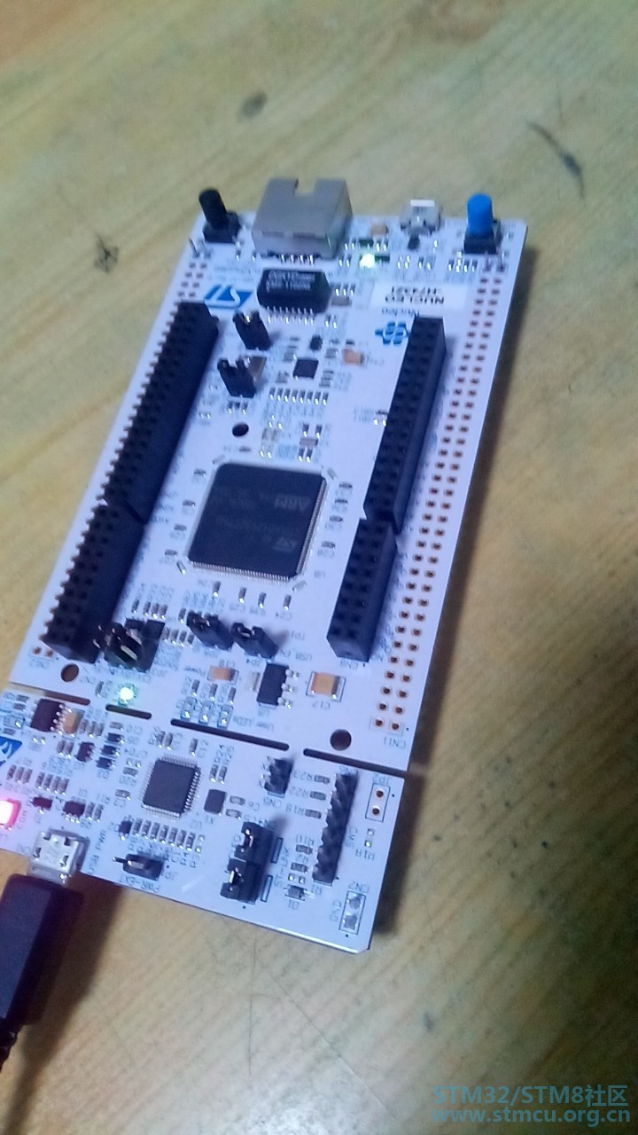

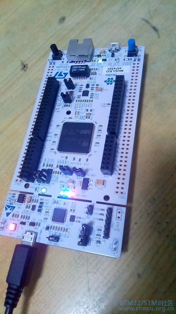

终于可以开始研究H743了,拿到手3个多月了,不能继续让其吃灰了,今天晚上走起
/ e- T- F$ O8 R- m: T; e& ~下载了正点H743的例程,
* Q5 i" y% ]7 f- C: n  {" q先研究一下LED流水灯,% [$ K* ^+ m4 ^  J0 ]; k) S- _
打开工程,按照H743的电路图确定好3个LED分别对应的管脚
& s- @' s# F) A  C- \; r# kPB0    ------ LED1; T( l' A9 b" H, _. @3 H6 z
PB7    --------LED2
1 ~0 `. U: F1 i1 \, N' n7 R$ IPB14 --------LED3
8 U2 v" ^" L$ q+ u- R) p简单配置一下IO输出的初始化
7 {/ T# H* R3 _4 @2 x9 evoid LED_Init(void)
$ R& a4 o/ b! [) }5 M) Z{# g5 I! t( h: Y/ ]
    GPIO_InitTypeDef GPIO_Initure;
" N- P* q/ }5 n2 r6 k7 X" s7 r    __HAL_RCC_GPIOB_CLK_ENABLE();                                        //¿ªÆôGPIOBʱÖÓ
6 r% w3 C4 b+ q
' ^  k  ~1 I( {9 i6 B    GPIO_Initure.Pin=GPIO_PIN_0|GPIO_PIN_7 | GPIO_PIN_14;                        //PB0£¬1
, m" A* ]  x% M1 l/ x/ j    GPIO_Initure.Mode=GPIO_MODE_OUTPUT_PP;                  //ÍÆÍìÊä³ö
' [3 w! ]1 t. S% b8 t4 {6 K    GPIO_Initure.Pull=GPIO_PULLUP;                                 //ÉÏÀ­- R7 A( [" B# d9 z7 `2 N8 }
    GPIO_Initure.Speed=GPIO_SPEED_FREQ_VERY_HIGH;          //¸ßËÙ  t* }  K/ i- b
    HAL_GPIO_Init(GPIOB,&GPIO_Initure);                     //³õʼ»¯GPIOB.0ºÍGPIOB.1& R& X7 V6 C6 Q5 @3 |7 B
        , h7 g* U2 R# ?" O
    HAL_GPIO_WritePin(GPIOB,GPIO_PIN_0,GPIO_PIN_SET);        //PB0ÖÃ0
6 Z5 d6 X7 J+ {! \! r8 ^        HAL_GPIO_WritePin(GPIOB,GPIO_PIN_7,GPIO_PIN_SET);        //PB1ÖÃ1 ) L0 \! J% J1 |5 r
    HAL_GPIO_WritePin(GPIOB,GPIO_PIN_14,GPIO_PIN_SET);
) u- S4 W( }( ?5 m1 ~  V* s}& N# Q3 `* H7 k
; Y9 |, q2 v  J5 e( I在主循环里面加入IO翻转0 ]0 b; ~' Q  ~& H9 X2 J" u; z
HAL_GPIO_TogglePin(GPIOB,GPIO_PIN_0);
+ ^+ q& y& p  G        HAL_GPIO_TogglePin(GPIOB,GPIO_PIN_7);, U/ }/ ?- r. k: o0 d2 ?
        HAL_GPIO_TogglePin(GPIOB,GPIO_PIN_14);* q+ c7 d) j8 w7 s' Z* n+ l: G
                delay_ms(500);
% |5 f- U: Z6 f. a4 n
$ M& p! ?4 \2 Q/ b8 J, a  G- s/ H0 \! N
编译下载,走起来了
& w; h4 g' z+ D  W 微信图片_20190507234914.jpg 微信图片_20190507234925.jpg 6 `. Y7 v7 H. R* L- V0 `; i1 q# ^
