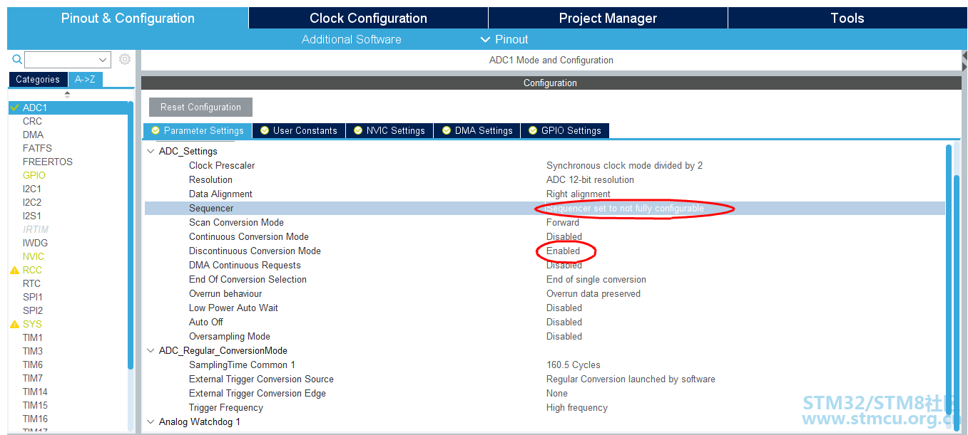

Sequencer选项选择为:Sequencer not fully configurable
如果是多通道则Discontinuous Conversion Mode要使能
