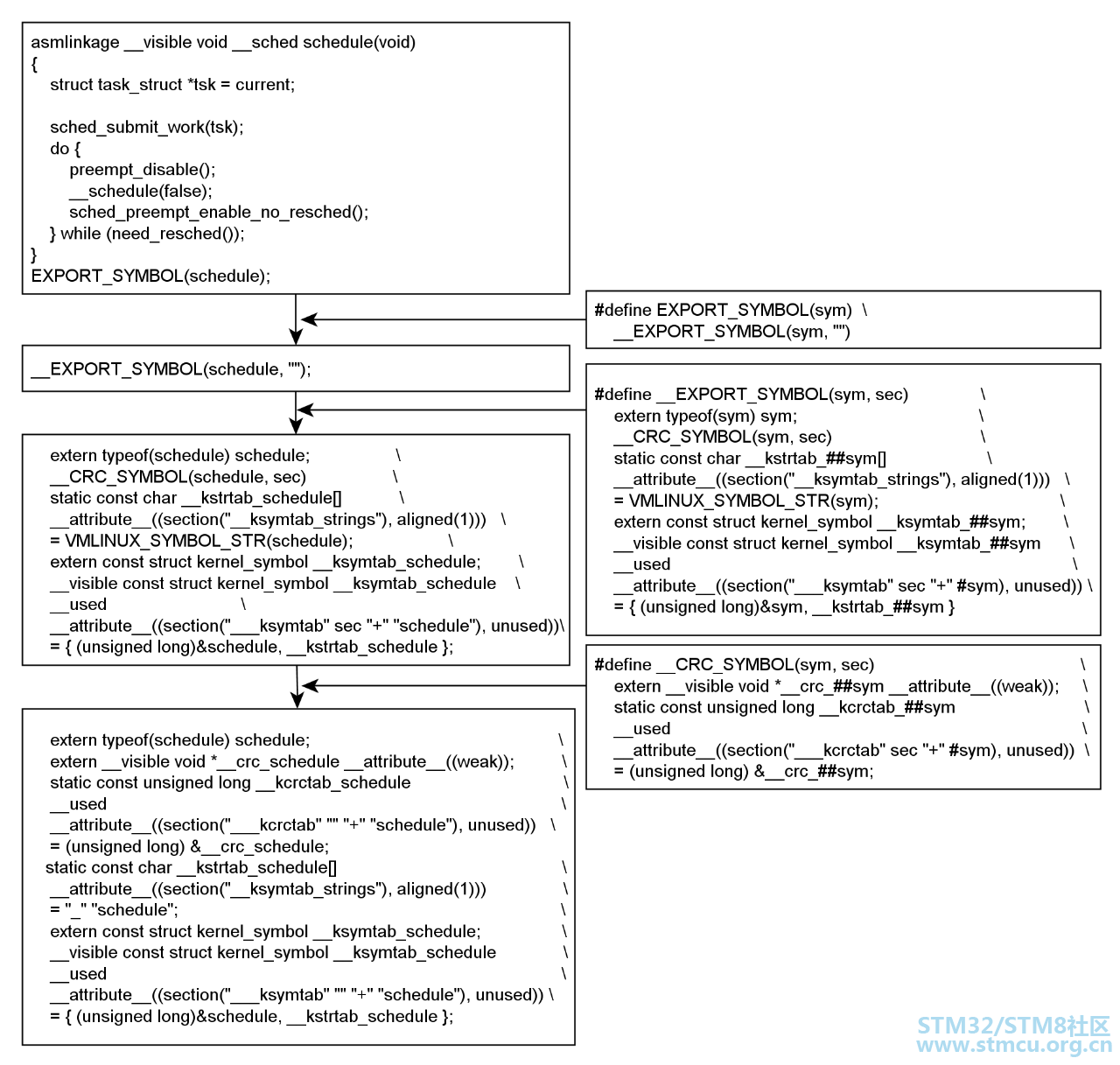

前情提要
《阅读内核系列之EXPORT_SYMBOL展开》将EXPORT_SYMBOL(schedule)展开:
asmlinkage __visible void __sched schedule(void)5 k4 D) y% |' e6 |
3 o) ^/ \4 [- c6 @* Y% u- { struct task_struct *tsk = current;
) P- X2 r9 L% Y, J+ h# l6 H    2 J0 w1 t% P6 Z- T
sched_submit_work(tsk);
' ~: O- m/ p+ c( V; I, @ do {
; P& o) y3 @5 C+ p  K  preempt_disable();
) Q- U6 ~8 p! \8 v3 i. e+ T* B; l  __schedule(false);' y' I( k; ^( u. A2 g
  sched_preempt_enable_no_resched();
) x$ A. G0 V. s- t  z" A } while (need_resched());, d2 R) a* r% M0 r2 X% x
$ k$ g# j  ~7 k- c' }; r+ o/ DEXPORT_SYMBOL(schedule);
: q6 E$ E+ ]1 v- b
全部展开后,得到了什么呢(前文中__EXPORT_SYMBOL(sym, sec)  sec弄错了,修正如下)?
    extern typeof(schedule) schedule;                                    \
8 J6 G8 I7 @' u! P/ T  X4 d$ {    extern __visible void *__crc_schedule __attribute__((weak));         \
, r' F8 Z9 h- r; p% }9 h1 ]: V    static const unsigned long __kcrctab_schedule                        \
% d' t% H% Y) b( |& w    __used                                                               \( t& B8 ^& H9 i* \
    __attribute__((section("___kcrctab" "" "+" "schedule"), unused))     \
; F; }+ e% v6 n" q3 _    = (unsigned long) &__crc_schedule;      % p* h' S0 ]* y. S
   static const char __kstrtab_schedule[]                                \) A: F2 V9 g6 H/ @" q4 H
    __attribute__((section("__ksymtab_strings"), aligned(1)))            \. Q8 p  ?& k! ]1 f
    = "_" "schedule";                                                    \
0 I+ {% }+ z6 f+ }3 ^+ u    extern const struct kernel_symbol __ksymtab_schedule;                \# {& k4 z$ y: V
    __visible const struct kernel_symbol __ksymtab_schedule              \: M# }& @  n  C0 ?
    __used                                                               \
) k' ?5 x7 J$ P" @' t6 A    __attribute__((section("___ksymtab" "" "+" "schedule"), unused))     \
- H7 `$ h+ b! C5 H6 f8 Y    = {
(unsigned long)&schedule, __kstrtab_schedule };
2 I7 h" t- P2 t
这样还是不直观,去掉不必要的换行符,整理一下:
6 t# q/ W- G. o0 N3 l{5 A* j9 W* n! Y% L9 c. E
7 k5 g7 K# B) h' b$ j, b! p7 G    ; g3 J6 |9 S4 b2 ^
4 s3 c' E. y5 [ do {/ t' k! r9 a! k; o* \! X3 @
  preempt_disable();: G, u2 d) p+ |) m% I& d
  __schedule(false);) l1 M( v$ j) v: @
, d& S! u3 ^. o0 |# n2 c2 p } while (need_resched());
3 {5 t$ ~( A% m* B}
- A8 j' a4 T( R7 _/*以下部分都属于EXPORT_SYMBOL(schedule)的展开*/% Y. r) O' C1 P8 E
extern typeof(schedule) schedule;6 R8 l9 ?+ {6 o  s" O
extern __visible void *__crc_schedule __attribute__((weak));( u% }5 K9 E5 T  y/ V
& l. Y  D4 p; }. n. \7 ~
static const unsigned long __kcrctab_schedule __used                 \: t6 C& W4 K- k/ F, y
__attribute__((section("___kcrctab+schedule"), unused))    \
: G! s* S# z" M= (unsigned long) &__crc_schedule;
* A8 l' _7 I* N8 H" f" B/ r; ~! m0 w( ~- I% Y
static const char __kstrtab_schedule[] __attribute__((section("__ksymtab_strings"), aligned(1)))  = "_" "schedule";
; W6 G* s" M9 n& R+ ~! }4 ?, X0 \! {, P$ W( Y
5 n) }6 n! g9 t8 G( D% g7 _5 i
& ^- U8 ]! E+ J& Z8 g, m& W__visible const struct kernel_symbol __ksymtab_schedule __used __attribute__((section("___ksymtab" "" "+" "schedule"), unused)) = {
5 }/ a/ y+ m# d7 y    (unsigned long)&schedule, __kstrtab_schedule ! U. \. b4 s9 z$ o% R+ o+ M) m8 A

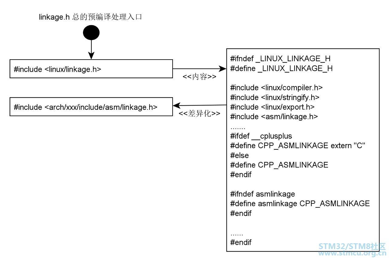

  • asmlinkage,其一:用于指定函数的参数都栈中,而不应在寄存器中;其二,指定一个函数为asmlinkage,则汇编代码中可以调用该函数。参考http://kernelnewbies.org/FAQ/asmlinkage
  • 阅读Linux内核代码,发现大量的文件名同名,如不理清其内在机理,这很让人头脑发胀。这里以linkage.h为例来探讨一下。
    看到有博文说asmlinkage其根源如下:
    #define asmlinkage CPP_ASMLINKAGE __attribute__((regparm(0))); w5 ]/ {+ w  t* w
    但仔细查看代码,这仅仅是对x86体系而言,而比如针对IA64(英特尔安腾架构(Intel Itanium architecture))而言:
    #define asmlinkage CPP_ASMLINKAGE __attribute__((syscall_linkage))
    / ?3 S% l: d8 B& F, h
    所以不同的体系结构为实现前述目的是有差异的。

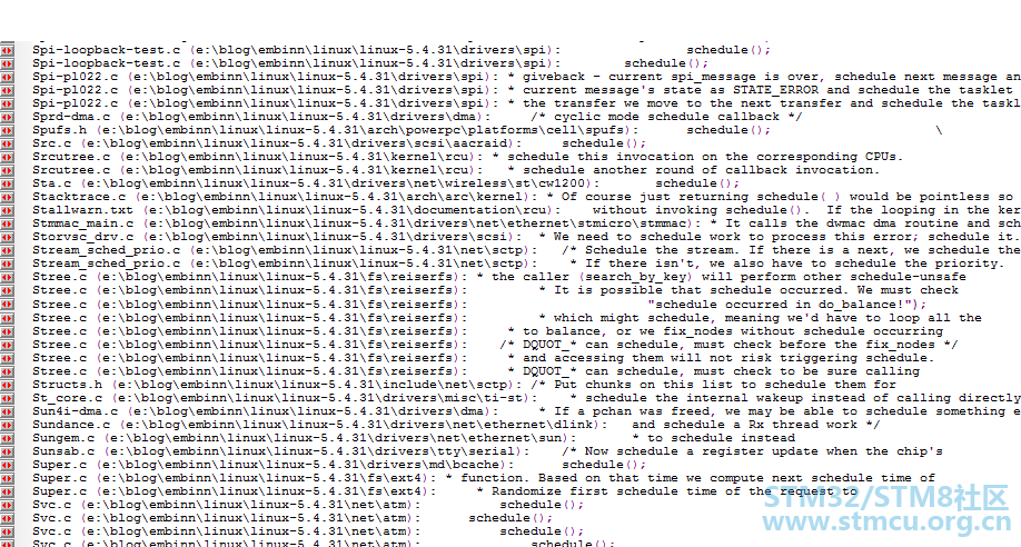

为何将主调度器全局导出
至此,调度对外导出就基本明晰了,但是进一步引申思考?为什么还要将调度器schedule以模块形式对外导出呢?EXPORT_SYMBOL对外导出,那么导出的作用域究竟多大呢,所包住的函数在内核代码中全局可见,也就意味着其他的内核模块可以使用该函数。但是貌似还是没有回答说为啥要将调度器对外导出,潜意识我们会认为调度器直接在后台像个勤劳的大管家,在哪里不停的忙活就完了,难不成其他模块还要主动去调用调度器不成。为了验证猜想,搜一下吧:
看来猜想没错,事实上:schedule就是主调度器的函数, 在内核中的许多地方, 如果要将CPU分配给与当前活动进程不同的另一个进程, 都会直接主动调用主调度器函数schedule.该函数完成如下工作:
  • 确定当前就绪队列, 并在保存一个指向当前(仍然)活动进程的task_struct指针;
  • 检查死锁, 关闭内核抢占后调用__schedule完成内核调度;
