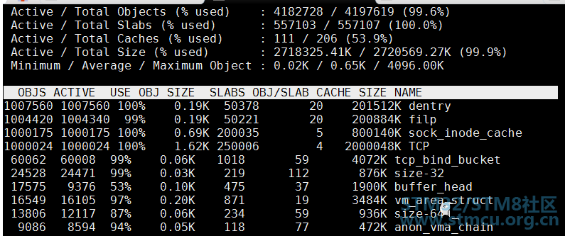

+ |9 k, q4 j; d1 W$ d, w# ss -ant | grep ESTAB |wc -l# q  t( y( O% }6 k9 ]
1000013: {* [; ?- J5 m
; H  L0 g+ |5 p
# cat /proc/meminfo
( q' L' Q/ R4 R! NMemTotal:        3925408 kB
7 y/ O9 C! `: w+ R/ {MemFree:           97748 kB
1 |1 B" x6 k9 cBuffers:           35412 kB
8 a; B6 p2 Y' V9 L5 I' @0 i! xCached:           119600 kB
) K  b1 i8 Y( p, e7 y4 @......
4 H" |9 g& c5 ?7 P+ E+ oSlab:            3241528 kB
: J2 N5 K0 u4 m
