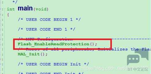

1.在main函数中加入启用读保护功能。2 n( `  j+ J8 M4 s/ V( O  q
  M5 M3 P( M" s. ~# A
: K1 J6 ]# P, R
" h- V, d0 U1 p- Y! ~! J. L

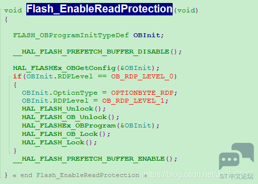

2.读保护函数! i, L& u: `+ y" @. u5 i, V0 C0 L
( L  d- U, z9 {& O) x$ s5 y  `9 o8 p4 }  K2 E) V$ r
7 I* @, L9 s; R* z" O4 D; h
3 S8 v+ y' @7 [$ Q  U7 E6 P8 b. B
1 ^% O, @) [( ~' r. n
  1. int main(void)
    / t8 W" N6 d- B; Y: h
  2. {
    4 t  `" l7 N% w! Z) F; I3 e( C4 H& f
  3. Flash_EnableReadProtection();+ T1 m8 _- y; c( t/ v4 N! d$ c
  4. While(1)
    9 A( F+ r& l2 R& R
  5. {
    8 T/ s2 S; W1 V6 W1 X
  6. 7 l5 S+ z9 c6 Y: K# n, P1 e9 ]
  7. }
    6 l; r5 g+ f  L0 J# ^8 ]; ^! N* q
  8. }  \% s" o# ~. ]' I7 B0 V
  9. - \8 b3 s+ z6 q9 ?
  10. void Flash_EnableReadProtection(void)+ D' t  n7 J/ {8 V1 m' C/ I- C6 H
  11. {3 x* A! U. q0 z. h1 _$ h$ _
  12. 2 @  c/ A- A) @& ^9 b* u. y
  13.   FLASH_OBProgramInitTypeDef OBInit;9 A% C# B2 |4 i# @2 y" e: u6 i
  14. + F$ n& H& ]! m
  15.   __HAL_FLASH_PREFETCH_BUFFER_DISABLE();" B2 B  y: D& U% M+ r4 P
  16. 3 G  t4 g/ y' k! O9 p2 A3 d$ q; D
  17.   HAL_FLASHEx_OBGetConfig(&OBInit);) d& N" B. u- h% ]* A9 n( [
  18.   if(OBInit.RDPLevel == OB_RDP_LEVEL_0)* t/ x  t  W2 l  x+ `
  19.   {& z* W; @8 d! Q6 ^  M
  20.     OBInit.OptionType = OPTIONBYTE_RDP;
    / c8 b4 f0 d7 P* t
  21.     OBInit.RDPLevel = OB_RDP_LEVEL_1;
      ?+ K; Y( z- s: x" U2 I# s
  22.     HAL_FLASH_Unlock();
    % a2 X4 h& D5 _5 c; n& h
  23.     HAL_FLASH_OB_Unlock();3 R" X3 L5 V4 a( M0 ^5 O9 {( m+ k- I
  24.     HAL_FLASHEx_OBProgram(&OBInit);" N! \' l" r& B0 O4 I8 t
  25.     HAL_FLASH_OB_Lock();
    " p; f+ i3 y+ \
  26.     HAL_FLASH_Lock();8 e, d$ g/ K: s6 S, K
  27.   }
    % q! y" e0 g* w9 h
  28.   __HAL_FLASH_PREFETCH_BUFFER_ENABLE();
      l9 V% h* v* C* M
  29. 0 K# L! a6 F3 Z7 T% E
  30. }
    ; A: l$ m; e4 m& U; H- q  s
  31. & I- `; {$ D" j$ R( D6 n& G
  32. void Flash_DisableReadProtection(void)! X$ P6 q1 v" l: [3 ]$ W
  33. {
    # \" E" A! f$ n! S; `: z2 L
  34. " B: E$ U% \- k% T! w- q
  35.   FLASH_OBProgramInitTypeDef OBInit;8 L, p4 ^/ |' C; q
  36. $ }, a, `* C% `; K2 O
  37.   __HAL_FLASH_PREFETCH_BUFFER_DISABLE();! L- V3 B$ d# o- l* v
  38. . ~  B7 N5 J1 _4 f3 d* h4 r. Z
  39.   HAL_FLASHEx_OBGetConfig(&OBInit);3 F2 k. L4 e% X. i$ F. D
  40.   if(OBInit.RDPLevel == OB_RDP_LEVEL_1)/ s' U* k- P* g% L
  41.   {
    8 Z9 v  P2 f7 Q: T& r. j  s
  42.     OBInit.OptionType = OPTIONBYTE_RDP;7 x  Z9 d' m, q' |
  43.     OBInit.RDPLevel = OB_RDP_LEVEL_0;
    - e7 [9 @% [( t% M* b; N
  44.     HAL_FLASH_Unlock();
    8 w5 _/ }. t. _! o: _$ q4 R
  45.     HAL_FLASH_OB_Unlock();
    ! B; X2 Z) i5 V
  46.     HAL_FLASHEx_OBProgram(&OBInit);
    . I: P  A7 s; u
  47.     HAL_FLASH_OB_Lock();: E3 f0 c# j) O
  48.     HAL_FLASH_Lock();2 D2 r9 D9 U: x% e9 z  K! _
  49.   }
    % Q/ k3 `% l$ {
  50.   __HAL_FLASH_PREFETCH_BUFFER_ENABLE();$ G1 `; Y, `0 C& R5 Z
  51. & W7 Q* x% \% g$ ?% d# S  g
  52. }9 U$ L: \( B& l$ o; C
