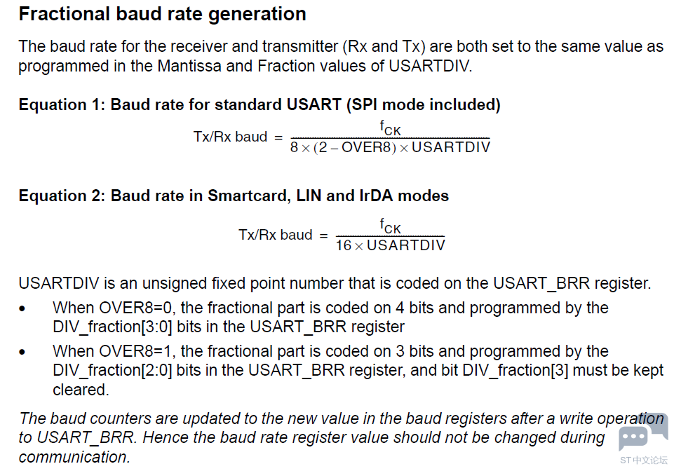

The baud rate for the receiver and transmitter (Rx and Tx) are both set to the same value
as programmed in the Mantissa and Fraction values of USARTDIV.

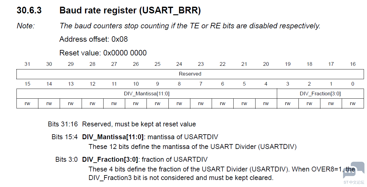

从上图可以看出,该寄存器高 16 位无效,最低 4 位为小数部分,其余部分为整数部分。
这样的设计可以使波特率更加精确。关于波特率的产生,有这么一段话来解释:
分数波特率的产生:  接收器和发送器(RX和TX)都是设置成为 USARTDIV 整数和小数寄存器中配置的值。
This give the following equation for baud rate:
Tx/Rx baud = CK_APB1 / (8 x (2 - OVER8) x USARTDIV)
Where USARTDIV is an unsigned fixed point number that is coded on the USART_BRR register.
  • When OVER8=0, the fractional part is coded on 4 bits and programmed by the DIV_fraction[3:0] bits in the USART_BRR register
  • Tx/Rx baud = CK_APB1 / (16 x USARTDIV)
  • When OVER8=1, the fractional part is coded on 3 bits and programmed by the DIV_fraction[2:0] bits in the USART_BRR register,
    , A1 {8 P7 c6 n% p# e+ h# X* U& Uand bit DIV_fraction[3] must be kept cleared.
  • Tx/Rx baud = CK_APB1 / (8  x USARTDIV)& n3 a8 _* V2 H- S. Q6 z3 [
The baud counters are updated to the new value in the baud registers after a write operation to USART_BRR.
Hence the baud rate register value should not be changed during communication.
