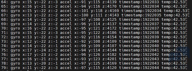

正常数据如下:
normal
normal

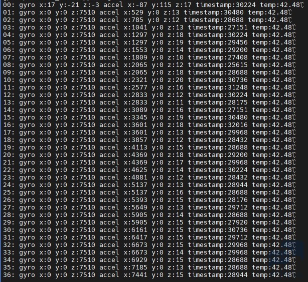

错误数据如下:
abnormal
abnormal

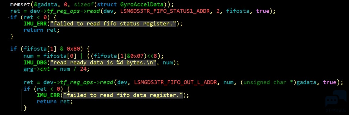

相关代码如下:
core
core

Twelve 最优答案 回答时间:2022-6-8 09:43:00
  • Read water mark
  • Disable fifo stop on threshold
  • Read fifo length L.
  • Read first date pattern
  • If (pattern == 0 )  go to G
  • If (pattern!=0) , read data from pattern number to 8 (maximum pattern number in you configure -three sensor), EX, first pattern is 3 , you should read data bytes of  (8-3+1)*2 ,and discard all these fifo data.   Re-caculate the number of date left in fifo , L_left ,             U16 (L_left/8)
  • Read fifo data u16(L or L_left/8)
  • Enable stop on fifo threshold
