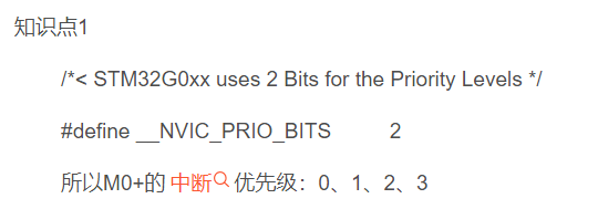

知识点1
7 _9 t* u" _% d0 k
4 ~3 P, M: b1 I4 E& ^        /*< STM32G0xx uses 2 Bits for the Priority Levels */
" I( ~4 Z" ~! T* o  a0 g0 c2 `' r9 O% o3 T' h
        #define __NVIC_PRIO_BITS          2 4 f! W% F* E) M3 u
# i  E3 {# R8 K0 p0 M; D" n
        所以M0+的中断优先级:0、1、2、3
