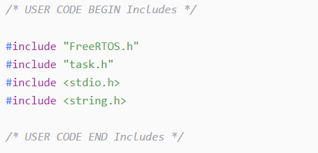

1.创建好带有printf-stdarg.c的FreeRTOS的工程
1 w% J Y- f7 x( y4 {& o1 u) b% S Y0 i6 }& c
2.修改main.c文件$ J" N6 P$ n- C/ \% M! N
, X) p3 `" b8 E, K- s# e9 W- /* USER CODE BEGIN Includes */
) g& T+ \: _9 M+ O8 o
$ I2 [& t" o1 ?) R5 P& j$ n- O6 t- #include "FreeRTOS.h"% }% d: {* m- l" }3 u3 s
- #include "task.h"
* z' F0 Q$ N; P t# G! r1 n' z9 R - #include "timers.h"' m& Y, d/ k( u
- #include <stdio.h>
7 S: G' p1 n! @ - #include <string.h>
( d. D6 b( e5 k; i5 T- H
! {' H' B( v) f; u! V' S- /* USER CODE END Includes */
