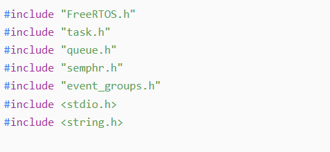

  1. /* USER CODE BEGIN Includes */6 M# r1 F, D0 b
  2. 0 x3 E: x' }2 P0 I! S
  3. #include "FreeRTOS.h": |' x( O7 W7 T/ G% C, E" ~# S6 j
  4. #include "task.h"
    ) {' P- O1 e7 j) U
  5. #include "queue.h"( }/ E: n. M+ ^( n2 x
  6. #include "semphr.h"/ U  z4 A) }3 w' Y( }7 f4 k
  7. #include "event_groups.h"6 c+ h; A% \0 @; y3 u6 y
  8. #include <stdio.h>
    4 f7 i% i- D, m, f" J
  9. #include <string.h>+ v' c. {" }8 ^% C- Y$ g
  10. * x  p3 _* C7 A7 T$ \- {) n
