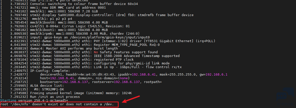

复制代码 二、挂载rootfs的报错信息提示:
- <font _mstmutation="1">[ 3.819621] input: gpio-keys as /devices/platform/gpio-keys/input/input0
- [ 4.032391] stm32-dwmac 5800e000.eth2 eth1: PHY [stmmac-1:02] driver [YT8531 Gigabit Ethernet] (irq=POLL)
- [ 4.041360] stm32-dwmac 5800e000.eth2 eth1: Register MEM_TYPE_PAGE_POOL RxQ-0
- [ 4.058819] dwmac4: Master AXI performs any burst length
- [ 4.063037] stm32-dwmac 5800e000.eth2 eth1: No Safety Features support found
- [ 4.069876] stm32-dwmac 5800e000.eth2 eth1: IEEE 1588-2008 Advanced Timestamp supported
- [ 4.078104] stm32-dwmac 5800e000.eth2 eth1: registered PTP clock
- [ 4.084254] stm32-dwmac 5800e000.eth2 eth1: configuring for phy/rgmii-id link mode
- [ 7.203445] stm32-dwmac 5800e000.eth2 eth1: Link is Up - 1Gbps/Full - flow control rx/tx
- [ 7.240975] IP-Config: Complete:
- [ 7.242877] device=eth1, hwaddr=4e:a4:35:d9:43:43, ipaddr=192.168.6.41, mask=255.255.255.0, gw=192.168.6.1
- [ 7.253214] host=192.168.6.41, domain=, nis-domain=(none)
- [ 7.258715] bootserver=192.168.6.137, rootserver=192.168.6.137, rootpath=
- [ 7.259905] ALSA device list:
- [ 7.269135] #0: STM32MP1-DK
- [ 7.274588] Freeing unused kernel image (initmem) memory: 1024K
- [ 7.291232] Run /init as init process
- Starting version 250.4-1-gc3aead5+
- root '/dev/nfs' doesn't exist or does not contain a /dev.</font>

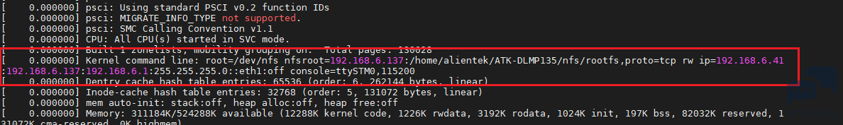

- [ 0.000000] Kernel command line: root=/dev/nfs nfsroot=192.168.6.137:/home/alientek/ATK-DLMP135/nfs/rootfs,proto=tcp rw ip=192.168.6.41 :192.168.6.137:192.168.6.1:255.255.255.0::eth1:off console=ttySTM0,115200

- [ 0.151310] RPC: Registered tcp NFSv4.1 backchannel transport module.
- [ 0.151695] hw perfevents: enabled with armv7_cortex_a7 PMU driver, 5 counters available
- [ 0.153103] Initialise system trusted keyrings
- [ 0.153559] workingset: timestamp_bits=14 max_order=17 bucket_order=3
- [ 0.160277] squashfs: version 4.0 (2009/01/31) Phillip Lougher
- [ 0.161158] Trying to unpack rootfs image as initramfs...
- [ 0.181569] NFS: Registering the id_resolver key type
- [ 0.181632] Key type id_resolver registered
- [ 0.181644] Key type id_legacy registered
- [ 0.181779] nfs4filelayout_init: NFSv4 File Layout Driver Registering...
- [ 0.181810] nfs4flexfilelayout_init: NFSv4 Flexfile Layout Driver Registering...
- [ 0.181820] Installing knfsd (copyright (C) 1996 okir@monad.swb.de).
- [ 0.182628] ntfs: driver 2.1.32 [Flags: R/O].
- [ 0.182864] jffs2: version 2.2. (NAND) © 2001-2006 Red Hat, Inc.
- [ 0.191247] fuse: init (API version 7.34)
- [ 0.192170] NET: Registered PF_ALG protocol family
- [ 0.192210] Key type asymmetric registered
- [ 0.192221] Asymmetric key parser 'x509' registered
- [ 0.192343] bounce: pool size: 64 pages
- [ 0.192422] Block layer SCSI generic (bsg) driver version 0.4 loaded (major 247)
- [ 0.192439] io scheduler mq-deadline registered
- [ 0.192450] io scheduler kyber registered
- [ 0.203196] STM32 USART driver initialized
- [ 0.264477] brd: module loaded
- [ 0.281713] loop: module loaded
- [ 0.285636] CAN device driver interface
- [ 0.286899] PPP generic driver version 2.4.2
- [ 0.301048] PPP BSD Compression module registered
- [ 0.301076] PPP Deflate Compression module registered
- [ 0.301096] PPP MPPE Compression module registered
- [ 0.301107] NET: Registered PF_PPPOX protocol family
- [ 0.301223] GobiNet: Quectel_Linux&Android_GobiNet_Driver_V1.6.1
- [ 0.301308] usbcore: registered new interface driver GobiNet
- [ 0.302083] ehci_hcd: USB 2.0 'Enhanced' Host Controller (EHCI) Driver
- [ 0.302140] ehci-platform: EHCI generic platform driver
- [ 0.302345] ohci_hcd: USB 1.1 'Open' Host Controller (OHCI) Driver
- [ 0.302382] ohci-platform: OHCI generic platform driver
- [ 0.302956] usbcore: registered new interface driver cdc_acm
- [ 0.302976] cdc_acm: USB Abstract Control Model driver for USB modems and ISDN adapters
- [ 0.303043] usbcore: registered new interface driver usb-storage
- [ 0.303164] usbcore: registered new interface driver usbserial_generic
- [ 0.303209] usbserial: USB Serial support registered for generic
- [ 0.303252] usbcore: registered new interface driver option
- [ 0.303283] usbserial: USB Serial support registered for GSM modem (1-port)
- [ 0.303837] i2c_dev: i2c /dev entries driver
- [ 0.311140] device-mapper: ioctl: 4.45.0-ioctl (2021-03-22) initialised: dm-devel@redhat.com
- [ 0.311714] stm32-cpufreq stm32-cpufreq: OPP-v2 not supported
- [ 0.312552] sdhci: Secure Digital Host Controller Interface driver
- [ 0.312578] sdhci: Copyright(c) Pierre Ossman
- [ 0.312586] Synopsys Designware Multimedia Card Interface Driver
- [ 0.312937] sdhci-pltfm: SDHCI platform and OF driver helper
- [ 0.313808] ledtrig-cpu: registered to indicate activity on CPUs
- [ 0.314282] usbcore: registered new interface driver usbhid
- [ 0.314306] usbhid: USB HID core driver
- [ 0.316564] optee: probing for conduit method.
- [ 0.316610] optee: revision 3.16 (72845af2)
- [ 0.341612] optee: Asynchronous notifications enabled
- [ 0.341659] optee: dynamic shared memory is enabled
- [ 0.343535] optee: initialized driver
- [ 0.345793] random: fast init done
- [ 0.349820] NET: Registered PF_PACKET protocol family
- [ 0.349876] can: controller area network core
- [ 0.349967] NET: Registered PF_CAN protocol family
- [ 0.349986] can: raw protocol
- [ 0.349999] can: broadcast manager protocol
- [ 0.350014] can: netlink gateway - max_hops=1
- [ 0.350457] random: crng init done
- [ 0.355917] Key type dns_resolver registered
- [ 0.356034] ThumbEE CPU extension supported.
- [ 0.356063] Registering SWP/SWPB emulation handler
- [ 0.356482] registered taskstats version 1
- [ 0.356518] Loading compiled-in X.509 certificates
- [ 0.360886] arm-scmi firmware:scmi: SCMI Notifications - Core Enabled.
- [ 0.361187] arm-scmi firmware:scmi: SCMI Protocol v2.0 'ST:' Firmware version 0x0
- [ 0.411760] scmi-regulator scmi_dev.4: Regulator reg11 registered for domain [0]
- [ 0.412109] scmi-regulator scmi_dev.4: Regulator reg18 registered for domain [1]
- [ 0.412430] scmi-regulator scmi_dev.4: Regulator usb33 registered for domain [2]
- [ 0.458291] stm32mp135-pinctrl soc:pin-controller@50002000: GPIOA bank added
- [ 0.458963] stm32mp135-pinctrl soc:pin-controller@50002000: GPIOB bank added
- [ 0.459630] stm32mp135-pinctrl soc:pin-controller@50002000: GPIOC bank added
- [ 0.461424] stm32mp135-pinctrl soc:pin-controller@50002000: GPIOD bank added
- [ 0.462114] stm32mp135-pinctrl soc:pin-controller@50002000: GPIOE bank added
- [ 0.471441] stm32mp135-pinctrl soc:pin-controller@50002000: GPIOF bank added
- [ 0.481536] stm32mp135-pinctrl soc:pin-controller@50002000: GPIOG bank added
- [ 0.482268] stm32mp135-pinctrl soc:pin-controller@50002000: GPIOH bank added
- [ 0.482953] stm32mp135-pinctrl soc:pin-controller@50002000: GPIOI bank added
- [ 0.483028] stm32mp135-pinctrl soc:pin-controller@50002000: Pinctrl STM32 initialized
- [ 0.486026] stm32-mdma 58000000.dma-controller: STM32 MDMA driver registered
- [ 0.488189] stm32-usbphyc 5a006000.usbphyc: registered rev:1.0
- [ 0.501029] stm32-dma 48000000.dma-controller: STM32 DMA driver registered
- [ 0.511126] stm32-dma 48001000.dma-controller: STM32 DMA driver registered
- [ 0.512110] stm32-usart 40010000.serial: interrupt mode for rx (no dma)
- [ 0.512143] stm32-usart 40010000.serial: interrupt mode for tx (no dma)
- [ 0.512173] 40010000.serial: ttySTM0 at MMIO 0x40010000 (irq = 61, base_baud = 4000000) is a stm32-usart
- [ 1.085032] Freeing initrd memory: 4484K
- [ 2.652750] printk: console [ttySTM0] enabled
- [ 2.659960] stm32-usart 4c001000.serial: interrupt mode for rx (no dma)
- [ 2.665256] stm32-usart 4c001000.serial: interrupt mode for tx (no dma)
- [ 2.671880] 4c001000.serial: ttySTM1 at MMIO 0x4c001000 (irq = 63, base_baud = 4000000) is a stm32-usart
- [ 2.689128] m_can_platform 4400e000.can: m_can device registered (irq=51, version=32)
- [ 2.697207] m_can_platform 4400f000.can: m_can device registered (irq=53, version=32)
- [ 2.704898] stm32-dwmac 5800a000.eth1: IRQ eth_lpi not found
- [ 2.709719] stm32-dwmac 5800a000.eth1: PTP uses main clock
- [ 2.715594] stm32-dwmac 5800a000.eth1: User ID: 0x12, Synopsys ID: 0x42
- [ 2.721499] stm32-dwmac 5800a000.eth1: DWMAC4/5
- [ 2.725953] stm32-dwmac 5800a000.eth1: DMA HW capability register supported
- [ 2.732965] stm32-dwmac 5800a000.eth1: RX Checksum Offload Engine supported
- [ 2.739922] stm32-dwmac 5800a000.eth1: TX Checksum insertion supported
- [ 2.746445] stm32-dwmac 5800a000.eth1: Wake-Up On Lan supported
- [ 2.752440] stm32-dwmac 5800a000.eth1: TSO supported
- [ 2.757288] stm32-dwmac 5800a000.eth1: Enable RX Mitigation via HW Watchdog Timer
- [ 2.764779] stm32-dwmac 5800a000.eth1: device MAC address 4a:69:21:b1:09:22
- [ 2.771789] stm32-dwmac 5800a000.eth1: Enabled L3L4 Flow TC (entries=2)
- [ 2.778345] stm32-dwmac 5800a000.eth1: Enabled RFS Flow TC (entries=8)
- [ 2.784828] stm32-dwmac 5800a000.eth1: TSO feature enabled
- [ 2.790276] stm32-dwmac 5800a000.eth1: Using 32 bits DMA width
- [ 2.829188] stm32-dwmac 5800e000.eth2: IRQ eth_wake_irq not found
- [ 2.834011] stm32-dwmac 5800e000.eth2: IRQ eth_lpi not found
- [ 2.840248] stm32-dwmac 5800e000.eth2: PTP uses main clock
- [ 2.846088] stm32-dwmac 5800e000.eth2: User ID: 0x12, Synopsys ID: 0x42
- [ 2.851797] stm32-dwmac 5800e000.eth2: DWMAC4/5
- [ 2.856249] stm32-dwmac 5800e000.eth2: DMA HW capability register supported
- [ 2.863250] stm32-dwmac 5800e000.eth2: RX Checksum Offload Engine supported
- [ 2.870104] stm32-dwmac 5800e000.eth2: TX Checksum insertion supported
- [ 2.876708] stm32-dwmac 5800e000.eth2: Wake-Up On Lan supported
- [ 2.882682] stm32-dwmac 5800e000.eth2: TSO supported
- [ 2.887529] stm32-dwmac 5800e000.eth2: Enable RX Mitigation via HW Watchdog Timer
- [ 2.895028] stm32-dwmac 5800e000.eth2: device MAC address 4e:a4:35:d9:43:43
- [ 2.902041] stm32-dwmac 5800e000.eth2: Enabled L3L4 Flow TC (entries=2)
- [ 2.908597] stm32-dwmac 5800e000.eth2: Enabled RFS Flow TC (entries=8)
- [ 2.915068] stm32-dwmac 5800e000.eth2: TSO feature enabled
- [ 2.920514] stm32-dwmac 5800e000.eth2: Using 32 bits DMA width
- [ 2.958728] dwc2 49000000.usb-otg: supply vusb_d not found, using dummy regulator
- [ 2.965222] dwc2 49000000.usb-otg: supply vusb_a not found, using dummy regulator
- [ 3.108569] dwc2 49000000.usb-otg: EPs: 9, dedicated fifos, 952 entries in SPRAM
- [ 3.115986] dwc2 49000000.usb-otg: DWC OTG Controller
- [ 3.119702] dwc2 49000000.usb-otg: new USB bus registered, assigned bus number 1
- [ 3.127182] dwc2 49000000.usb-otg: irq 64, io mem 0x49000000
- [ 3.133950] hub 1-0:1.0: USB hub found
- [ 3.136452] hub 1-0:1.0: 1 port detected
- [ 3.142109] ehci-platform 5800d000.usbh-ehci: EHCI Host Controller
- [ 3.146902] ehci-platform 5800d000.usbh-ehci: new USB bus registered, assigned bus number 2
- [ 3.155922] ehci-platform 5800d000.usbh-ehci: irq 48, io mem 0x5800d000
- [ 3.190977] ehci-platform 5800d000.usbh-ehci: USB 2.0 started, EHCI 1.00
- [ 3.197285] hub 2-0:1.0: USB hub found
- [ 3.200086] hub 2-0:1.0: 2 ports detected
- [ 3.224845] at24 0-0050: supply vcc not found, using dummy regulator
- [ 3.230814] at24 0-0050: 8192 byte 24c64 EEPROM, writable, 32 bytes/write
- [ 3.242611] rtc-pcf8563 0-0051: registered as rtc0
- [ 3.247136] rtc-pcf8563 0-0051: setting system clock to 2024-10-17T09:01:11 UTC (1729155671)
- [ 3.256262] stm32f7-i2c 40012000.i2c: STM32F7 I2C-0 bus adapter
- [ 3.277547] Goodix-TS 1-0014: supply AVDD28 not found, using dummy regulator
- [ 3.283491] Goodix-TS 1-0014: supply VDDIO not found, using dummy regulator
- [ 3.401043] Goodix-TS 1-0014: i2c test failed attempt 1: -6
- [ 3.441020] Goodix-TS 1-0014: i2c test failed attempt 2: -6
- [ 3.480961] Goodix-TS 1-0014: I2C communication failure: -6
- [ 3.485986] i2c 1-003c: Fixing up cyclic dependency with 5a000000.dcmipp
- [ 3.491935] usb 2-1: new high-speed USB device number 2 using ehci-platform
- [ 3.499621] stm32f7-i2c 4c004000.i2c: STM32F7 I2C-1 bus adapter
- [ 3.507090] stm_thermal 50028000.thermal: stm_thermal_probe: Driver initialized successfully
- [ 3.518290] mmci-pl18x 58005000.mmc: allocated mmc-pwrseq
- [ 3.522953] mmci-pl18x 58005000.mmc: mmc0: PL180 manf 53 rev2 at 0x58005000 irq 44,0 (pio)
- [ 3.560033] mmci-pl18x 58007000.mmc: mmc1: PL180 manf 53 rev2 at 0x58007000 irq 45,0 (pio)
- [ 3.571670] mmci-pl18x 58005000.mmc: card claims to support voltages below defined range
- [ 3.592714] mmc0: new high speed SDIO card at address 0001
- [ 3.603083] platform 4400a004.audio-controller: Fixing up cyclic dependency with 0-004a
- [ 3.613182] platform 4400a024.audio-controller: Fixing up cyclic dependency with 0-004a
- [ 3.622891] st,stm32-i2s 44004000.audio-controller: No cache defaults, reading back from HW
- [ 3.634330] 40018000.serial: ttySTM2 at MMIO 0x40018000 (irq = 62, base_baud = 4000000) is a stm32-usart
- [ 3.646434] panel-simple panel-rgb: Specify missing connector_type
- [ 3.654135] spi-nor spi0.0: w25q128 (16384 Kbytes)
- [ 3.659559] spi_stm32 4c003000.spi: driver initialized
- [ 3.670462] st,stm32-i2s 44004000.audio-controller: No cache defaults, reading back from HW
- [ 3.681824] [drm] Initialized stm 1.0.0 20170330 for 5a001000.display-controller on minor 0
- [ 3.702576] hub 2-1:1.0: USB hub found
- [ 3.702811] hub 2-1:1.0: 4 ports detected
- [ 3.730162] Console: switching to colour frame buffer device 60x34
- [ 3.741721] mmc1: new DDR MMC card at address 0001
- [ 3.743102] mmcblk1: mmc1:0001 58A398 7.28 GiB
- [ 3.769749] stm32-display 5a001000.display-controller: [drm] fb0: stmdrmfb frame buffer device
- [ 3.781276] mmcblk1: p1 p2 p3 p4
- [ 3.785454] mmcblk1boot0: mmc1:0001 58A398 4.00 MiB
- [ 3.792661] cs42l51 0-004a: Cirrus Logic CS42L51, Revision: 01
- [ 3.798182] mmcblk1boot1: mmc1:0001 58A398 4.00 MiB
- [ 3.806530] mmcblk1rpmb: mmc1:0001 58A398 4.00 MiB, chardev (244:0)
- [ 3.819621] input: gpio-keys as /devices/platform/gpio-keys/input/input0
你好,可以参考这个wiki How to boot the kernel via TFTP from U-Boot - stm32mpu
