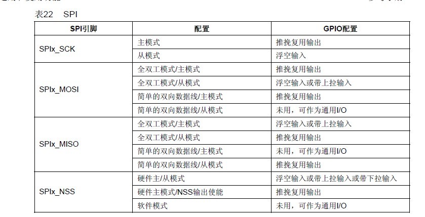

在官网上也没看见这样的手册 假如我要把IO口复用为SPI或I2S或USART模式时,该如何设置
GPIO_InitStructure.GPIO_Mode=GPIO_Mode_AF;
                GPIO_InitStructure.GPIO_OType=GPIO_OType_PP;
                GPIO_InitStructure.GPIO_Pin=GPIO_Pin_5|GPIO_Pin_7;
                GPIO_InitStructure.GPIO_PuPd=GPIO_PuPd_UP;
                GPIO_InitStructure.GPIO_Speed=GPIO_Speed_50MHz;这几个的值。STM32F1就有这样的手册,怎么STM32F030没看见

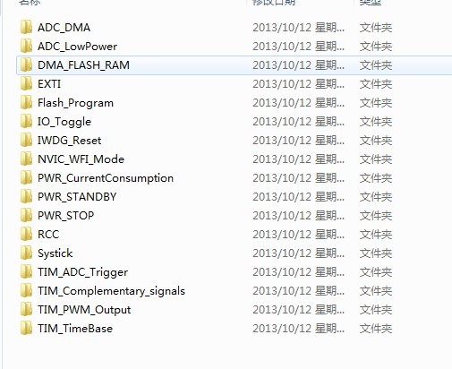

只有这几个例程的
