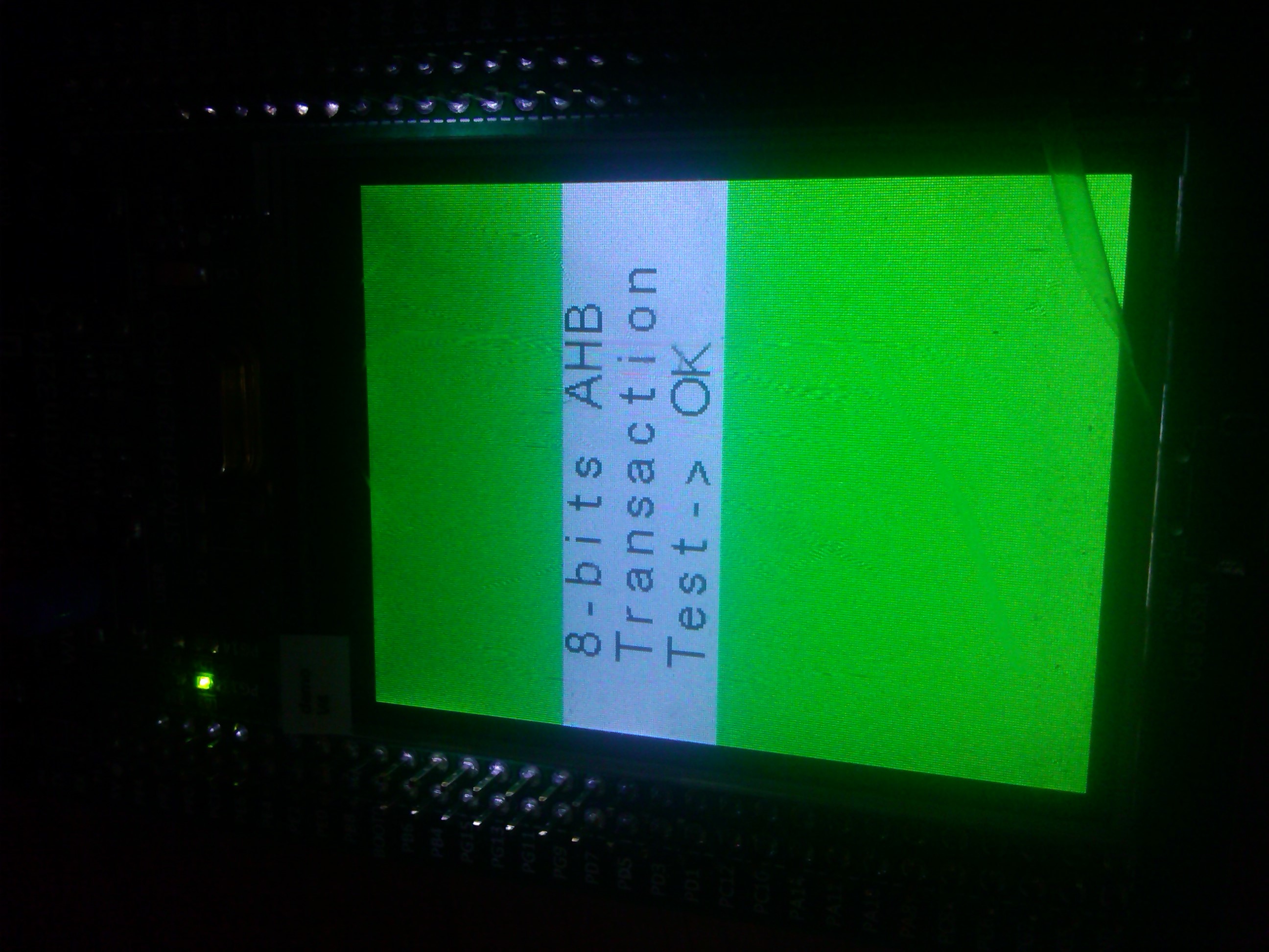

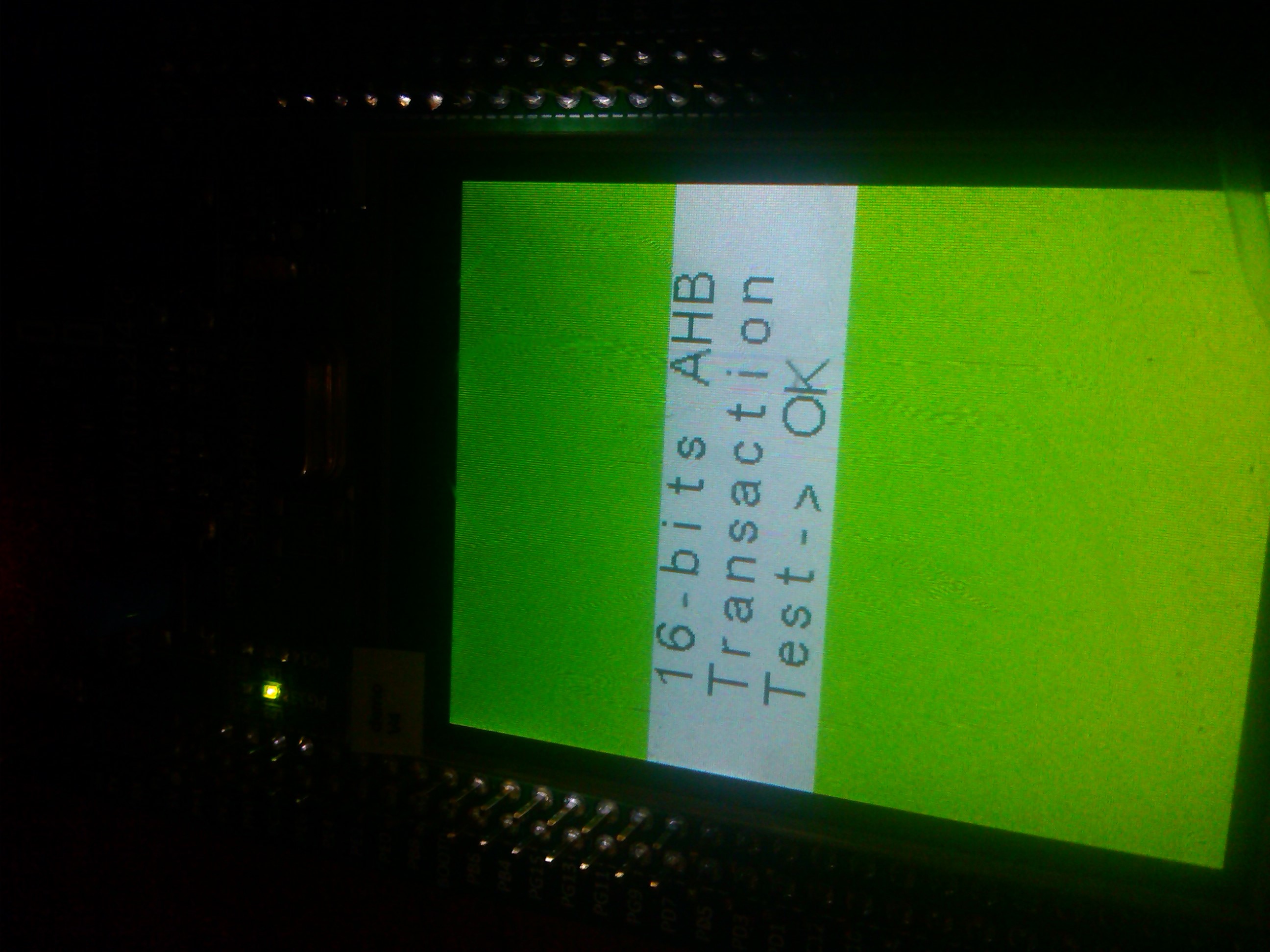

1.8Bit 测试成功率为100%,16Bit测试成功率为100%

                /*********************** 8-bits AHB transaction test ************************/
                /* Wait for User button to be pressed */
                while (STM_EVAL_PBGetState() != Bit_SET)
                STM_EVAL_LEDOff(LED3);
                STM_EVAL_LEDOff(LED4);
                /* Wait for User button is released */
                while (STM_EVAL_PBGetState() != Bit_RESET)
                /* Erase SDRAM memory */
                for (counter = 0x00; counter < IS42S16400J_SIZE; counter++)
                        *(__IO uint8_t*) (SDRAM_BANK_ADDR + counter) = (uint8_t)0x0;
                /* Write data value to all SDRAM memory */
                for (counter = 0; counter < IS42S16400J_SIZE; counter++)
                        *(__IO uint8_t*) (SDRAM_BANK_ADDR + counter) = (uint8_t)(ubWritedata_8b + counter);
                /* Read back SDRAM memory and check content correctness*/
                counter = 0;
                uwReadwritestatus = 0;
                while ((counter < IS42S16400J_SIZE) && (uwReadwritestatus == 0))
                        ubReaddata_8b = *(__IO uint8_t*)(SDRAM_BANK_ADDR + counter);
                        if ( ubReaddata_8b != (uint8_t)(ubWritedata_8b + counter))
                                uwReadwritestatus = 1;
                        counter++;
          if(uwReadwritestatus == 0)
                          STM_EVAL_LEDOn(LED3);
                                LCD_Clear(LCD_COLOR_GREEN);
                                LCD_DisplayStringLine(LCD_LINE_4, (uint8_t *)"  8-bits AHB    ");
                                LCD_DisplayStringLine(LCD_LINE_5, (uint8_t *)"  Transaction   ");
                                LCD_DisplayStringLine(LCD_LINE_6, (uint8_t *)"  Test-> OK     ");
                else
                    STM_EVAL_LEDOn(LED4);
                                LCD_Clear(LCD_COLOR_RED);
                                LCD_DisplayStringLine(LCD_LINE_6, (uint8_t *)"   Test-> Failed ");
                /*********************** 16-bits AHB transaction test ***********************/
                                /* Turn Off Leds */
                        *(__IO uint16_t*) (SDRAM_BANK_ADDR + 2*counter) = (uint16_t)0x00;
                        *(__IO uint16_t*) (SDRAM_BANK_ADDR + 2*counter) = (uint16_t)(uhWritedata_16b + counter);
                counter = 0;
                        uhReaddata_16b = *(__IO uint16_t*)(SDRAM_BANK_ADDR + 2*counter);
                        if ( uhReaddata_16b != (uint16_t)(uhWritedata_16b + counter))
                        counter++;
                        LCD_DisplayStringLine(LCD_LINE_4, (uint8_t *)"  16-bits AHB   ");
                else
16Bit数据测试:
8Bit数据测试:
