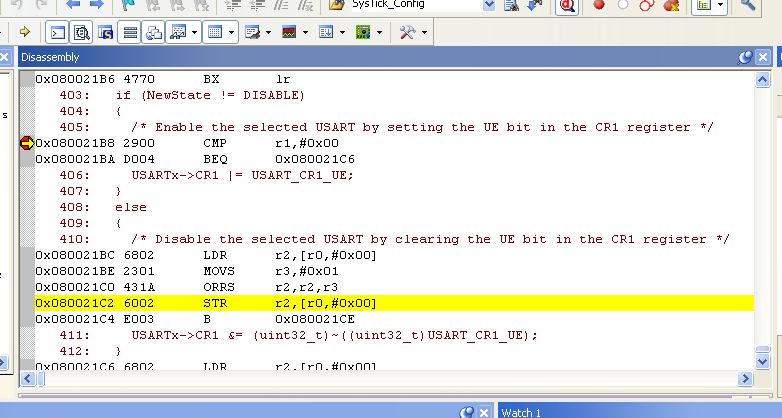

看汇编代码如下:
0x080021B6 4770      BX       lr
   403:   if (NewState != DISABLE)
   404:   {
   405:     /* Enable the selected USART by setting the UE bit in the CR1 register */
0x080021B8 2900      CMP      r1,#0x00
0x080021BA D004      BEQ      0x080021C6
   406:     USARTx->CR1 |= USART_CR1_UE;
   407:   }
   408:   else
   409:   {
   410:     /* Disable the selected USART by clearing the UE bit in the CR1 register */
0x080021BC 6802      LDR      r2,[r0,#0x00]
0x080021BE 2301      MOVS     r3,#0x01
0x080021C0 431A      ORRS     r2,r2,r3
0x080021C2 6002      STR      r2,[r0,#0x00]
0x080021C4 E003      B        0x080021CE
   411:     USARTx->CR1 &= (uint32_t)~((uint32_t)USART_CR1_UE);
   412:   }
0x080021C6 6802      LDR      r2,[r0,#0x00]
0x080021C8 0852      LSRS     r2,r2,#1
0x080021CA 0052      LSLS     r2,r2,#1
0x080021CC 6002      STR      r2,[r0,#0x00]
   413: }
haihuang-402384 回答时间:2014-12-18 18:21:23
安 发表于 2014-12-18 17:12
还是把你的配置代码发一下吧。
截图如下所示
