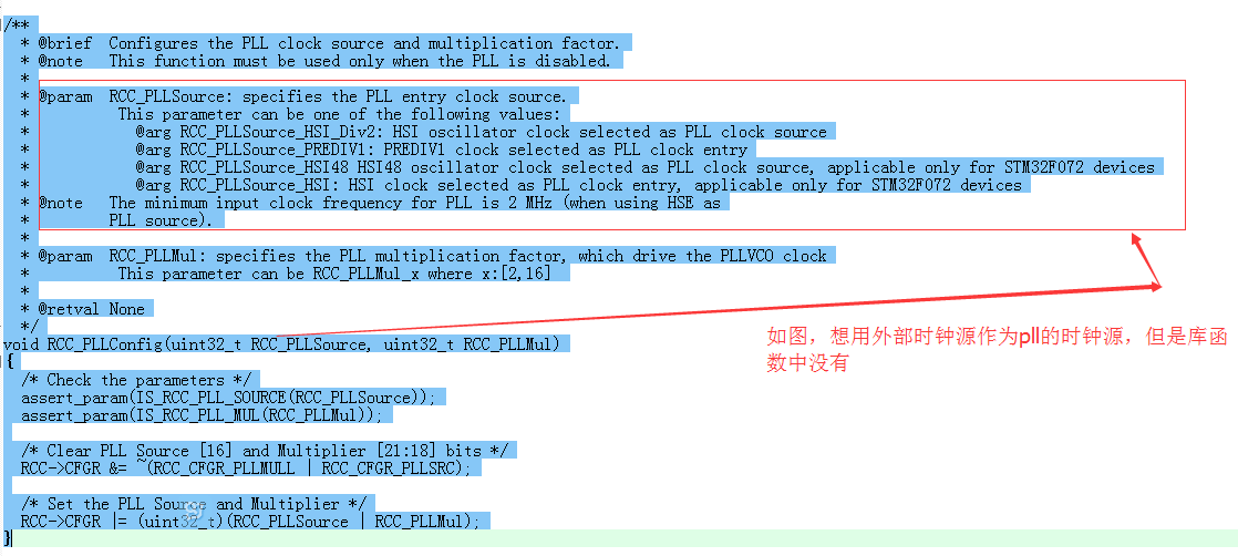

就是想知道,void RCC_PLLConfig(uint32_t RCC_PLLSource, uint32_t RCC_PLLMul);RCC_PLLSource这个参数要是选择为RCC_PLLSource_HSE_Div1作为时钟源,怎么办?void RCC_PLLConfig(uint32_t RCC_PLLSource, uint32_t RCC_PLLMul);库函数见附件

                RCC_PLLConfig(?, RCC_PLLMul_6);
                /* Enable PLL */
                RCC_PLLCmd(ENABLE);,当配置到这里RCC_PLLConfig(RCC_PLLSource_HSI, RCC_PLLMul_6);的时候,我想用外部高速时钟作为经锁相环倍频后用作系统时钟源,该怎么配置?

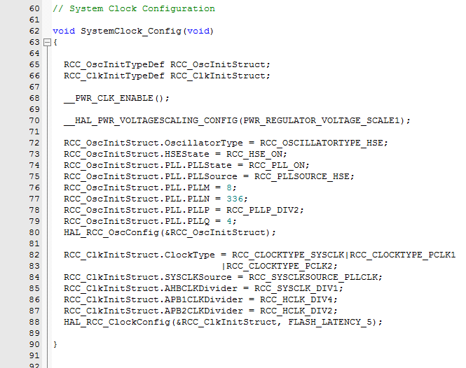

提供一个HAL库的初始化全程,供参考
