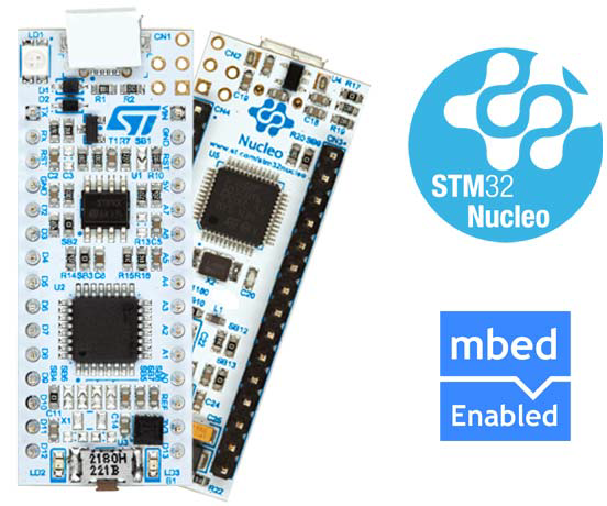

1.小身材* H# [2 C" E, V; ^( g* D
  与其大哥Nucleo64相比,抛弃了Arduino Uno接口,转而投向Arduino Nano的怀抱。小巧的身材上,处处体现着精致的美。虽然身材苗条了,但是依然集成了ST-Link调试接口,方便我们的日常开发和调试。/ K: @2 q9 v3 r1 e: {' i0 A
(下图中,左侧是主芯片STM32F042K6,右侧图是ST-Link调试芯片STM32F103)1 }+ S! ?3 `! J2 C4 @3 f2 @: w
; O) R2 L2 B9 ^$ q4 c

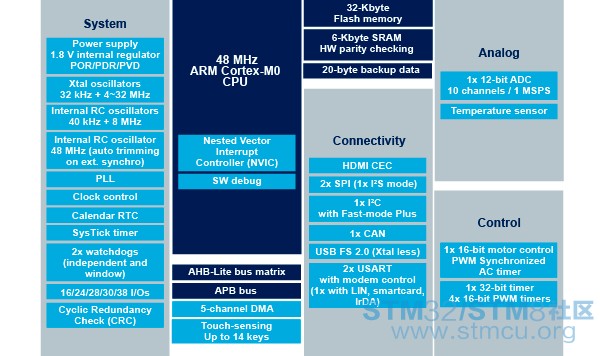

STM32F042K6从一出生就继承了其皇室血统,硬件资源丰富。
5 V  o# v4 Z) v' z# Z
" M- l% O, E' g2 W: c 在硬件通信接口上,不仅AD, USART, SPI, I2C, Timer等接口样样具备,更添加了USB全速接口,这款芯片也是STM32F0系列中为数不多的具有USB接口的芯片。在硬件USB的帮助下,游戏手柄,U盘这些小东西的制作自然不在话下。
& }: ?  I# K1 f. }. T' H/ o
; R5 g# F2 u2 w! B- j, J& i' P 如果细心查看文档,可以看到支持HDMI CEC协议。下面是一点关于CEC的简单介绍:来自elinux.org
, K/ i% e8 J5 ^
Consumer Electronics Control (CEC) is an HDMI feature designed to allow the user to command and control up to ten CEC-enabled devices connected through HDMI by using just one of their remote controls (for example by controlling a television set, set-top box, PVR/DVR, and DVD player using only the remote control of the TV). CEC also allows for individual CEC-enabled devices to command and control each other without user intervention.
4 s1 D" q. S! _HDMI-CEC is a one-wire bidirectional serial bus that uses the industry-standard AV.link protocol to perform remote control functions. CEC wiring is mandatory, although implementation of CEC in a product is optional. It was defined in HDMI Specification 1.0 and updated in HDMI 1.2, HDMI 1.2a and HDMI 1.3a (the last added timer and audio commands to the bus). USB to CEC Adapters exist that allow a computer to control CEC-enabled devices.
: _* M6 i6 Q: o简单的说,支持HDMI CEC协议的设备,如果多台设备(最多10台)之间通过HDMI信号线相互连接,那么只需使用其中一台设备的遥控器,就可以控制所有相连的设备。能够支持HDMI CEC,无疑扩展了F042的应用领域。

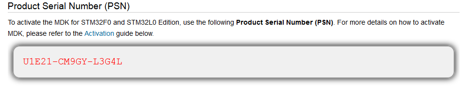

# }/ L# ?- {+ t8 \8 n- CST率先与Keil MDK合作,给使用MDK开发STM32F0和STM32L0的工程师提供免费的LICENSES。7 q$ Z4 J) |/ P+ x
新建位图图像.png / n9 p7 S0 }& I- p
详情参考MDK官网:http://www2.keil.com/stmicroelectronics-stm32/mdk

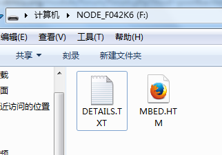

  • STMCU社区下载stlink的驱动并安装。安装成功之后,打开Nucleo的盘符,可以找到MBED.HTM文件。使用浏览器打开该文件。

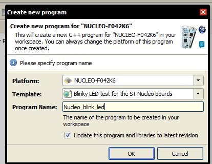

  • 之后create a new one,创建一个工程。就建一个默认的blink led好了。

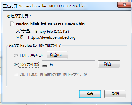

  • 编译成功之后,弹框提示下载。在保存文件选项框中选择Nucleo所在的盘符即可。点击确定之后,就能够看到闪烁的LED啦。
