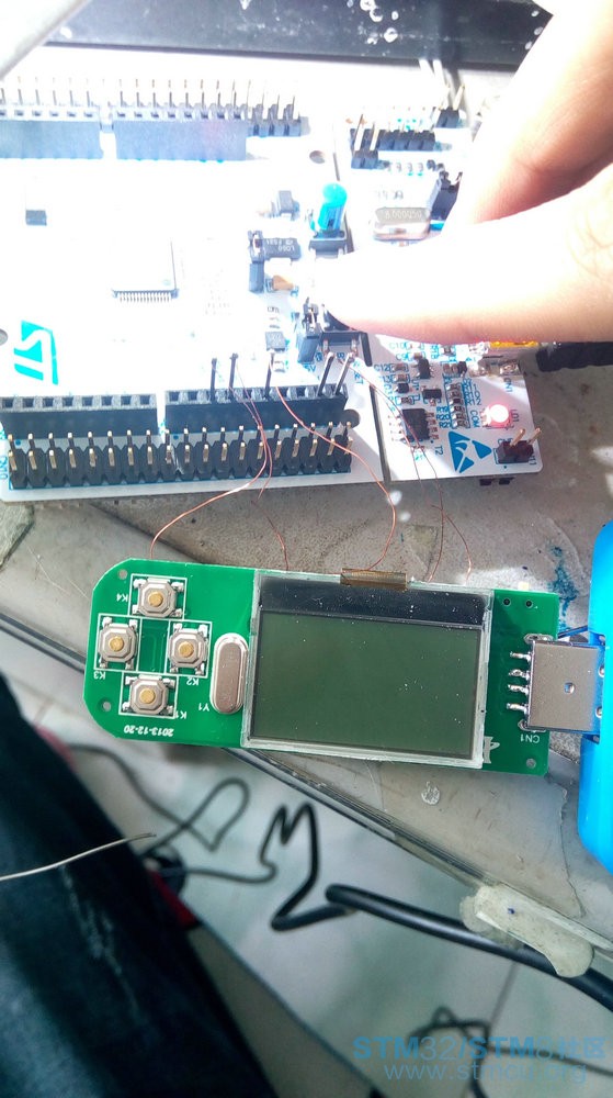

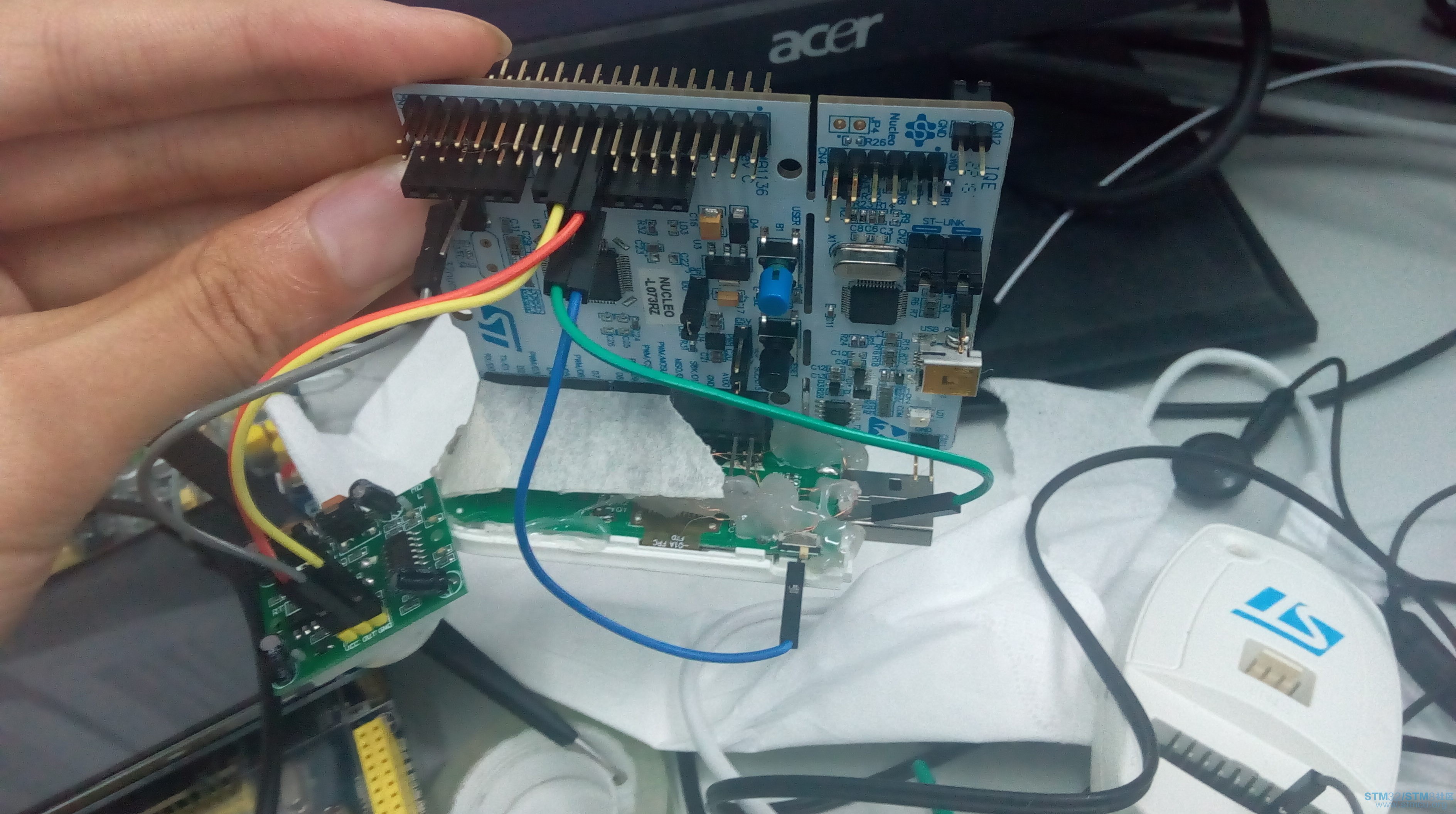

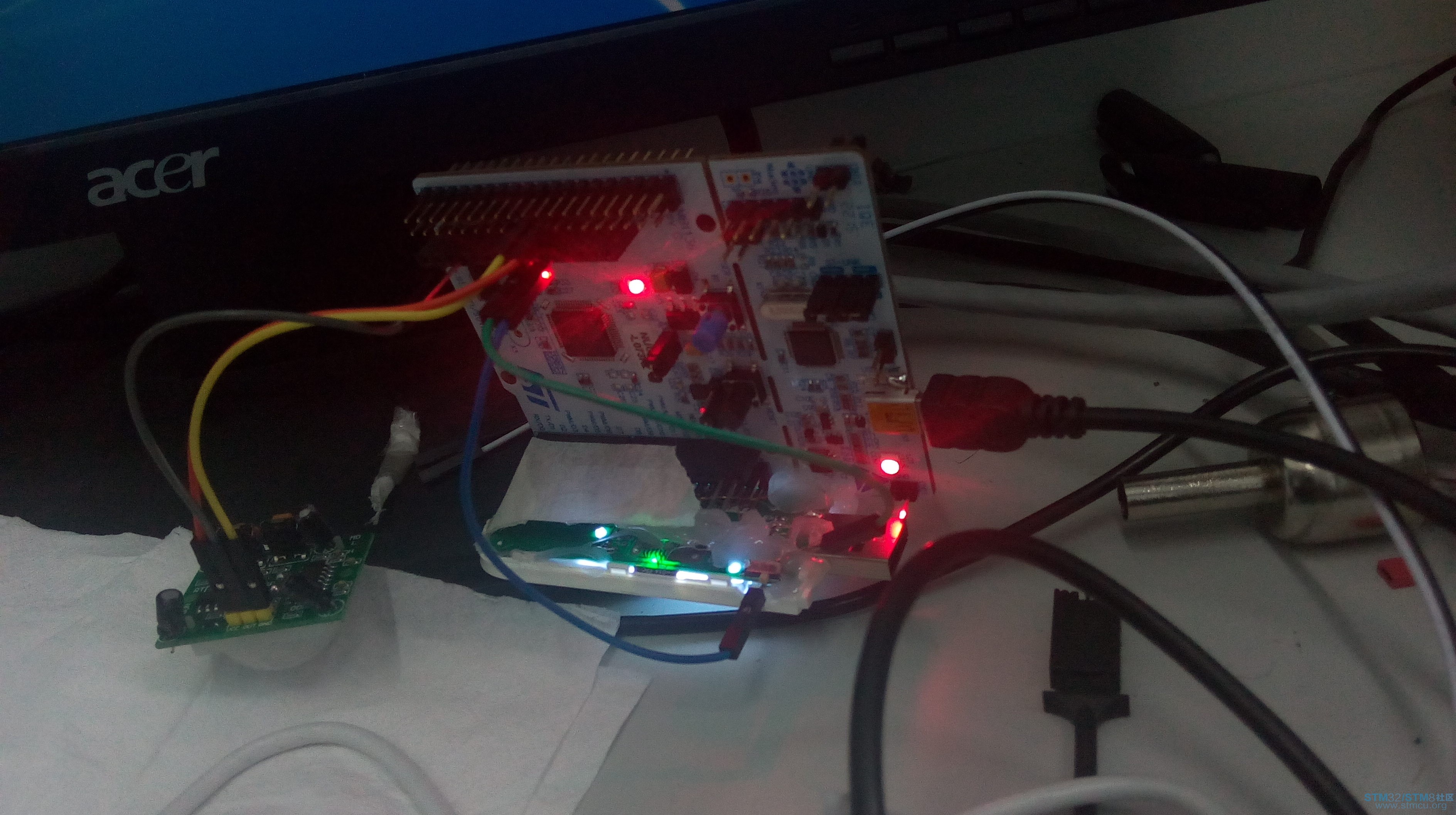

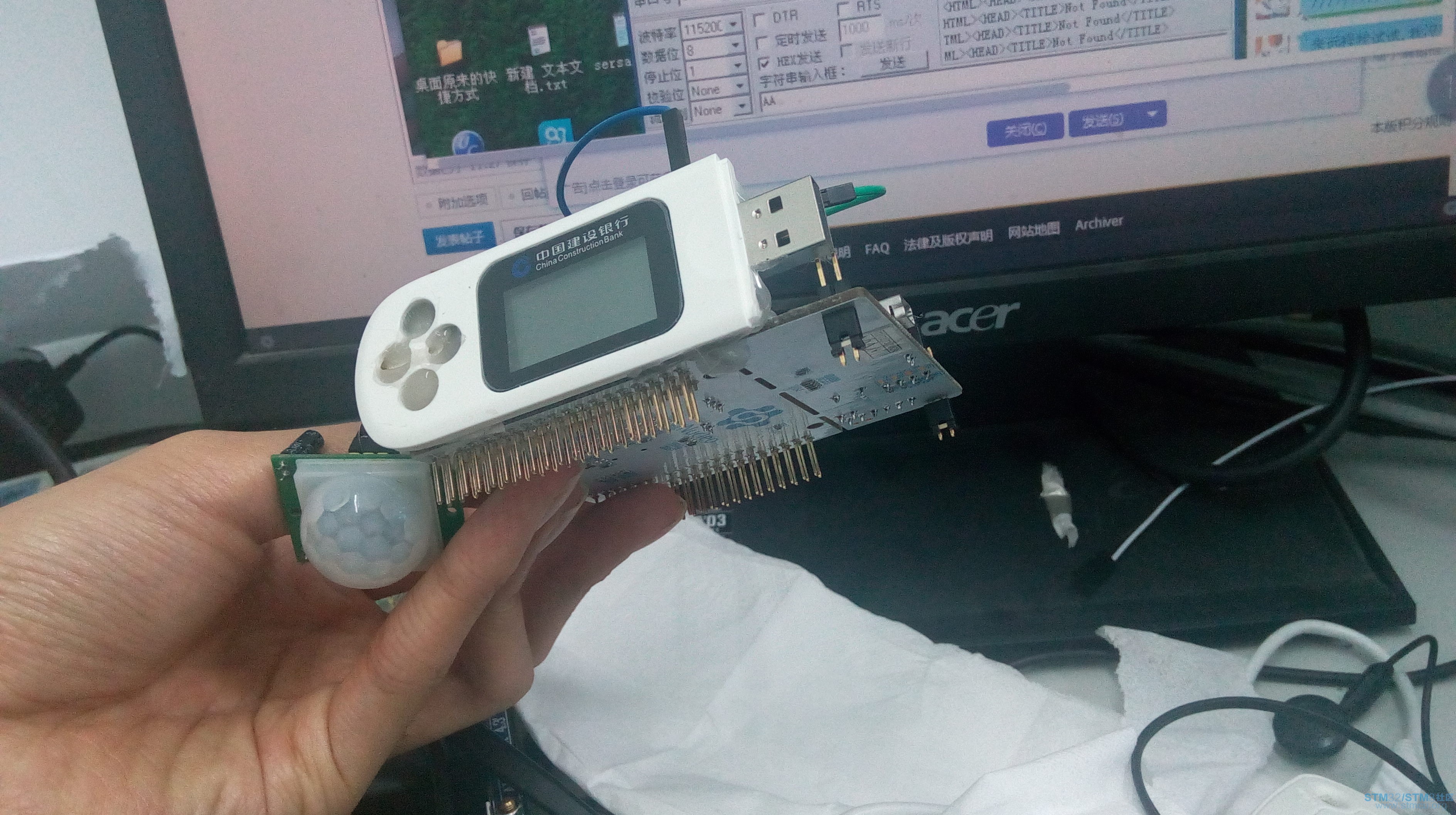

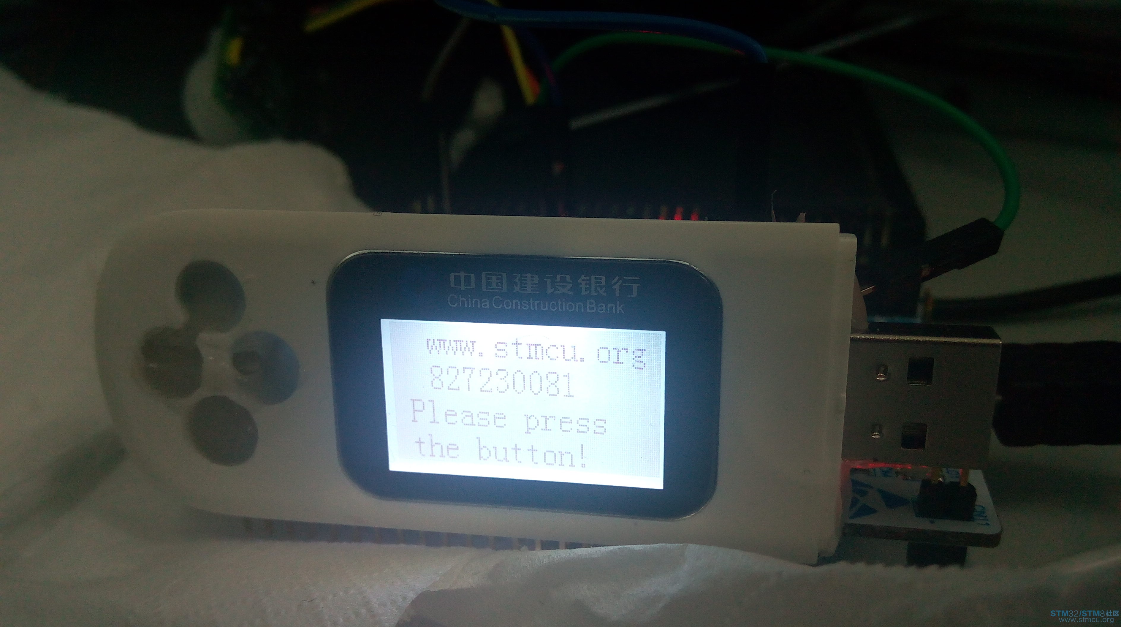

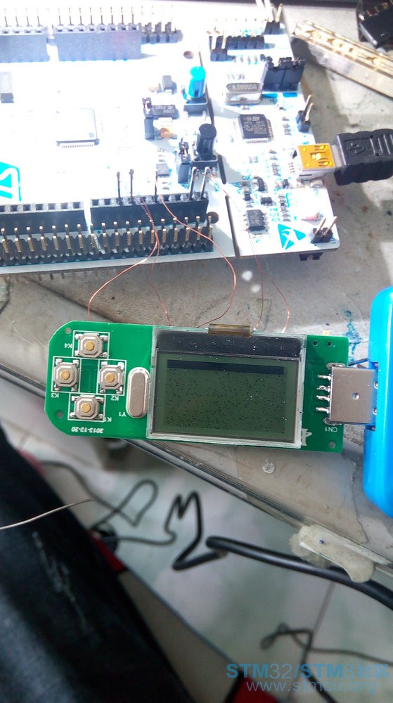

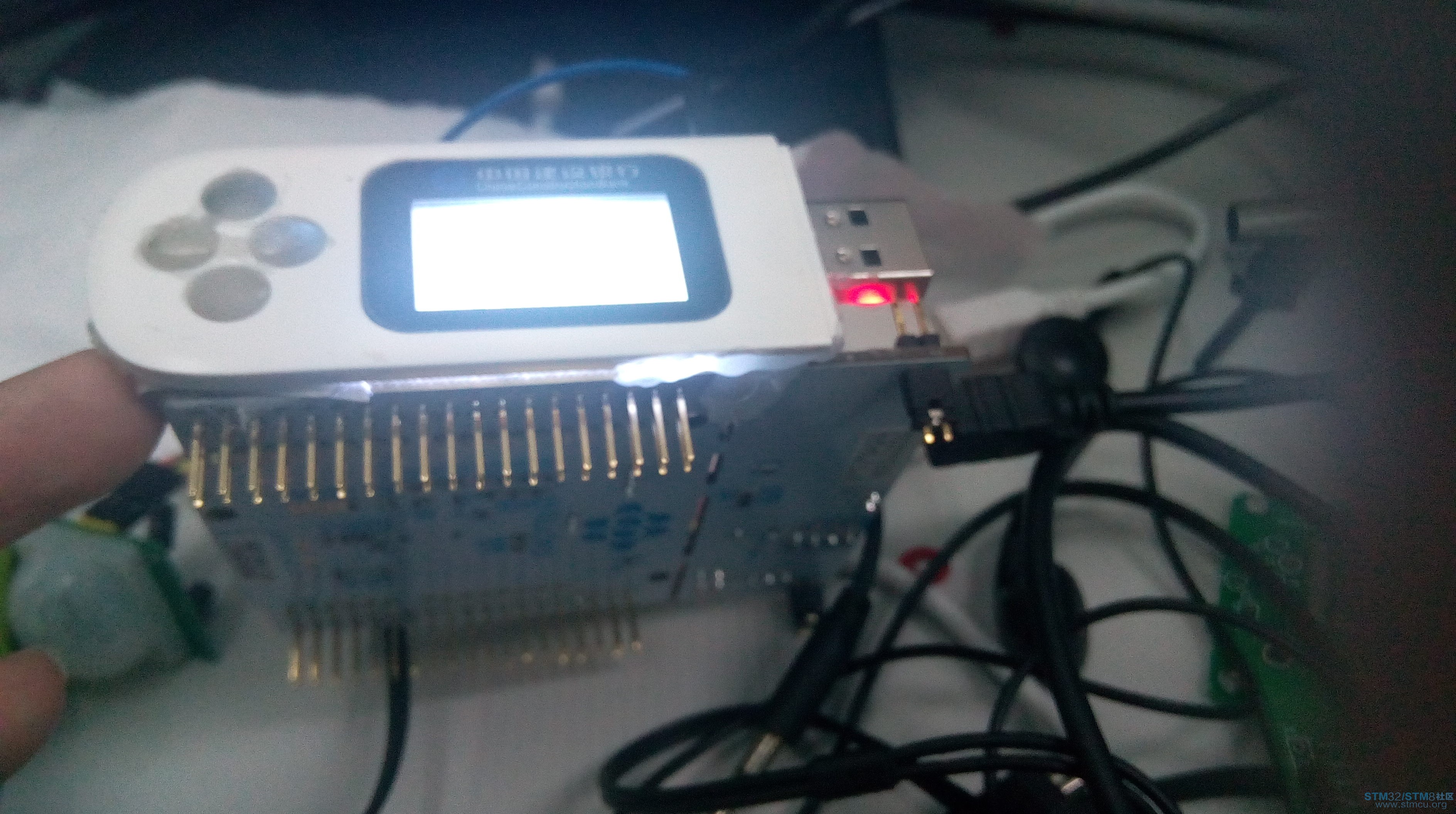

板子到手了,正在使用中,给我的方案加了一块12864(嘿嘿嘿)做为调试输出

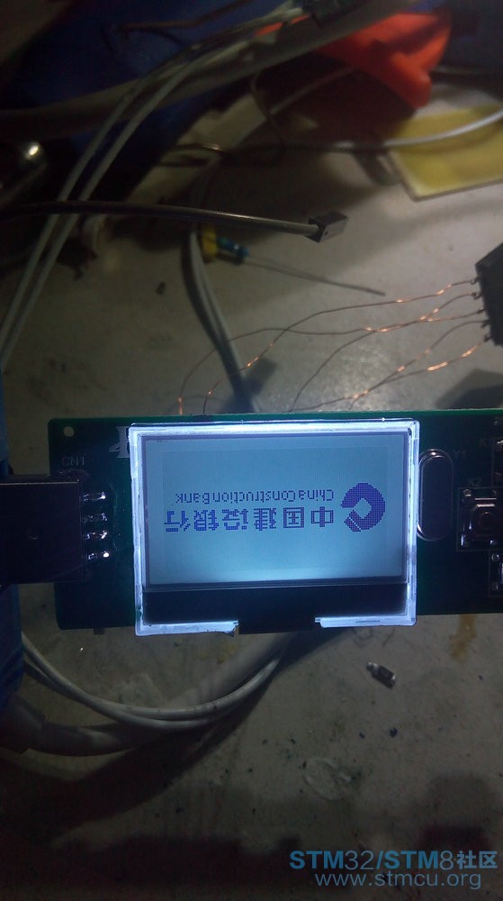

直接用热熔胶粘,建行的网银盾的LCD12864,嘿嘿嘿.
没钱买屏幕只能自己搞了.一块12864也不便宜

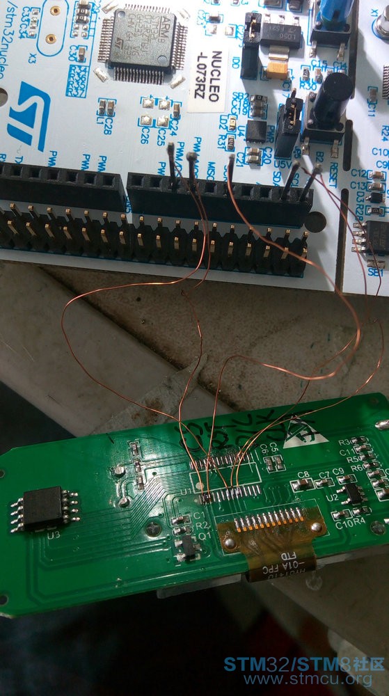

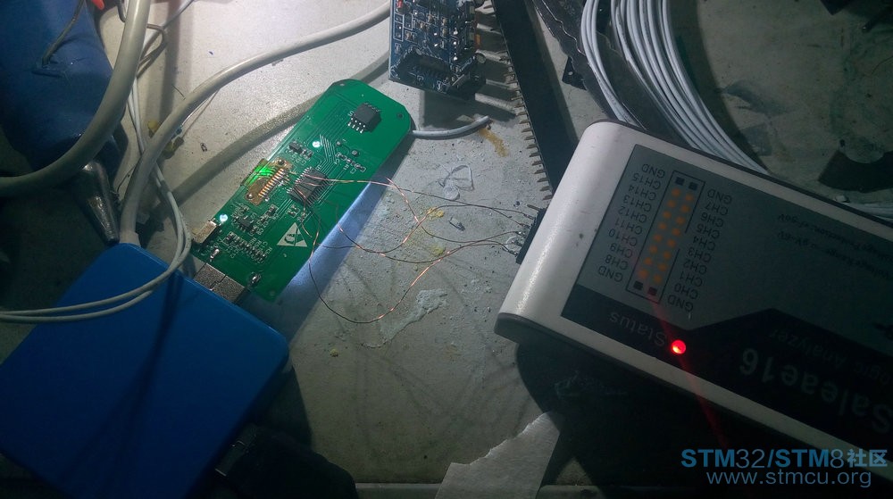

上几张分析引脚的图

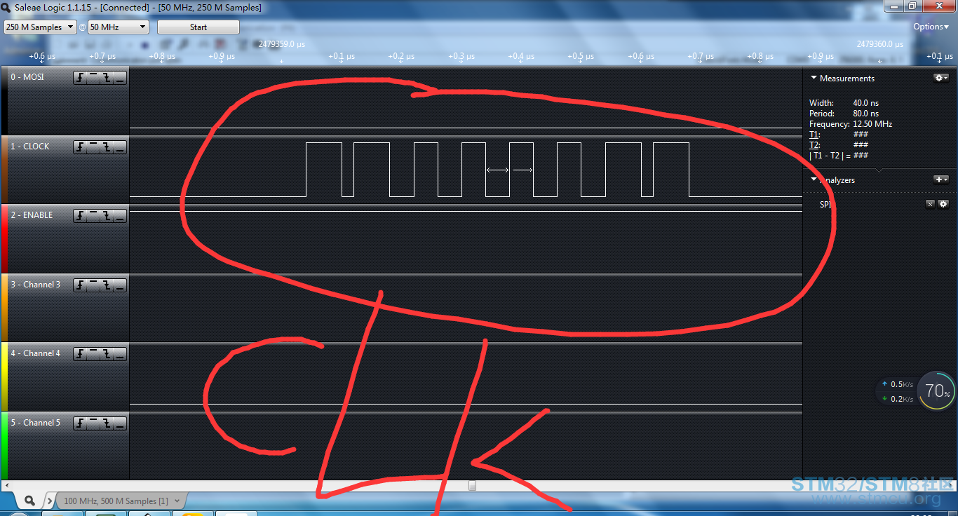

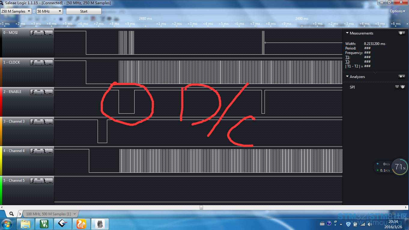

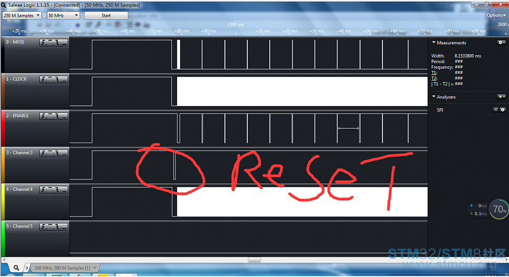

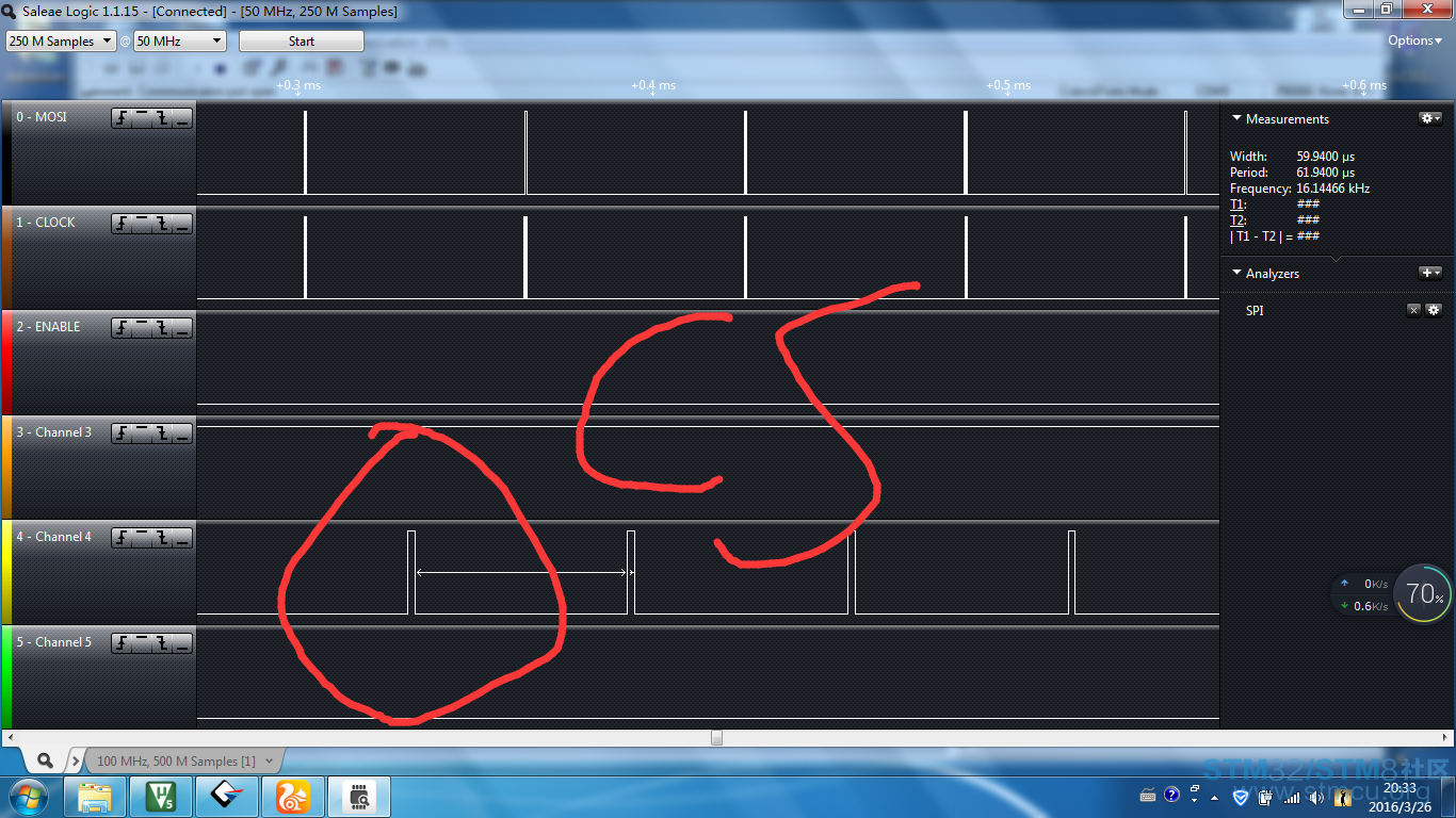

分析仪抓包喽
代码在附件 哈哈

- SpiHandle.Init.FirstBit = SPI_FIRSTBIT_MSB;
- SpiHandle.Init.TIMode = SPI_TIMODE_DISABLE;
- SpiHandle.Init.CRCCalculation = SPI_CRCCALCULATION_DISABLE;
- SpiHandle.Init.CRCPolynomial = 7;
- SpiHandle.Init.NSS = SPI_NSS_SOFT;
- SpiHandle.Init.Mode = SPI_MODE_MASTER;
- HAL_SPI_Init(&SpiHandle);
- SPI1->CR1 |=1<<6; //ʹÄÜ
- void SPI_SendByte(char temp)//²»¶à˵
- while(!((SPI1->SR>>1)&0x01));
- SPI1->DR=temp;
- void GPIO_Conf(void)
- GPIO_InitTypeDef GPIO_InitStruct;
- RCC->IOPENR |=1<<1;
- GPIO_InitStruct.Mode =GPIO_MODE_OUTPUT_PP;
- GPIO_InitStruct.Pull =GPIO_PULLUP;
- GPIO_InitStruct.Speed =GPIO_SPEED_FREQ_HIGH;
- GPIO_InitStruct.Pin =GPIO_PIN_8|GPIO_PIN_9|GPIO_PIN_6; //GPIO RST D/C CS
- HAL_GPIO_Init(GPIOB,&GPIO_InitStruct);
- void LCD_Conf(void)
- RST_H;
- CS_H;
- DC_H;
- HAL_Delay(50);
- RST_L;
- HAL_Delay(5);
- RST_H;
- HAL_Delay(5);
- CS_L;
- LCD_CMD(CMD);
- HAL_Delay(2);
- LCD_Clear(0xFF);
- HAL_Delay(2);
- LCD_Clear(0);
- //LCD_SetPoint(LINE1 ,0);
- //LCD_Display(LINE1,10,'1');
- void LCD_SetPoint(unsigned char line,unsigned char row)
- unsigned char tmp=0;
- DC_L;
- DELAY
- SPI_SendByte(line); //ÐÐ0xB0
- tmp=0x10+ ((row&0xF0)>>4);//
- SPI_SendByte(tmp);
- tmp=0x04+ (row&0x0F);
- DELAY
- DC_H;
- void LCD_DAT(char list,char num)
- unsigned char i=0;
- DC_H;
- for(i=num;i<(num+8);i++)
- SPI_SendByte((char )String[list][i]);
- void LCD_Clear(char dat)
- unsigned char i=0,dummy=0;
- // LCD_SetPoint(LINE1,0);
- DC_H;
- DELAY
- for(dummy=0;dummy<8;dummy++)
- DC_L;
- DELAY
- SPI_SendByte(dummy+0xB0);
- SPI_SendByte(0x10);
- SPI_SendByte(0x04);
- HAL_Delay(1);
- DC_H;
- for(i=0;i<128;i++)
- SPI_SendByte(dat);
- // HAL_Delay(10);
- void LCD_CMD(const char * temp)
- int dummy=0;
- DC_L;
- for(i=0;i<13;i++)
- SPI_SendByte(temp[i]);
- dummy=0x3FF;
- while(dummy--);
- DC_H;
- void LCD_Str(unsigned char line,unsigned char row,const char* p)
- char i=0;
- i=row;
- while(*p!='\0')
- i+=8;
- LCD_Display(line,i,*p);
- p++;
- void LCD_Display(unsigned char line,unsigned char row,char temp)
- if((temp-0x20)<0)
- return ;
- LCD_SetPoint(line,row);
- DC_H;
- for(i=0;i<8;i++)
- SPI_SendByte(String[temp-0x20][i]);
- LCD_SetPoint(line+1,row);
- DC_H;
- for(i=8;i<16;i++)
