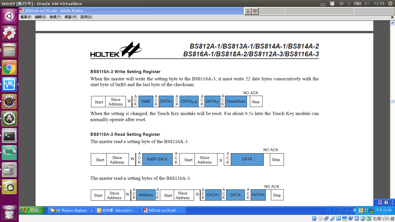

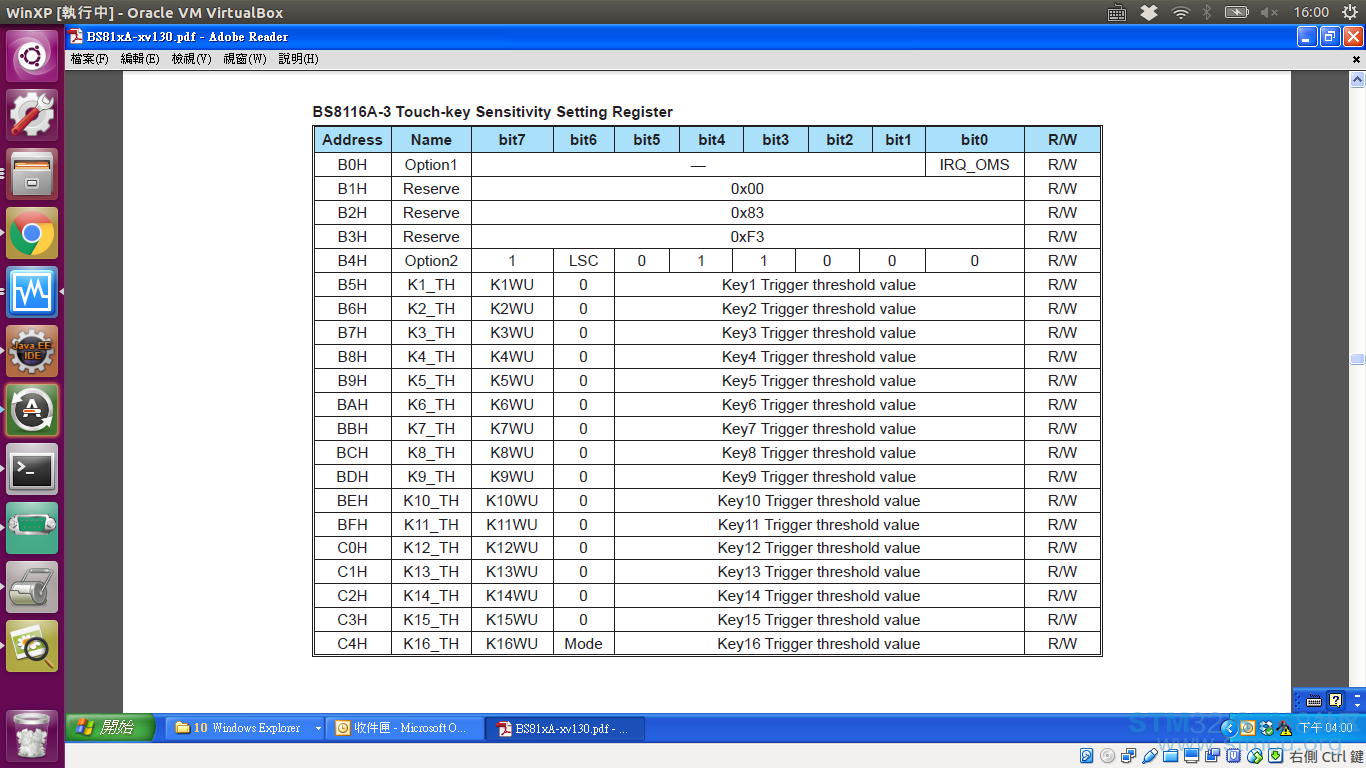

Master :STM32F030C8T6 slave :BS8116A-3 透过I2C传输
阿毛阿毛 提问时间:2016-3-28 16:10 /
请教各位前辈 小弟在做BS8116A-3 initial时卡在下面(红色)这一行就不会往下跑了,很苦脑..
/*   BS8116A-3 write setting Register        */
        I2C_TransferHandling(I2C1, 0x50, 22, I2C_Reload_Mode,I2C_Generate_Start_Read);
        (ochar('a'));
        I2C_SendData(I2C1, 0xB0);
        (ochar('g'));
        while(I2C_GetFlagStatus(I2C1, I2C_FLAG_ADDR)==RESET );
        (ochar('b'));
        I2C_SendData(I2C1, 0x00);          //Option1
        (ochar('c'));
        while(I2C_GetFlagStatus(I2C1, I2C_FLAG_TXE)==RESET );
        (ochar('d'));
        I2C_SendData(I2C1, 0x00);          //Reserve
        (ochar('e'));
        while(I2C_GetFlagStatus(I2C1, I2C_FLAG_TXIS) ==RESET);
        (ochar('f'));
        I2C_SendData(I2C1, 0x83);          //Reserve
        while(I2C_GetFlagStatus(I2C1, I2C_FLAG_TXIS)==RESET );
        I2C_SendData(I2C1, 0xF3);          //Reserve
        I2C_SendData(I2C1, 0x98);          //Option2
        I2C_SendData(I2C1, 0x08);          //K1_TH
        I2C_SendData(I2C1, 0x08);           //K2_TH
        I2C_SendData(I2C1, 0x08);           //K3_TH
        I2C_SendData(I2C1, 0x08);           //K4_TH
        I2C_SendData(I2C1, 0x08);           //K5_TH
        I2C_SendData(I2C1, 0x08);           //K6_TH
        I2C_SendData(I2C1, 0x08);           //K7_TH
        I2C_SendData(I2C1, 0x08);           //K8_TH
        I2C_SendData(I2C1, 0x08);           //K9_TH
        I2C_SendData(I2C1, 0x08);           //K10_TH
        I2C_SendData(I2C1, 0x08);           //K11_TH
        I2C_SendData(I2C1, 0x08);           //K12_TH
        I2C_SendData(I2C1, 0x08);           //K13_TH
        I2C_SendData(I2C1, 0x08);           //K14_TH
        I2C_SendData(I2C1, 0x08);           //K15_TH
        I2C_SendData(I2C1, 0x08);           //K16_TH
        I2C_SendData(I2C1, 0xEE);         //checksum  (get low byte)
        (ochar('z'));
        (ochar('a'));
        (ochar('g'));
        (ochar('b'));
        (ochar('c'));
        (ochar('d'));
        (ochar('e'));
        (ochar('f'));
