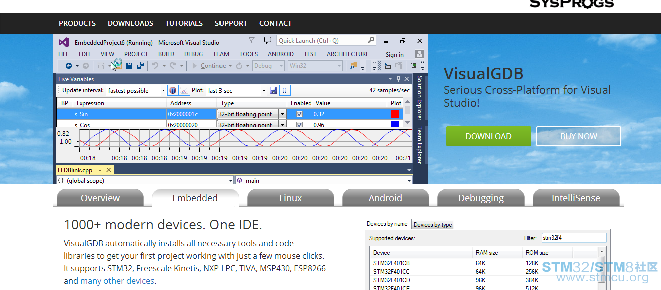

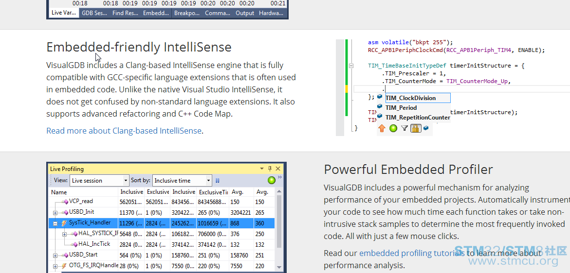

3 x4 G! L8 P& @4 J$ K1 @分享一神器给大家,使用Visual Studio+VisualGDB开发ARM,告别keil,用过visual stdio的都知道,不管是项目管理功能还是智能代码提示都秒杀keil,今天分享给大家的名叫VisualGDB的插件正好解决了这个需求。先来句官网(http://visualgdb.com/?features=embedded)的介绍:$ @2 b2 P+ a  P% c/ w
1000+ modern devices. One IDE.
VisualGDB automatically installs all necessary tools and code libraries to get your first project working with just a few mouse clicks. It supports STM32, Freescale Kinetis, NXP LPC, TIVA, MSP430, ESP8266 and many other devices.
Simply select your device in the wizard, connect the debug probe and you can start stepping through your first project.
支持STM32,飞思卡尔Kinetis,NXP LPC,MSP430等微控制器开发。
来个截图吧:
功能强大,最重要的是支持STM32CubeMX图形化配置工具,支持STM32最新的HAL库和传统3.5库,STlink等调试工具,例程丰富。英语不好的童鞋借着在线翻译也能轻松上手,例程很多。
