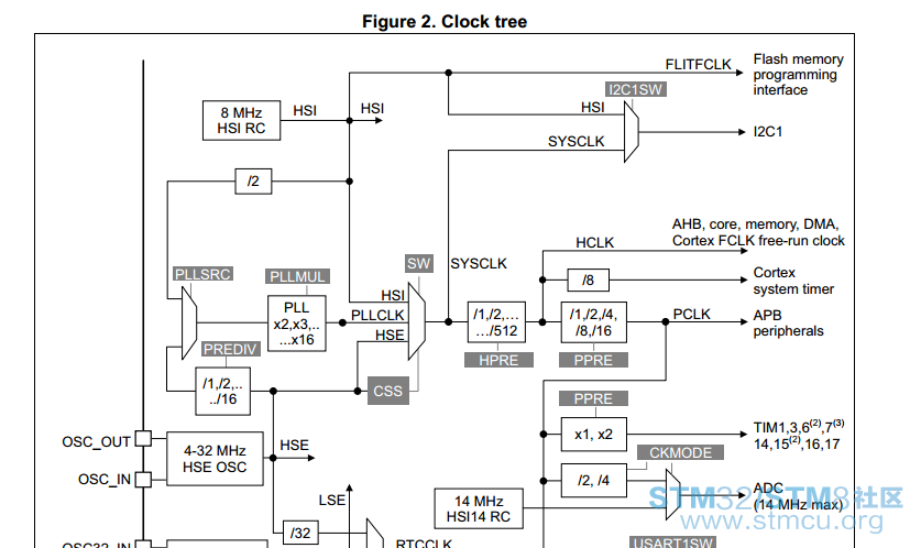

STM32F030C8T6单片机外接晶振16M程序改如何改
钱钱钱钱 提问时间:2017-4-20 15:50 /
首先我将STM32F0xx.h中做以下更改:
#if !defined  (HSE_VALUE)
#define HSE_VALUE    ((uint32_t)16000000) /*!< Value of the External oscillator in Hz*/
#endif /* HSE_VALUE */
其次 SystemInit ()中SetSysClock()如下:
static void SetSysClock(void)
  __IO uint32_t StartUpCounter = 0, HSEStatus = 0;
/*            PLL (clocked by HSE) used as System clock source                */
  /* SYSCLK, HCLK, PCLK configuration ----------------------------------------*/
  /* Enable HSE */
  RCC->CR |= ((uint32_t)RCC_CR_HSEON);
  /* Wait till HSE is ready and if Time out is reached exit */
  do
    HSEStatus = RCC->CR & RCC_CR_HSERDY;
    StartUpCounter++;
  } while((HSEStatus == 0) && (StartUpCounter != HSE_STARTUP_TIMEOUT));
  if ((RCC->CR & RCC_CR_HSERDY) != RESET)
    HSEStatus = (uint32_t)0x01;
  else
    HSEStatus = (uint32_t)0x00;
  if (HSEStatus == (uint32_t)0x01)
    /* Enable Prefetch Buffer and set Flash Latency */
    FLASH->ACR = FLASH_ACR_PRFTBE | FLASH_ACR_LATENCY;
    /* HCLK = SYSCLK */
    RCC->CFGR |= (uint32_t)RCC_CFGR_HPRE_DIV1;
    /* PCLK = HCLK */
    RCC->CFGR |= (uint32_t)RCC_CFGR_PPRE_DIV1;
    /* PLL configuration */
    RCC->CFGR &= (uint32_t)((uint32_t)~(RCC_CFGR_PLLSRC | RCC_CFGR_PLLXTPRE | RCC_CFGR_PLLMULL));
    RCC->CFGR |= (uint32_t)(RCC_CFGR_PLLSRC_PREDIV1 | RCC_CFGR_PLLXTPRE_PREDIV1 | RCC_CFGR_PLLMULL6);
    /* Enable PLL */
    RCC->CR |= RCC_CR_PLLON;
    /* Wait till PLL is ready */
    while((RCC->CR & RCC_CR_PLLRDY) == 0)
    /* Select PLL as system clock source */
    RCC->CFGR &= (uint32_t)((uint32_t)~(RCC_CFGR_SW));
    RCC->CFGR |= (uint32_t)RCC_CFGR_SW_PLL;
    /* Wait till PLL is used as system clock source */
    while ((RCC->CFGR & (uint32_t)RCC_CFGR_SWS) != (uint32_t)RCC_CFGR_SWS_PLL)
  else
  { /* If HSE fails to start-up, the application will have wrong clock
         configuration. User can add here some code to deal with this error */
该如何更改?
PREDIV 是不是可以分频呢?
PREDIV  是不是可以分频呢?
