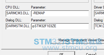

仿真时无法启动,停在启动文件的加黑的那行,LDR     R0, =SystemInit
Reset_Handler   PROC
                EXPORT  Reset_Handler             [WEAK]
                IMPORT  __main
                IMPORT  SystemInit
                LDR     R0, =SystemInit
                BLX     R0
                LDR     R0, =__main
                BX      R0
                ENDP
请各位大神帮忙解决一下,谢谢
