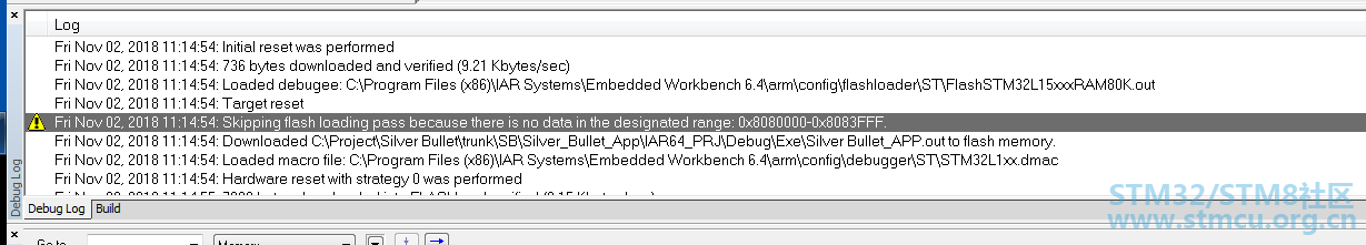

IAR下载STM32L152VE的芯片,出现如下报错
sky_han 发布时间:2018-11-2 14:57
Fri Nov 02, 2018 10:31:44: Skipping flash loading pass because there is no data in the designated range: 0x8080000-0x8083FFF. , x1 S- |, I3 |% i: P
6 t0 Y5 M% c* K
该怎么解决?

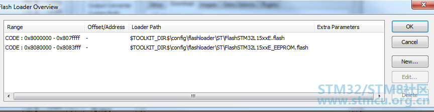

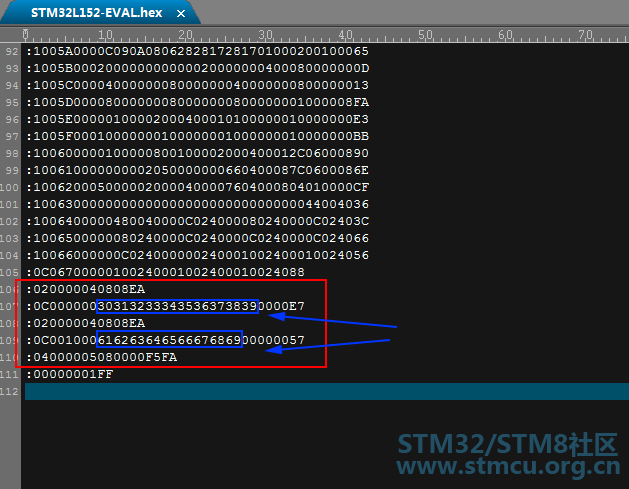

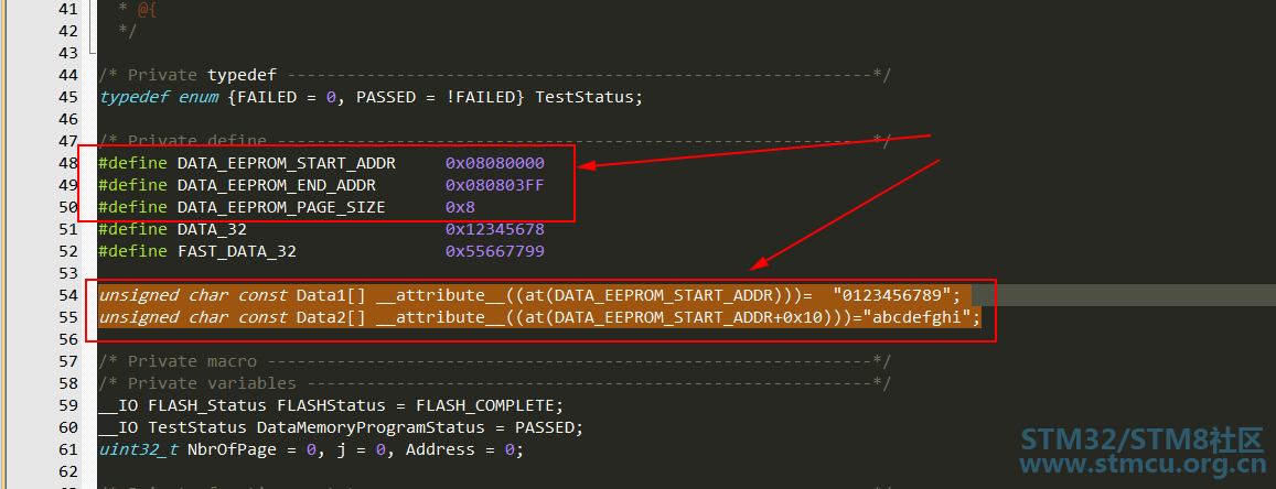

20181102162139.png 4 r; C7 b- N& @2 e4 @: u7 Q
& u, O" S6 K' n0 m( U0 l 20181102162232.png 9 h) u. D3 N7 l
, U# B% O3 j% N9 @
$ J" \. @3 q! T4 v# I, l2 l$ `$ W1 _1 r$ C; f
$ x6 g+ W$ f* x! p; _
